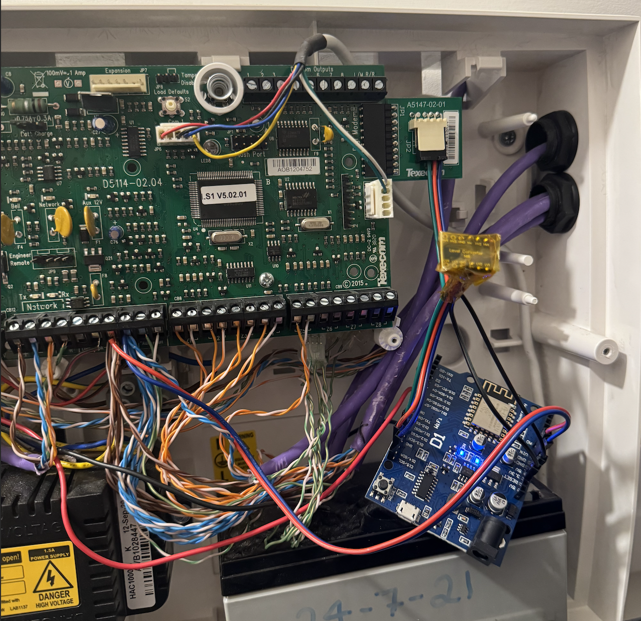

Just want to test my logic as I’m going to give it a go on the ESP8266 just to be sure if ESPhome was causing the problem. I’m a little lost on the hardware side of things. The ESP8266 runs at 3.3v already, so when I use the 12v DCDC power converter to 5v am I connecting this directly to the esp8266 VIN pin or 3.3v pin?
From that I connect one of the GPIO pins to the low level converter Low voltage side (3.3v) then to high voltage side (5v) go to the Texecom board?
I think my confusion is the esp converting the 5v dc input

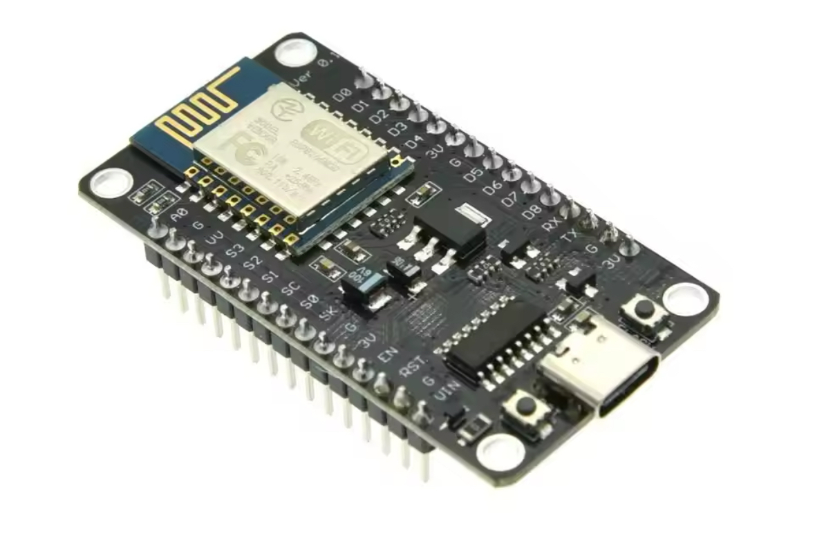

Post a picture of the ESP8266 module you are going to use...
Are you going to use an ESP8266 stand alone board or one of the Wemos D1 boards because the Wemos boards have a 12v regulator built in and would be perfect... if only mine would work!
I found that the modules I had were 3.3v & 5v tolerant on the TXD/RXD lines but this is not stated on the spec sheet and there are many arguments for and against online.
Basic ESP8266, happy to buy a D1 instead though. Just fancy a challenge now I know the pi works

The D1 is easier because you can supply it directly with 12v and there is no need for the DCDC convertor, you can then play around with the IO pins with Dupont cables and it is easier when testing etc.
I cannot see a reason why the ESP8266 modules would not work and they are probably a more robust and easier solution if you can get them to talk to the panel. I'll dig mine out and play around with them again when I get a chance.

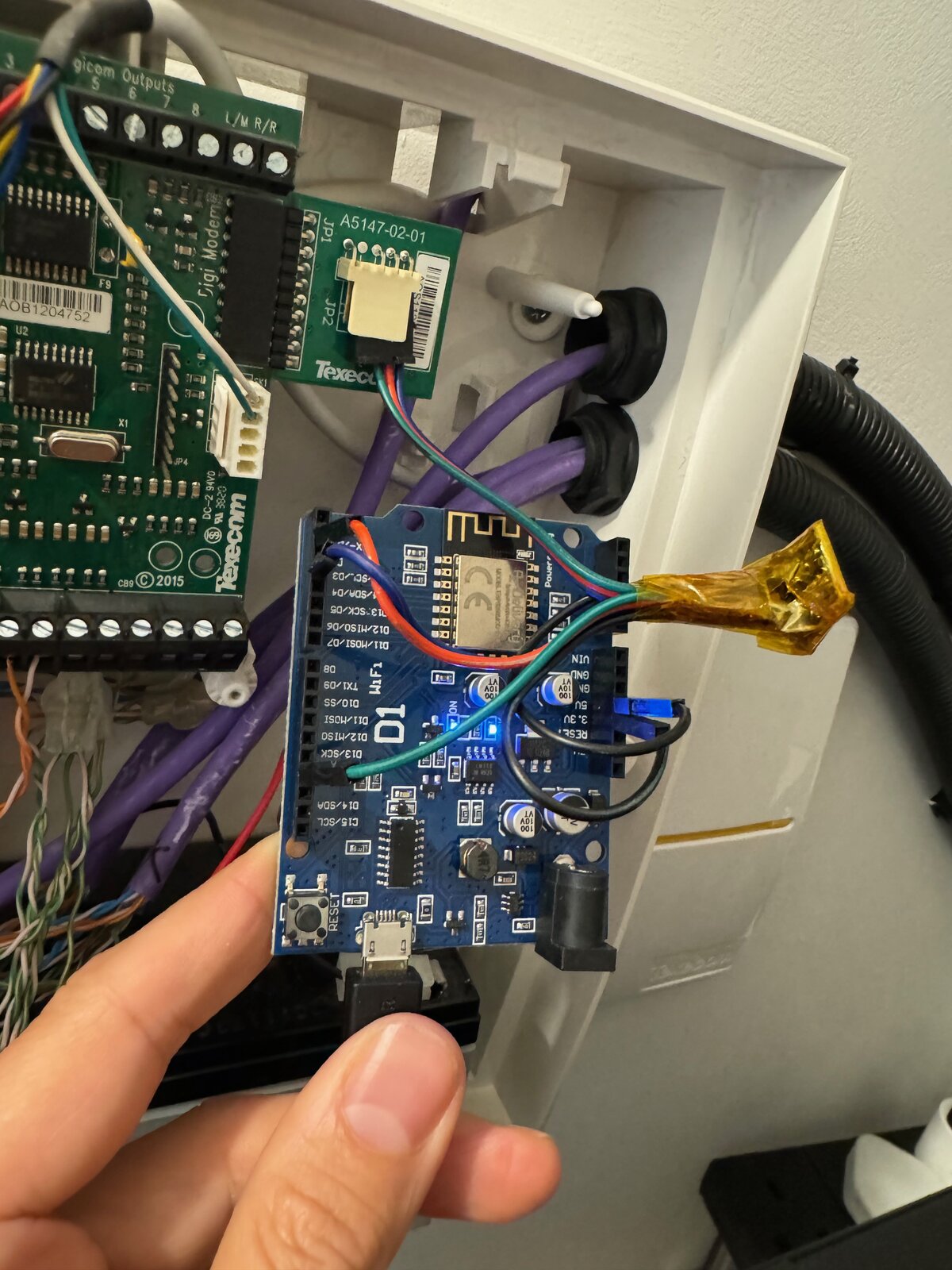

Sorry for the the stupid questions as i re-read your first page on the thread I’m at a loss why you needed the level converter or the resistors (as per your bottom picture on page 1). I assume you used the level converter was just for 'safety' when connecting from the D1 to the texecom as the comports are expecting 5v logic levels?
Ive found a d1 with ESP32 here or a ESP8266 here, price difference is negligible any suggestions?
i can keep my bare esp8266 as i use them for other stuff.
Yes, the level convertor was for safety/compatibility. I was struggling to get the panel and the board talking so I wanted to rule incorrect IO levels out. It did not make a difference in my case but I would include it to begin with until you have everything working.
The resistors that I piggy backed on to the D1 are actually a 47K resistor and a 5.1V Zener diode (which copied the circuit on the JAL-0001) and meant that I could then connect directly to the Digi Modem port on the panel (where the JAL-0001 plugs in to) and did not need a JAL-0001 at all, you simply connected to the 12v/GND/TXD/RXD pins on the Digi Modem port. You do not need to worry about this part if you are connecting to a JAL-0001.
I think the ESP8266 is better supported but they are very similar - may be worth grabbing both to play with.

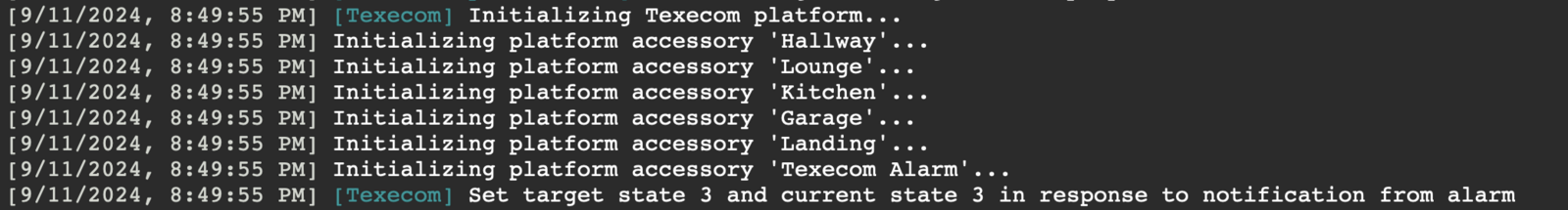

so I have compiled and got it installed, changed my wintex config to call up the new port from stream server, it BRIEFLY connects and shows in homebridge with the accessories then crashes :( (way over my head)

Are you sure you have the TXD/RXD pins correct?
The config states:
tx_pin: GPIO1
rx_pin: GPIO3
Which corresponds to the (D1)TXD & (D0)RXD pins on this board but it looks like you have them plugged in to SCL & SDA pins.
you are correct
Can you tell this is my first time
Sadly I did fry the ESP board with the 12v (connecting and reconnecting) so got another coming tomorrow. Still powers on via usb though.
