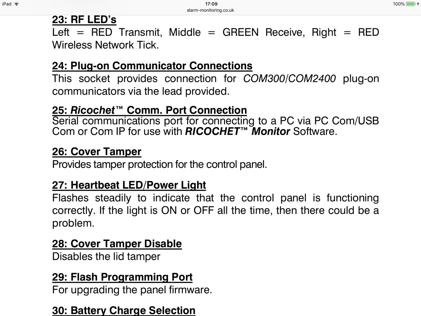

What about the control panel's flashing green light? Is that normal?
No 27
