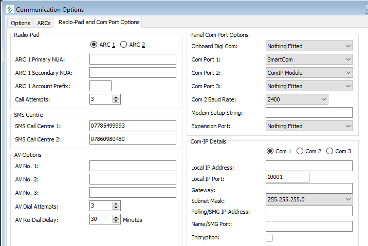

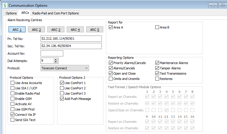

Alarm has been all working fine for the past couple of weeks now. I want to get the texecom connect working properly.
Its added to the system and from the phone app I can connect to it. Last week I was seeing in the calendar when I set/disarmed etc.
I wanted to get the notications working as I do not get anything on my phone even if the alarm has been triggered.
I connected via wintex and made some changes I found on another thread and while I was connected to the panel I started to get notifications. However after those I didn't receive anymore and now the app doesn't register when the system has been armed/disabled etc in the calendar. The app does connect to the system though. Confused.... Any ideas?
Thanks!
difficult to say as don't know what you have done.
so if we roll back, which ports is the smart com connected to and what port is programmed to do the push in program digi?
Below are 2 screenshots from wintex, does this help?
yes that explains it perfectly.
If I told you the com ip sends out the notifications and you have it sending out via the smart com which is wrong.
Can you see your mistake?
Hey, yes perfectly, I changed protocol options to com port 2 and notification are coming through.
Thank you!!
