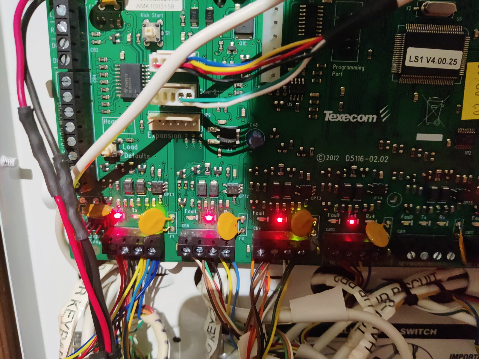

As seen in the picture below there is a red fault light on and the rest of the system configured on network 1 has no power. The orange thing furthest to the left (pardon my lack of understanding) is running extremely hot

Remove devices ( wires from network 1 ) see if clears , it’s either overloaded or you have a faulty item on the network
am I supposed to power down the alarm while doing so? And if so how?
No just remove the wires from the network ..it must be in engineer mode as you are showing a picture with the lid off , I take it you have another keypad on the other network
I guess it’s a 640 panel from the picture

What’s on network 1 how many keypad , expanders , powered devices ….eg pirs speakers and bellboxs ( powered from any expander )
I disconnected the wires and the fault is off. How should I proceed?
Add one set of bus lines at at time ( as you have 3 connected ) will fault if you have a short on one , but it may need all 3 if your overloading it

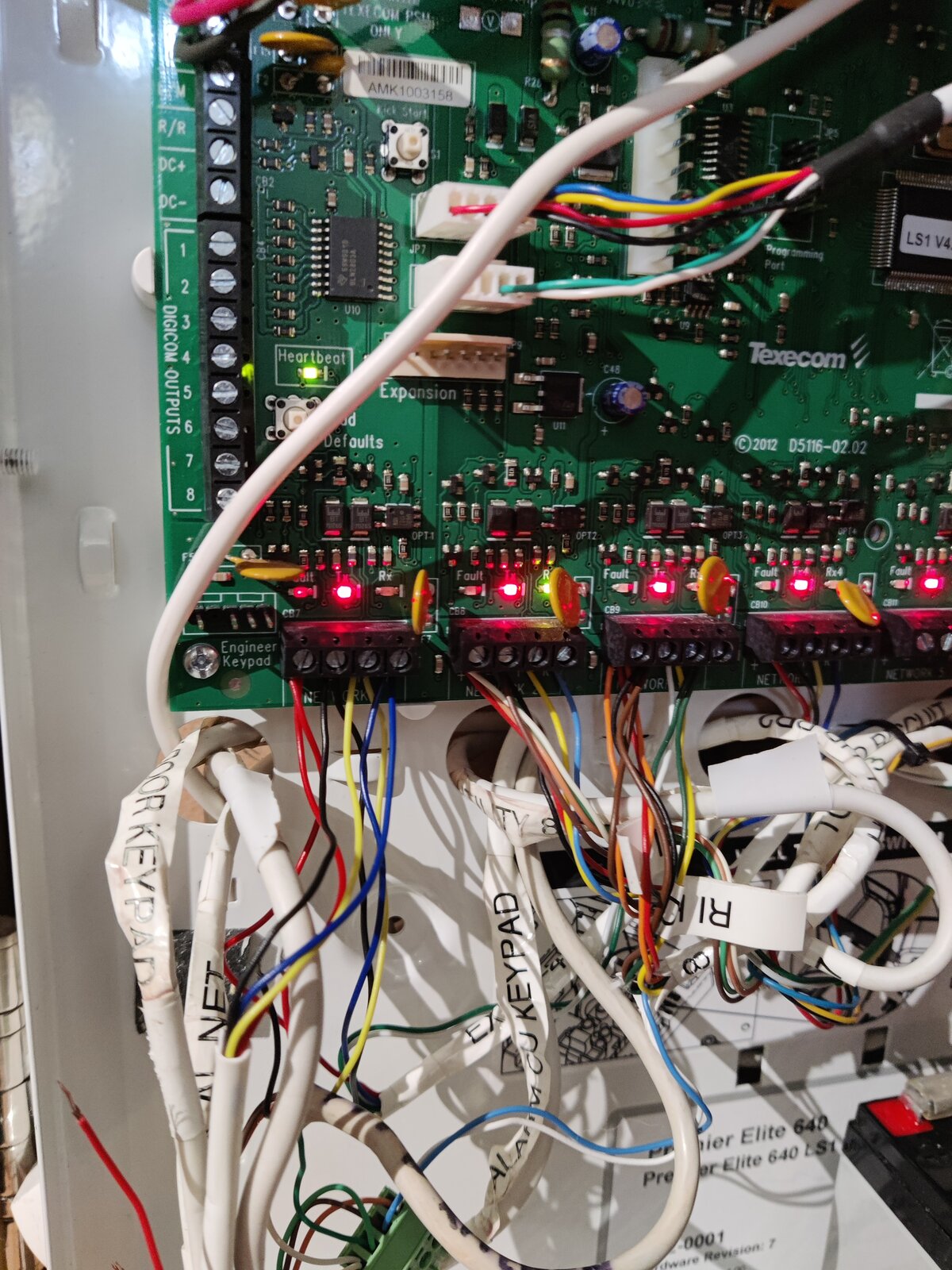

okay I have disconnected them and re connected them indvidual, all work on their own it's only when three are plugged in that I get the fault light.
I believe theres 2 keypads and zone expanders 1-4, but ones of those keypads could also be the network, ist hard to tell with the cabling

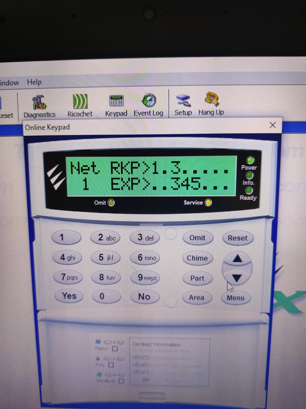

Engineer utilities > confirm devices > network 1
What is displayed in there?
So when I plug in the zone expanders 1-4 and the mystery cable the fault persists. This is the output of the above.
So you have 4 zone expanders 32 zones ? How many used and how many have powered devices …what are they ?
