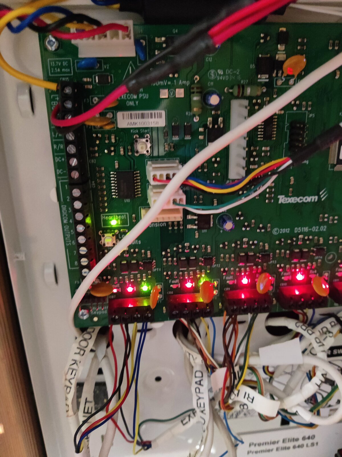

Texecom Premier Elite fault light, no power to key pad

Okay I did that and upon attempting to wire in both sets that contain expanders the fault light was back.
Note I haven't yet confirmed the devices but I don't believe that produces the fault light
Put one set of network cables on another network connector that’s not used ….if it’s ok then it’s overloaded
yeah the fault dissapears upon being moved to another network

So at the moment the system is not in alarm and not in fault, but if you have too much ie a bell box being activated in alarm it can draw a lot of current and cause the network to be in fault again.
if you map all this out we can guide you as to where is likely overloaded if in alarm or not.

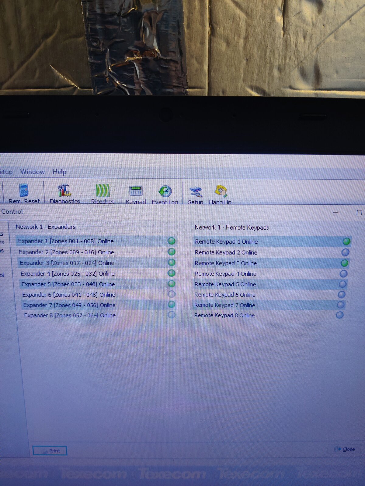

is this doable through the wintex software alone? As I'm already aware whats supposed to be on network 1 --> expanders 1 -7 and keypads 1 -6
Each device has an address based on the dip switches, they are changed physically.
You will need to know what is connected to each expander on each network to program it up via wintex properly.
You cant have what you say on network 1 as you moved a cable to another network to remove the fault status.
network one currently only has expanders 3-6 and the system already has a configuration on wintex for all other networks which are working. So with my current understanding the network 1 is oveloaded when adding the extra expanders right? If so how can I fix that and as for the other item s connected to the system I doubt they draw enough to cause a system overload on network one however I can always check that by running the ring test ect on the alarm.
without knowing what is attached its hard to be certain on how many powered expanders you will need.
consider your limited to 900 mA, haven't checked but glass fuses is 1A so the poly fuses may well be 900mA dont do 640s every day and not looking it up.
so every time you get to 900mA worth of power in day made you will be overloaded, in Alarm condition you could have a bell box and that could draw around half or more than that 900mA so you would need to have a day mode draw of less than 300mA in order to keep the bell from taking above 900mA when in alarm.
if the limit 900mA, then you should aim for a theoretical of 10% less when device is in alarm, this gives you a bit of margin.
Texecom and other manufacturers publish the consumption data of each device so it can be worked out.
for example an Odyssey E bell box uses less power than an Odyssey bell box in alarm, but there are several different modes you can run the bell box and this has different implications. Have aa back light unit and that uses even more power.
door contacts use nothing, but a pir uses more and a dual tech even more, the older the device technology the chances are it uses more power than a newer device.
