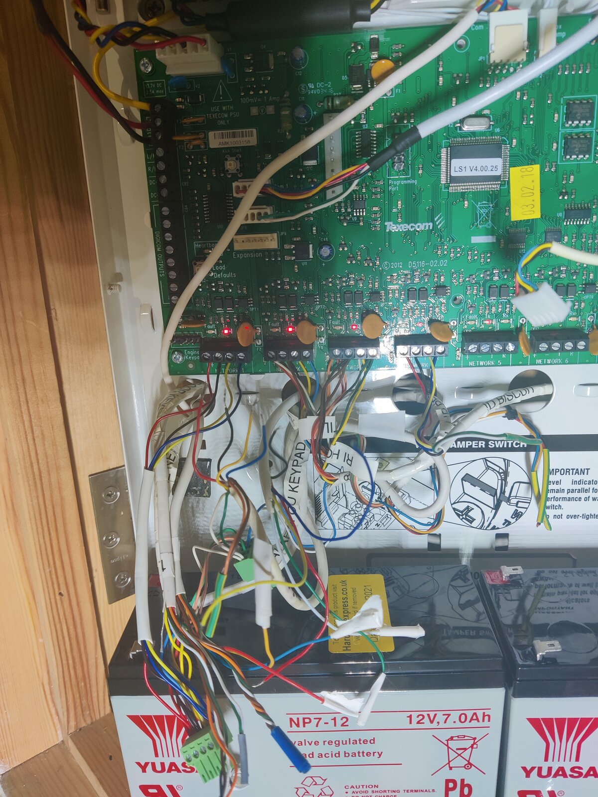

Texecom Premier Elite fault light, no power to key pad
is there anyway to find that without physically following the cables?
I dont have a list where things are and guessing you dont?

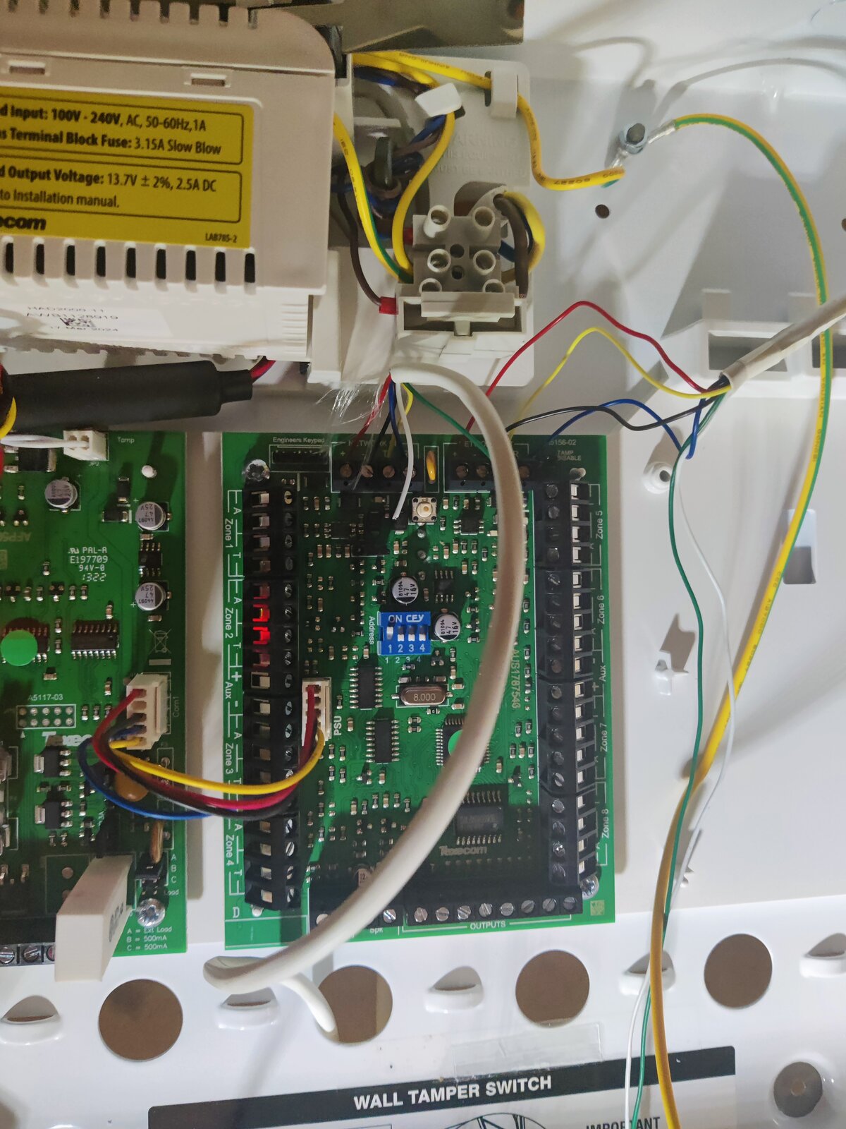

Right so I've discovered that the original PSU has some sort of fault. On the pad it says PSU Mains Fault
Chances the psu switch mode unit black top left has failed.
Lost track of the version numbers but latest units are white rather than black.
You can buy spares from distributors think I may have some older black units new and unused I can send for cost of postage but will have to check tomorrow. If you get a new one make sure it’s white in colour as black maybe new old stock

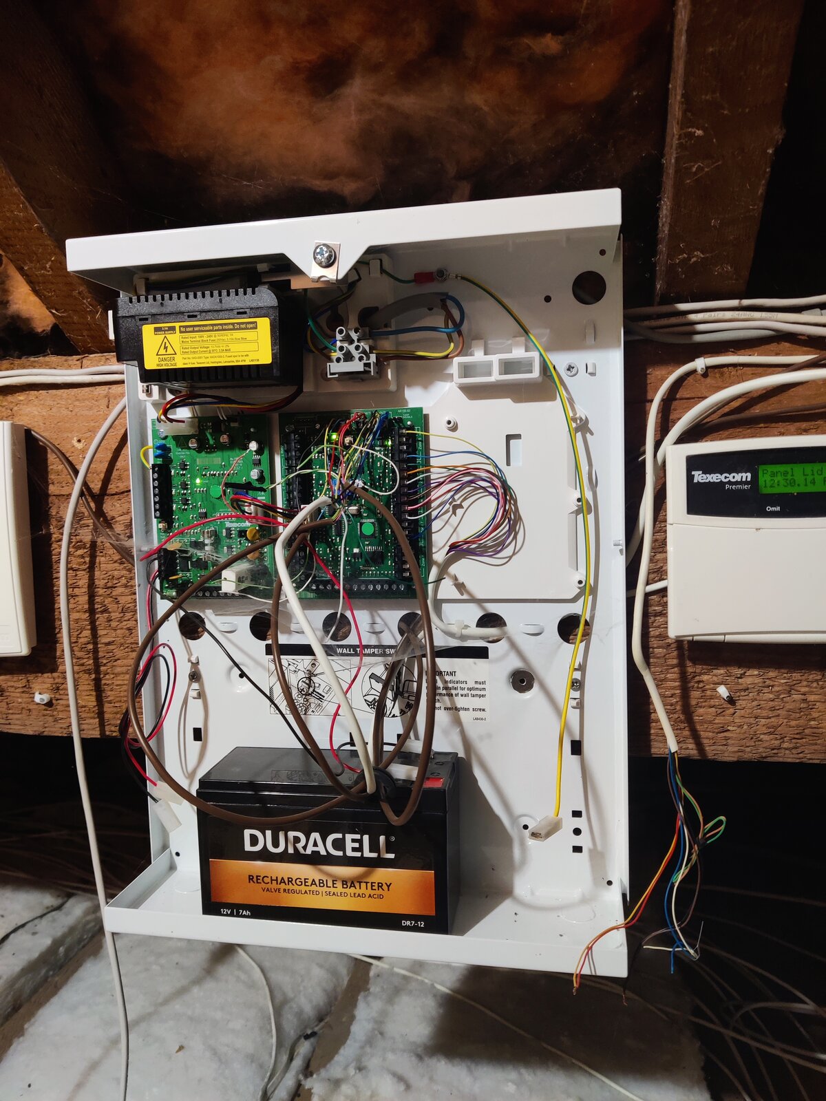

So I've got the extra Powe supply drilled in. To power it I think I need to I need to power down the alarm. Is there anyway to do this without setting the alarm off?
if powering down which is probably a good idea, place panel into engineers mode, any bells place in engineers hold off.
Texecom bells can be done from ell test and press omit, when it says disabled.

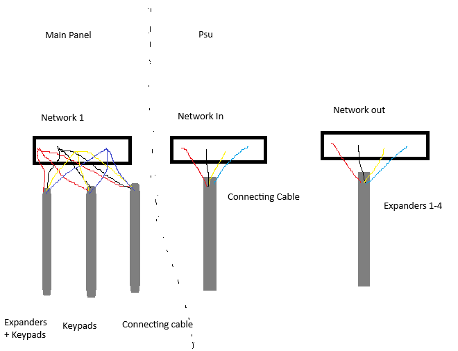

so Ive connected it, how should I wire it to the main panel ?
what is it your trying to achieve exactly?
so from the panel to the powered expanders network in you would have -Ve T and R and no positive as the powered PSU is providing that.
Sorry for the delayed response. I bought xp200 psu and have conencted it to the power when connecting the psu to the main panel I assume I just run a cable from network 1 in the main panel to the network in section of the psu. and then wire out one of the network runs off network out. Having done this is there any adjustments that need to be made to the zones in the wintext software or should it run as if I'd just plugged the set of wires directly into the panel on network one?
powered psu uses fly lead to provide power and coms, so network in would not need positive connection, unless being feed by network out.
picture may be easier to advise on. zone numbers follow addresses of expanders and networks they are on.
so network 1 expander 1 is zone 9 on all panels except 640 where it would be zone 1.
Also If the psu just adds power to the network could I just wire all four wires into network 1 given the additional power its providing
