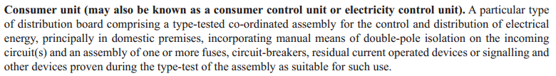

“electrical safety standards” means the standards for electrical installations in the eighteenth edition of the Wiring Regulations, published by the Institution of Engineering and Technology and the British Standards Institution as BS 7671: 2018(3);"
Indeed - that's the definition I was talking about.
What things "IN" BS7671:2018" are to be regarded as constituting "electrical safety standards". As I recently observed, one of the earliest things written "IN" BS7671:2018 is :
BS7671 said:
Existing installations that have been installed in accordance with earlier editions of the Regulations may not comply with this edition in every respect. This does not necessarily mean that they are unsafe for continued use or require upgrading.
BS7671:2018 itself does not seem to feel that non-compliance with its current requirements necessarily constitutes any safety issue.
Isn't it the other way round?
"Electrical safety standards" (in the new law) means the contents of BS7671.
Isn't it the other way round? "Electrical safety standards" (in the new law) means the contents of BS7671.
That's obviously how many people (particularly those looking for electrical work!) are interpreting it - but I have been trying to point out that it's not necessarily as simple/clear as that.
In particular, some (again, including those wanting to generate work for themselves) are interpreting it as meaning that there is a requirement for rental accommodation to comply with all the specific requirements of the current edition of BS7671 (i.e. as if it were a 'new build'). However, as I recently wrote "the contents of BS7671" includes a statement that things not explicitly compliant with the current edition (but compliant with earlier ones) are not necessarily unsafe - so "electric safety standards" are not necessarily violated by things not explicitly compliant with BS7671:2018, are they?
