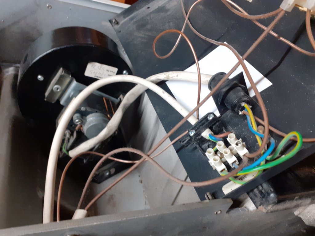

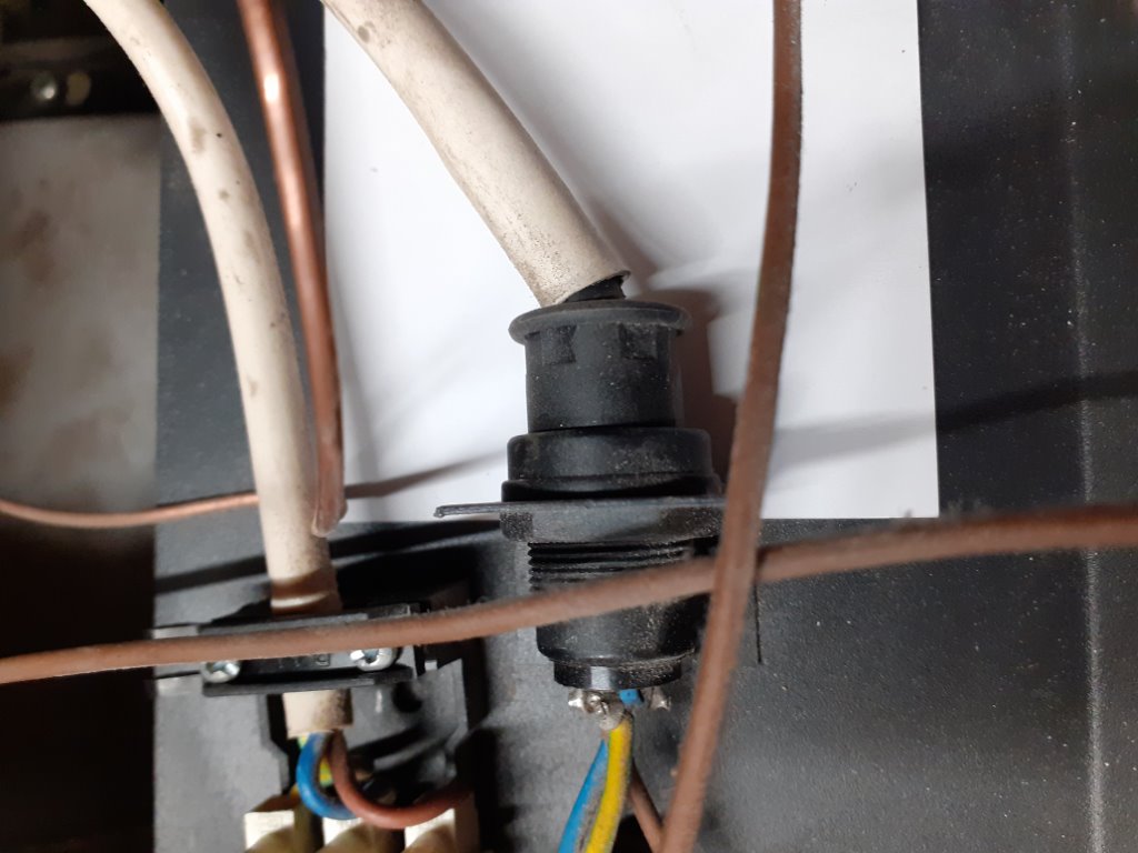

The thick power cable from fan goes into something that looks like an old-style black plastic lampholder, anchored horizontally to the drop-down fascia that carries all the electrics; there's a black plastic collar that you can unscrew - just like a lampholder, in fact - but when that is undone, the cable from the fan is still wired into the base of the "lampholder" somehow; there's nothing like a plug-in connector that you can just pull apart - which is what I thought I remembered from before.

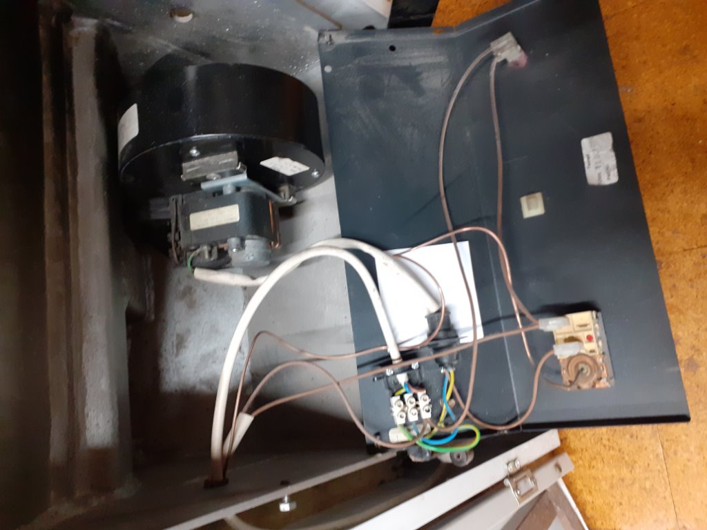

Hello again: boiler went out in the night again - all hot, fan off, when I went to bed - so I've taken some photos before relighting - 3 attached, I don't really know my way around these forums, not sure how to post photos correctly, so I hope you can see these. I put a square of white paper behind the "lampholder", so that it shows up against the dark grey metal of the fascia.

On the other hand, I do seem to recall cleaning the fan in my workshop at some point, away from the boiler; so I'm sure you're right, and it is a plug connector, but it just didn't want to give when I tried to pull it out.

Just for future reference: is the cable connector just a straight pull-apart job? Or is it twist and pull, like a bayonet-type lightbulb? If I get that wrong, I'm liable to break the wires. It wouldn't come apart for me with a straight pull, and I was nervous of applying any more force.
Relit the boiler successfully yesterday afternoon, but again, all the pipes and heat leak rads were barely lukewarm this morning. Fan has now been running for at least four hours; if I hold my hand inside the draught flap, above the flueways, I can still feel some warmth coming up (so fire's not completely out); but it isn't picking up the fan draught and burning any brighter. In part, I suspect, because the firebed is so choked with this fine dust and ash (no hard clinkers forming) that the draught can't get through.
The white sleeve on fan wire goes into the (Should go into the) plug.
There is a raised lip to pull on. Wiggle and pull at same time.
