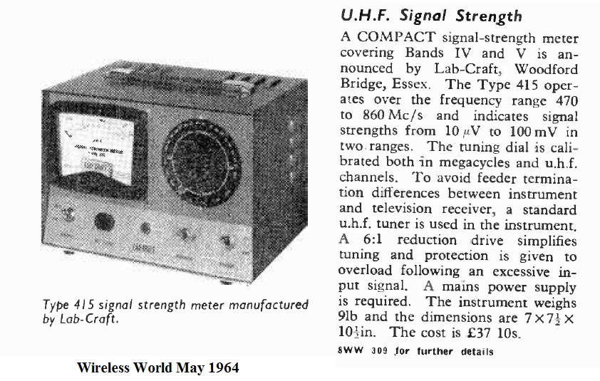

Think. Why do aerial installers spend several hundred pounds on signal meters?
Inflation........
The first company I worked for back in the 1960's
