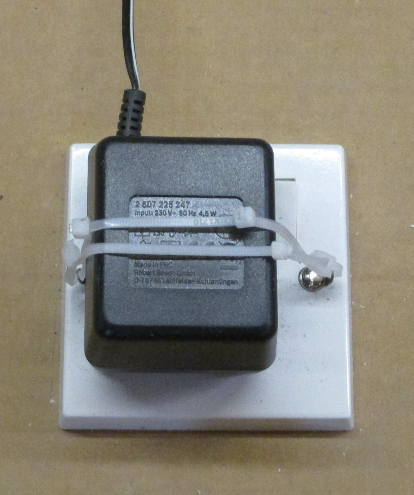

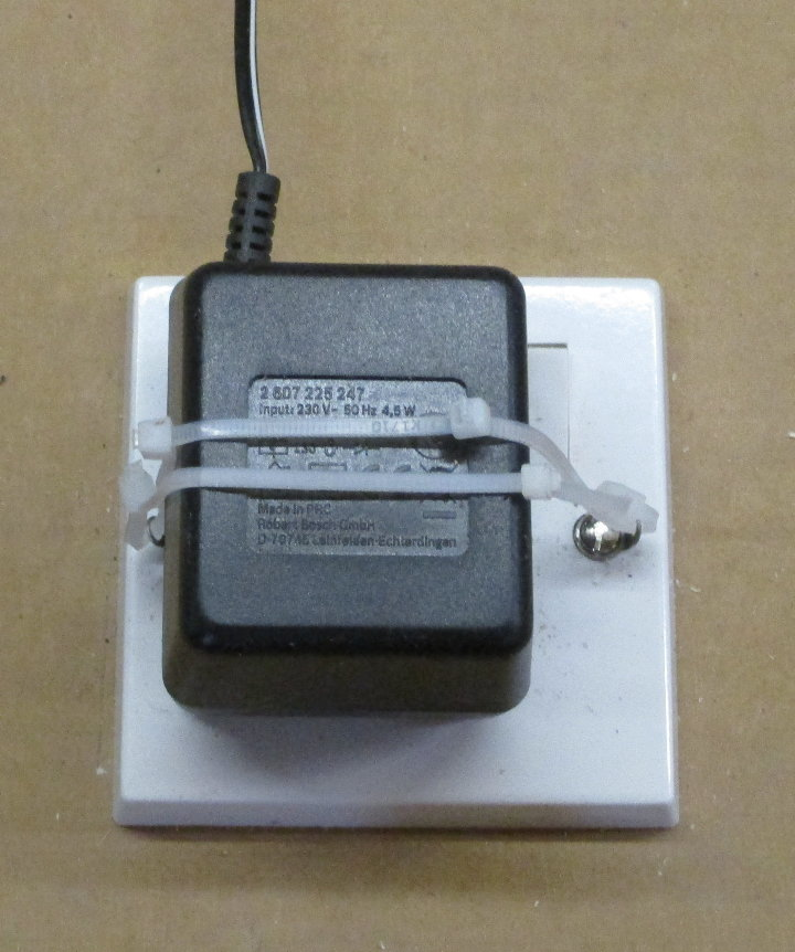

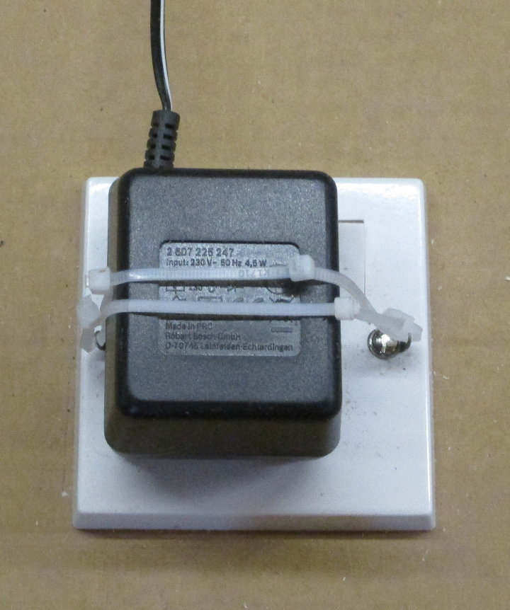

I've seen bathroom TVs done where the TV is in a an enclosure that is sealed from the bathroom and with a glass window to see the TV through. The IR remote works through the glass, the TV and all the connections are sealed away - needing a screwdriver to remove the front of the enclosure to access anything.
How do you do that?
Kind Regards, John

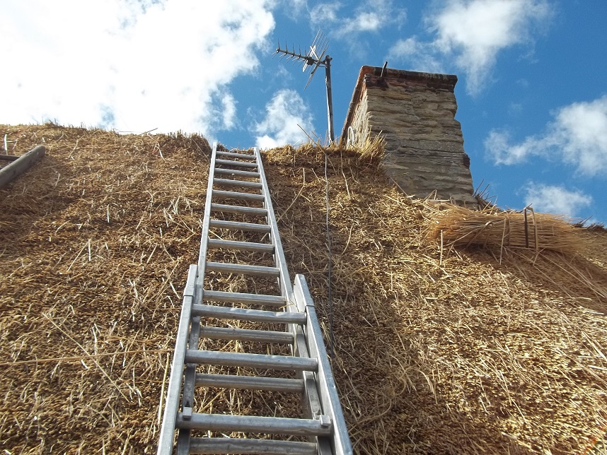

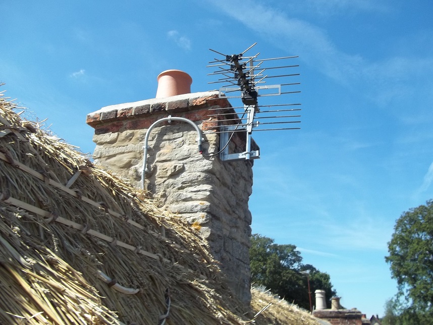

Why only 4 feet of coax? An aerial should be mounted well clear of the roof line. A typical mast/pole is 6 feet long. Then the cable has to get into the loft.
Why ? and loft aerials ? what about them
My aerial was mast mounted before the re-thatch, moved to be at the side of the stack and the signal is just as good. 14 miles from Sandy Heath
