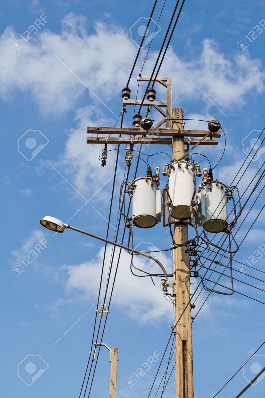

This is a cartoon from https://hackaday.com/2016/02/22/a-field-guide-to-the-north-american-utility-pole/
but it is not that far from the reality of when extra tin can transformers have to be hung on poles to supply a few extra houses or offices.
This is a fairly typical set up of three single phase transformers converting ( probably ) 10kV 3 phase delta to 4 wire 3 phase star.
26080796-three-pole-mounted-single-phase-oil-immersed-transformers-on-concrete-pole-bank-as-a-three-phase-tra.jpg
