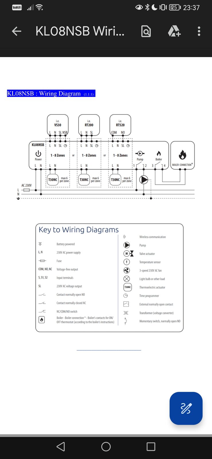

So I have
1. Ufh wiring centre, salus
2. Ufh wired sq610 stats for each room, salus - they seem to be programmable
I was intending to get for the CH (because I could make it all salus and online controllable): and remove the current timer built into the boiler - but I am open to alternatives for the below if I then need to have two different apps it's fine:
1. Salus stat sq610rf - again seems programmable
2. Salus rx10fr
3. Ug600 gateway
Pasting Madlabs post from other thread:
You wiring is wrong, you don't send perm lives to the 2 ports otherwise they would just stay open all the time.
You don't need to use the boiler output at all either, unless it's being used to power a central wiring centre. The permanent power normally goes to the boiler from the fused connection unit, that would also normally power the wiring centre (the power out from the boiler can do that if needed but that depends on where everything is located)
Permanent lives would be sent from the wiring centre to the grey wires of both 2 ports. When the room stat calls for CH then it's receiver sends a Switched Live (SL) (from the wiring centre) out to the CH 2 port's Live - brown, the motor activates and the valve opens. That hits a microswitch that then sends the perm live on the grey over to the Switched live out - orange. That SL then connects to the boiler (Lr) (via the wiring centre) and turns the boiler on.
With the UFH then an UFH stat would call for heat, the control centre would switch a live in to the boiler switch (from the wiring centre) out to the UFH 2 port live - brown - that 2 port then opens and the microswitch then send the live in - grey - over to the live out - orange and as the same as before, turns the boiler on. The pump switch works the same way as the boiler switch, it would need a live in (from the wiring centre) and then sends a live out that turns on the manifold pump at the same time.
@Madrab , ths attached shows 2 boiler wires on the far right. Do I need to use only one of them as the live out from Ufh control centre to the valve?
They lose contact for fun, very unreliable, if you already have them for your UFH just leave them until they fail, I would use single channel Hives for the other zones, obviously you will need 2 apps to control everything, for the hive zones you will need a thermostat and receiver for each zone but they can share 1 hub
Is hive programmable? I.e timer option built in
I need to check if that's a volt free switch, if it is then the boiler switch on the UFH controller will need a perm live in, so when it switches it sends that live out (Switched Live) to the UFH 2 port Live (Brown)
It's a Salus KL08NSB controller? If so then both the boiler and the pump switches are volt free (com/no) Both should be able to take 230V
Seems Volto free.
How would the two wires work from it?
One wire in is perm live, then one wire out is that live out so to speak?
Yep that's the one. So should I send a perm live into one of the holes too? And use one wire out to the valve/pump?
Yes, follow the manuals wiring advise, the live in would run in through the com and the live out (SL) would be from the NO to the live on the 2 port to energise the valve. The pumps mentions 240V but the boiler doesn't so I need to see if there is a rating somewhere for the boiler switch.
