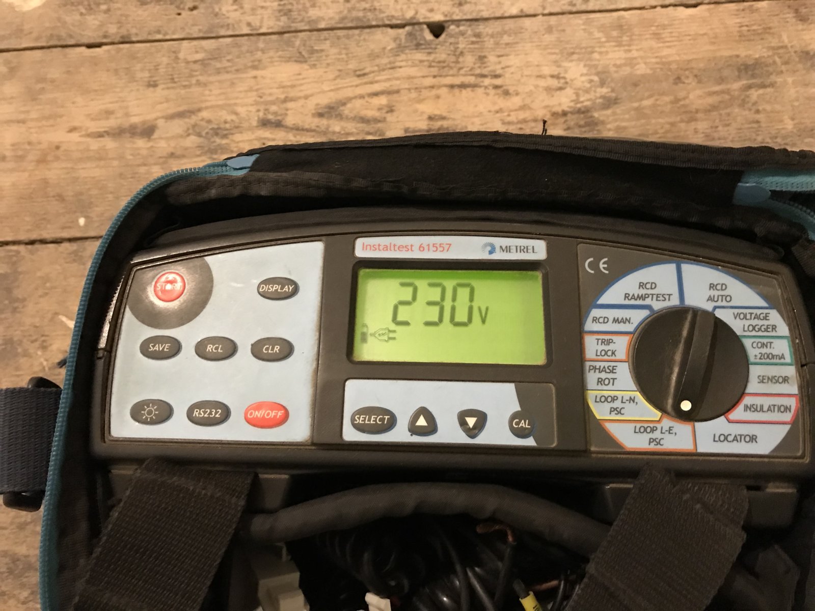

As an aside my 61557 has started measuring anything less than 0.5 Ohm as "<0.5Ω". I don't know why: any ideas?
No, it hasn't been connected to any other equipment. Plain weird!
I’ve had an odd occasion where my meter has started doing strange things due to me changing some settings without realising.
It’s possible to reboot the tester to factory defaults. I’ll have a look through the book and let you know what you need to do.
Cheers! I used to work with one but the one I have now doesn't have any destructions.
Yeah, thought of that. New batteries still the same issue!
Hi Simon. Sorry for the delay in posting this. Hopefully it will work on your machine?
The issue which may arise there is that the apparent anomaly he was experiencing does not seem to be in that list of 'resettable settings' - although maybe it 'resets' more than it admits to. Hopefully it might!
Kind Regards, John
As to the voltage note set line - earth does this mean it measures voltage line - earth as well as loop impedance?
