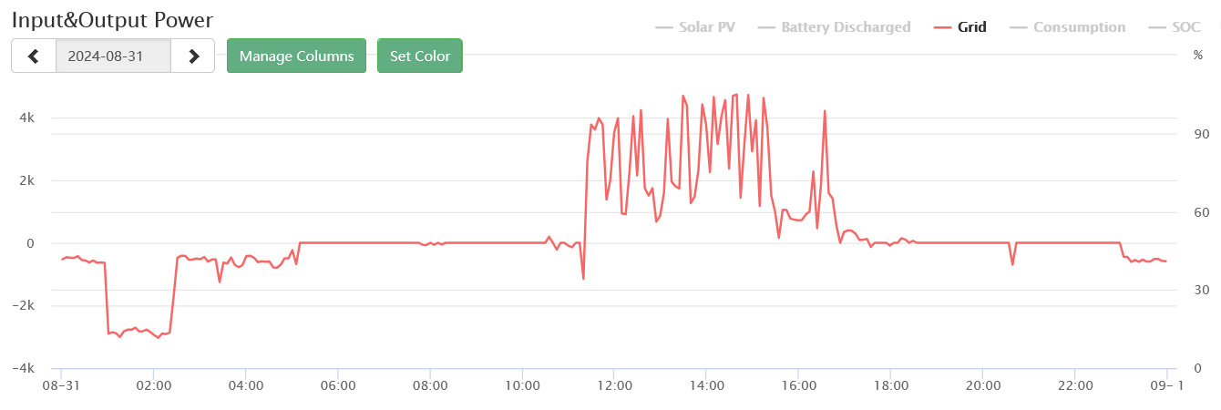

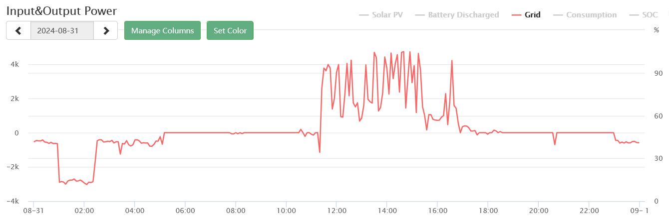

Not necessarily. Don't forget that these days power flows can reversed in the local networks due to embedded generation (e.g. solar PV). So the voltage at the end of a line can be higher than at the transformer.
The DNO likes to keep the voltage up as it minimises I2R losses. Then embedded generation comes along and reduces or reverses voltage drops.
Where I use to live, the voltage was always on the high side, and I had an old 65 watt fat tube fluorescent fitting, which was designed for 240 volt, and it worked fine most of the time, then two things happened, one could not buy 65 watt tubes, but 58 watt worked OK but shorter life, and then a load of solar panels fitted, will guess were going over voltage, and locking out, and the voltage dropped, to 230 volt and my fluorescent fitting would not fire up, so forced to fit a LED tube.
Solar must push up the volts, the national demand may increase during the day, but the local demand in a housing estate likely the reverse, this shows what I use 1725268283312.png on a typical day, below the line using from grid, above line feeding to the grid, so 1 am start charging battery, 5 am start using battery, 11:30 am the battery again full so start exporting until around 5 pm when solar not enough for my needs, until 11 pm when battery down to 10% so start using grid power, so 11:30 am to 5 pm I am exporting and likely all other homes in the estate are the same, but also likely most out at work, so no power being used, so unless the DNO transformer can auto change the tapping, then the voltage is likely to raise.
