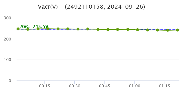

In my living memory our basic UK mains voltage was 240V, always was, always will be in my humble opinion.
When I started work all the warning signs said 440 volt, or 254 volt single phase, but it was always 420 volt or 242 volt single phase, and plus/minus 6% but when it went to 400 volt (230.9 volt single phase) it went plus 10% minus 6% so the max volts when 257 to 254 hardly any change.
And for many years the supply stayed the same, but the solar panels and EV charging points changed that, with many finding the panels tripped on over voltage, so we saw at long last the voltages drop to 230 volt, although not it seems with this house, today 242.4 volt as I write. EU was 380 volt (220 volt) and they went up to 400 volt (230) in an attempt to harmonise, but in real terms nothing changed either side of the channel.
The 16% variation is causing a problem, with detecting loss of PEN, the method around the problem seems to be the 50 volt to earth has been raised to 70 volt to earth for EV charging points, yet 25 volt can kill a cow, so even 50 volt is on the high side.

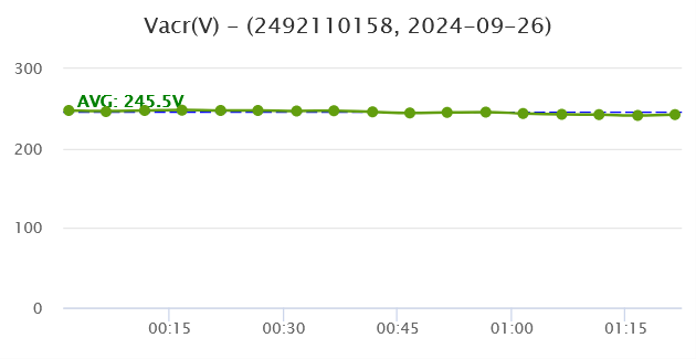

My system logs 1727310293912.pnga power cut is called no AC connection I assume? So total of 4 times over a year it reports voltage out of range.
The recorded voltage is for a shorter time1727310403300.pngit shows 241.3 lowest and 248.2 highest, but only over last hour and a quarter, the problem is without solar panels I would have no record of any event.
