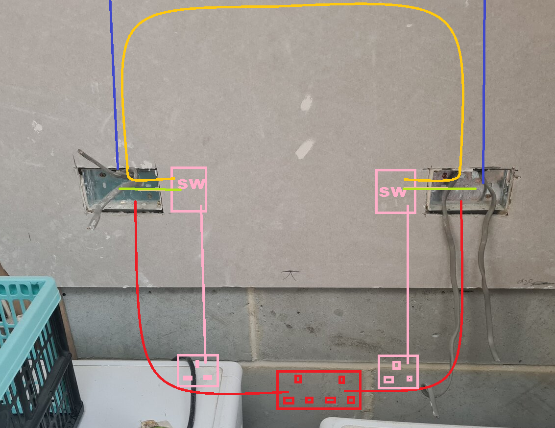

under worktop socket afterthought.
If he's not happy with spurs, it's not much extra work to extend the ring.

The "feed" from the CU goes from right, up to feed the one on the to left rocky.
Then go down from the Left to Your new socket then back up to the Right to complete the ring, you can likely drill up behind that plasterboard if needbe, might not even have to
Any reason why he never run cable horizontal

It shouldn't be too hard to re-jig that wiring so the new socket or sockets are on the ring - it's just a matter of working on the same principle of what's already there, in other words making sure each socket has two cables.
It wouldn't be the end of the world if you spurred from the sockets - you could have a single socket spur for each appliance, rather than one double socket, as this may be more convenient in some ways.

I did. I discussed with him and then I ran the cables. He checked it, I boarded it.
I don't want to do the guy a disservice as some of the confusion is most likely coming from me and my interpretation. I spoke to him earlier and he was OK with a spur if we had to do it. His suggestion was to add a socket higher up from the one on the right to and redo the cables. This I thought might look odd and there will be units a bit higher up
Do not really understand what would that achieve
Looking at your picture there appears enough wire to take 1 down below the counter and add a new link back up again

I think you are saying the 2 cables in each box are currently blue going off to other parts of the ring and the orange goes up the wall along and back down.
If that is correct I see 2 easy answers:
1) add 2 double pole switches or FCU's as already described, either in addition to the existing 2G boxes [as shown in pink] or replace 2G with two 1G's or use a double box as already described. Divert one of the existing cables into the new box and a link back to the double to complete the ring [shown green], Then drop a cable down from the switch to a single socket. It looks like there is plenty of space behind the board and if blocked with dot & dab with care a route can usually be created.
2) abandon the orange cable and drop a cable from each socket to another under the worktop shown in red. I've shown a double but I'd recommend 2 singles.
My preference is option 1) as I prefer to be able to isolate machines easily.
