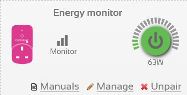

My software also shows what is being used 1726563428117.pngsome I can work out, the freezer for example 1726563493673.pngbut that does not account for 323 watt even when allowing for using four freezers, so I have two tools to help, this 1726563722031.png is great for sockets, it gives me a time-power graph, so the freezer 1726563820478.png for example I can see it switching on/off, and also see the average. The first half the upright freezer 1726563944192.png the second half is the chest freezer the upright has a auto defrost which is why it uses a lot more power and why there are peaks and troughs.
But where not using a plug and socket, then I need the clamp on ammeter here checking earth leakage Diffrence line neutral 8 Feb 24.jpg but to check what each RCBO uses, I need to either open the consumer unit, or turn items off. I have tried, and it does seem it is rear of house ring final where the unknown power is used, but it is so small and varies so much I have not investigated further. Likely the Sky box or router which I would not switch off anyway so why worry.
Using the in house display (IHD) for smart meter is in the main useless, as most of the time it shows export, and the solar panel software has a delay as the server is in china, so I can make two cups of coffee, carry them upstairs, and the software is still showing the kettle is using power.
So to use the solar software to find what is using power is not easy, and the smart meter is even worse.
So 400 watt, on a smart meter not easy to isolate, turn items off, and on turning on again often some initialisation will draw power, so the big question is it worth it? 400 watt at 8.95p off peak and 31.31p peak = £2.56 per day or £933 per year, so yes a lot of money, I blame freezers for my bill, and 4 trips a week for shopping v 1 trip a week with nearest town 8 miles away, they still pay for themselves.

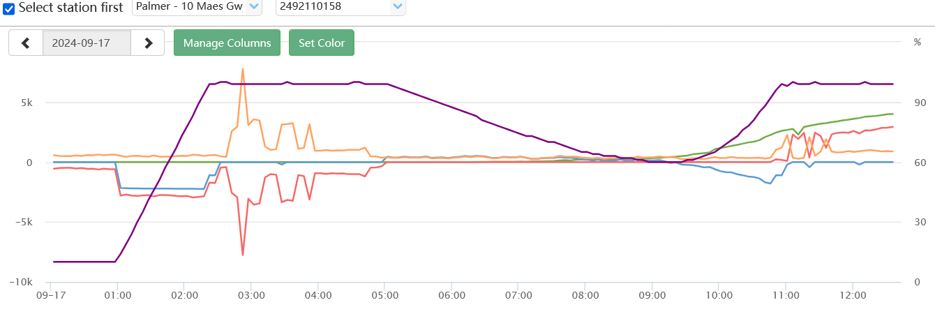

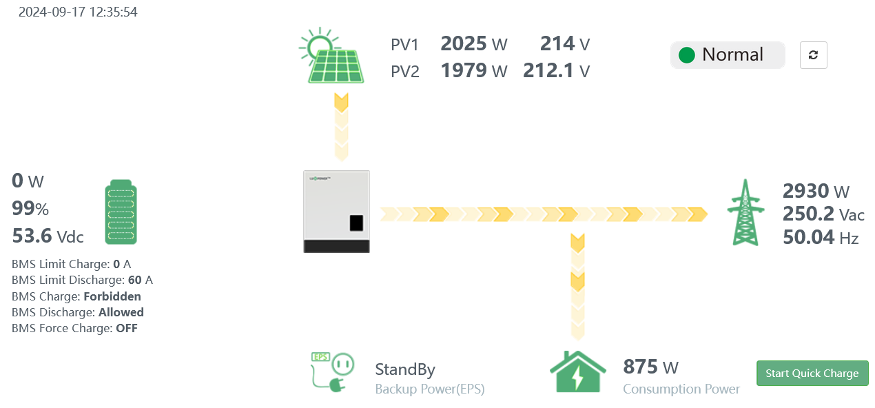

That is also what I use, the display however 1726573059113.png is a mixture of direct and from server readings, so it can give misleading results. 1726573192908.png If I compare the results here to my IHD on the smart meter they rarely match minute by minute but do day by day.
That is also what I use, the display however View attachment 355813 is a mixture of direct and from server readings, so it can give misleading results. View attachment 355814 If I compare the results here to my IHD on the smart meter they rarely match minute by minute but do day by day.
