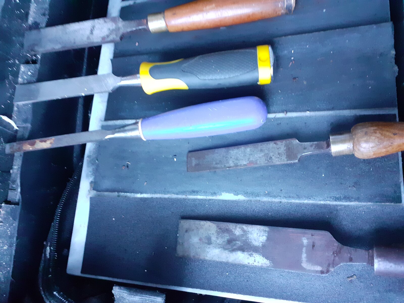

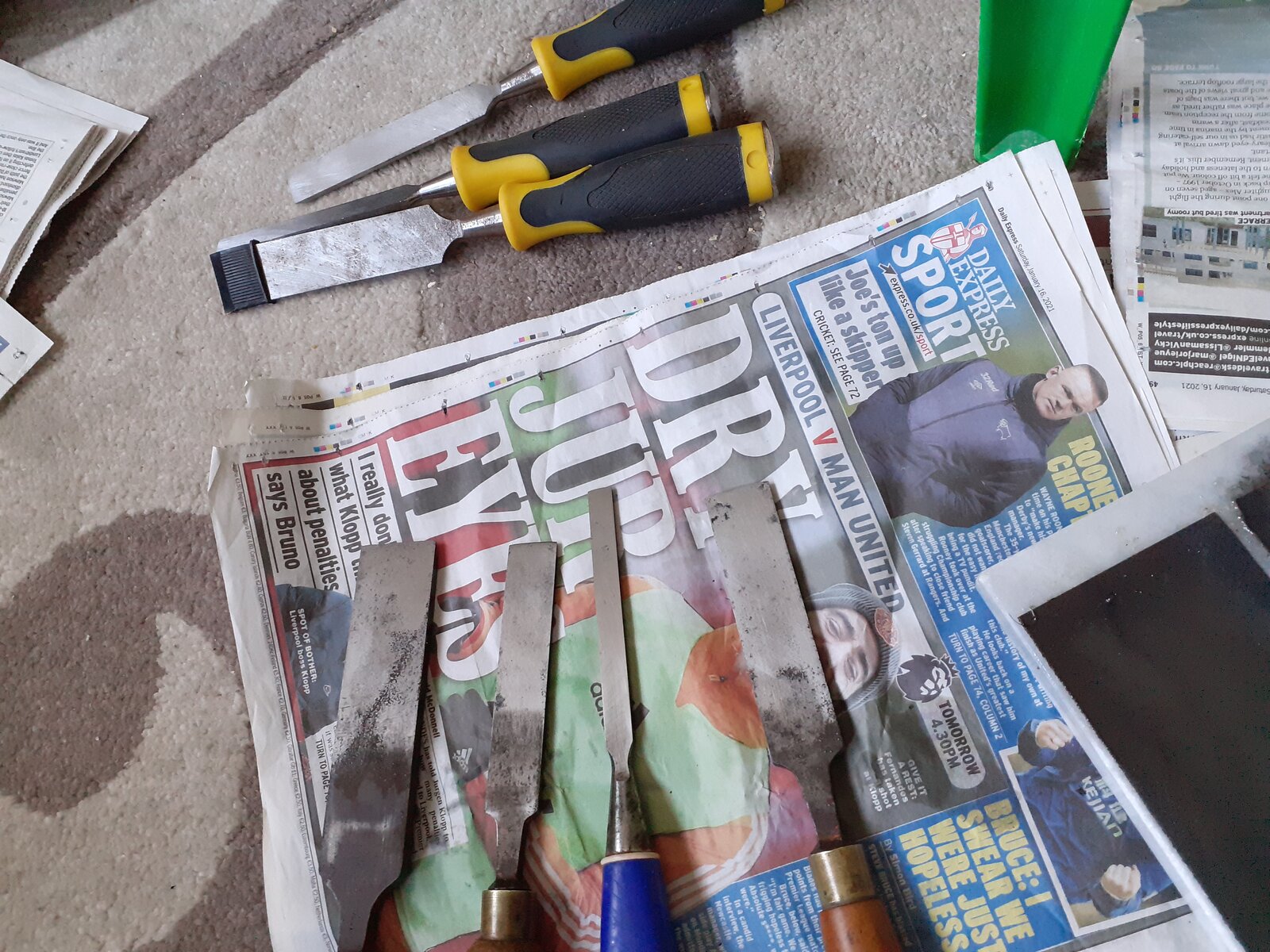

So flattening the chisel makes the back all shiny? U rub the back and on (as in picture with big old chisel) and work up through grits? Same as getting rid of burr. Do this after honing I guess.

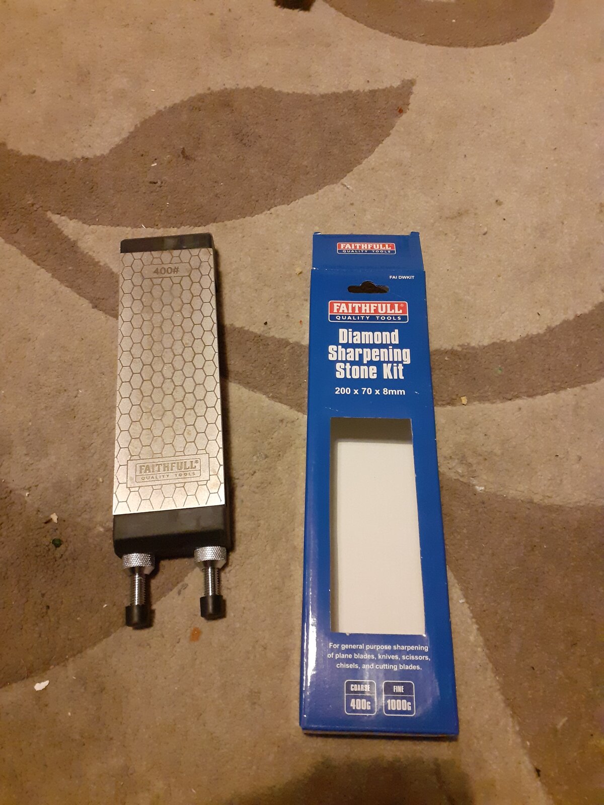

As well as the stone I made from your advice, with wet and dry paper; I bought a diamond sharpening stone kit 400 grit/1000 fine grit. Is that just for honing?

Most obviously, in the first case if you don't flatten the back before using a plane iron or chisel and there is any pitting in that back, you simply won't get a consistently sharp edge. Once flattened (to 600 grit) it is only necessary to buff up that face every few times you sharpen/hone with your highest grit paper in order to help keep rust at bay (a wipe over with a rag dampened with 3-in-1 oil ever time you hone or sharpen also helps)
So you do need to work up through the grits
But you also need to flatten the back of any old (and most new) chisels and plane irons before you sharpen and hone them. Think about it, if you flatten the back after you've sharpened and honed it you might well destroy that nice sharp edge you've just spent all that time to produce! The point is that it is a one time thing to do, with only ever the occasional polishing out with a higher grits if the backs get tarnished or go rusty (and they shouldn't ever go rusty because you are going to wipe them dry and then with an oily rag when they get wet, aren't you?)
As well as the stone I made from your advice, with wet and dry paper; I bought a diamond sharpening stone kit 400 grit/1000 fine grit. Is that just for honing-
You should be able to answer that if you have understood what was stated earlier in this thread. What grits did I say you used to hone on the "scary sharp" board?

I found this link. Seems it's just bottom part of chisel or plane that needs flattening, polishing.
I'll stick to the grits (wet/dry) for now

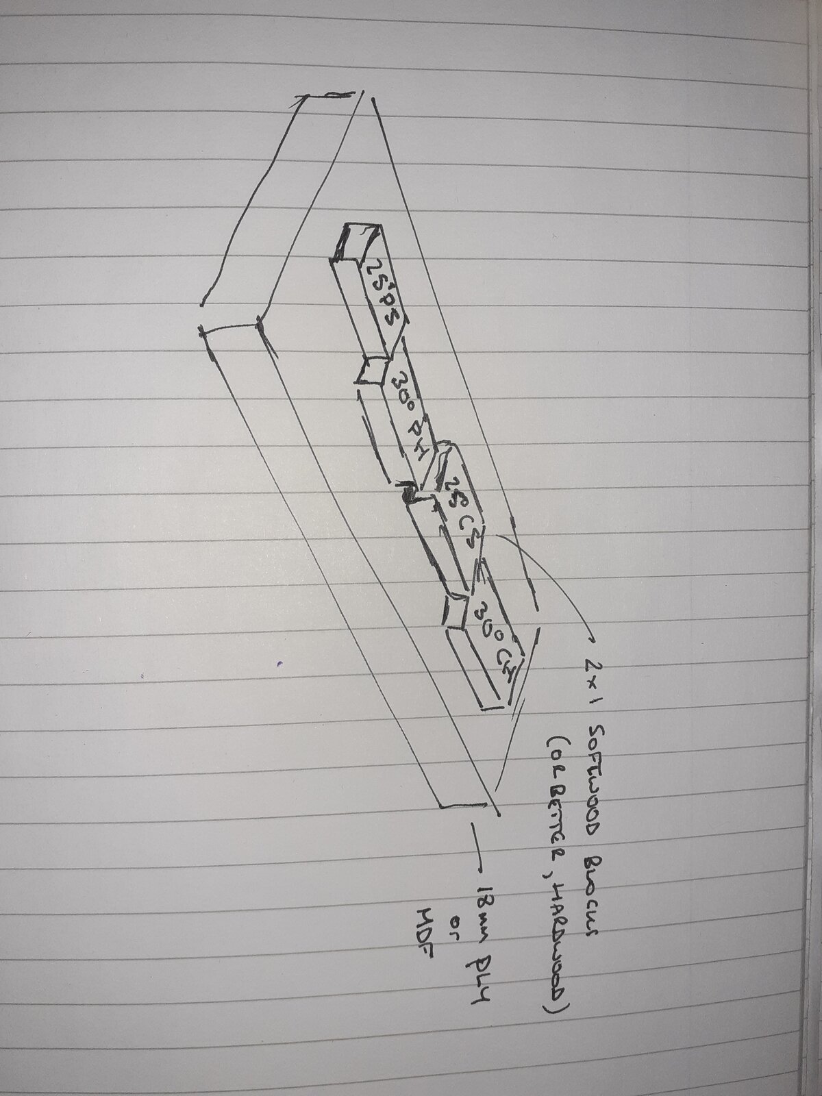

One trick I did learn back when this was my primary method of restoring cutting bevels was that a piece of plywood set with 2x1 softwood stops set at different distances from the edge and clearly marked with their function, e.g the first parallel to the edge but inset 30mm marked "30° CHISEL HONING", a second one inset 40mm marked "25° CHISEL SHARPENING", a third inset 38mm marked "30° PLANE HONING", a fourth inset 50mm marked "25° PLANE SHARPENING". To set the projection all you do is insert the tool into the appropriate slot and pinch up, turn the guide upside down, butt the honing jig against the edge of the plywood so that the projecting tool is near the setting block you desire then slide the cutter/chisel out until it touches the 2 x 1 stop block. Finally tighten up the screw on the jig pinching the cutter/chisel in place and you are ready to sharpen. Takes longer to describe than to do. Looks a bit like this when made up:

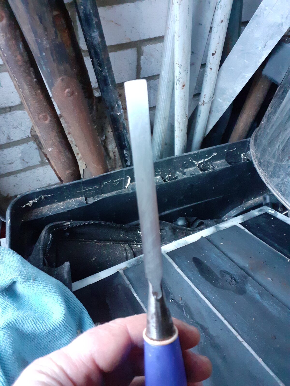

Regarding chisel flattening do u do it like this guy? Just bottom part of chisel; he seemed to do it at 45 degree angle too at times which I could only do on my biggest and smallest grits as they're on the edge granite slab. For some reason this link didn't work in my last post

Regarding chisel flattening do u do it like this guy? Just bottom part of chisel; he seemed to do it at 45 degree angle too...
I'm going to be rude and admit to life being too short to watch the video... and in any case I do seem to spend a lot of it answering your questions! :whistle: (only jesting)
I generally just polish out the last 12 to 25mm of a blade. You don't need to do more than that, so sorry for not making that clear before. It doesn't really matter if they go straight (back and forth) or diagonally. Because I use a belt grinder these days I tend to polish backs out on the grinder and that is done at an angle simply because it is the only way to present longer tools to the belt.
So there, it doesn't matter so much how you do it - it matters more that you do it

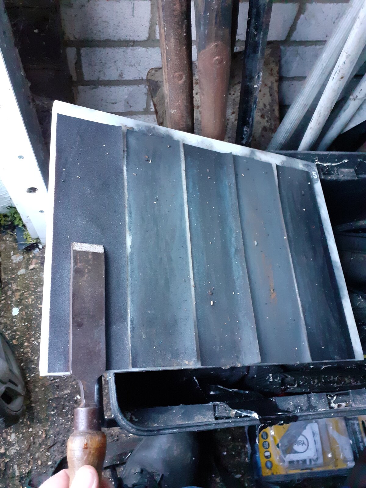

Got the back of my old chisels shinier.
Every last bit of black need removing?
Sort of - but the quality of the edge you subsequently produce is dependant on not having any rust "fissures" left in the back near the edge. Bottom 25 to 50mm of the iron or chisel does the job (as I said earlier). Fortunately it is a one time job unless you let them get rusty. Now you've flattened the backs, sharpened and honed them, how do they cut? That's the acid test
They feel quite sharp and cut the paper or score it. I'll keep at it now I have the grinding stone. Backwards and forwards on guide.

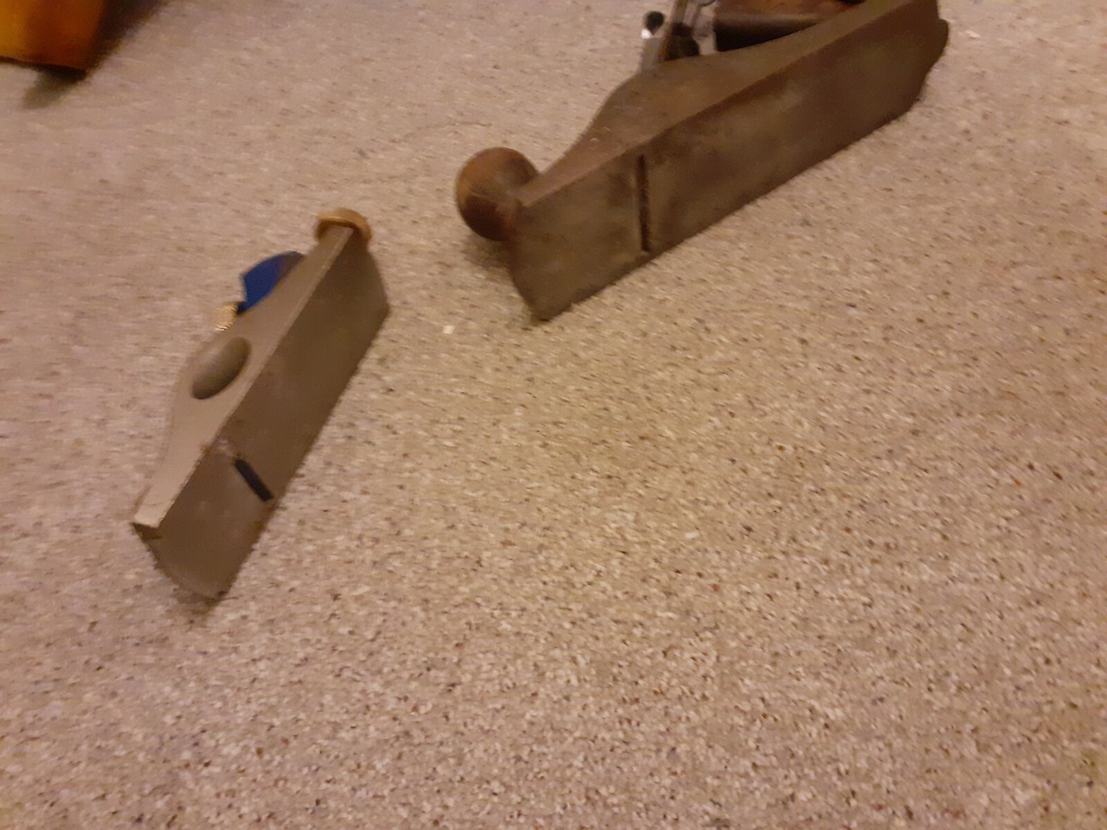

Another topic,
I want to use my hand planes more on future doors.
A joiner said he uses -
Smoothing plane, rebate plane, bullnose plane, block plane.

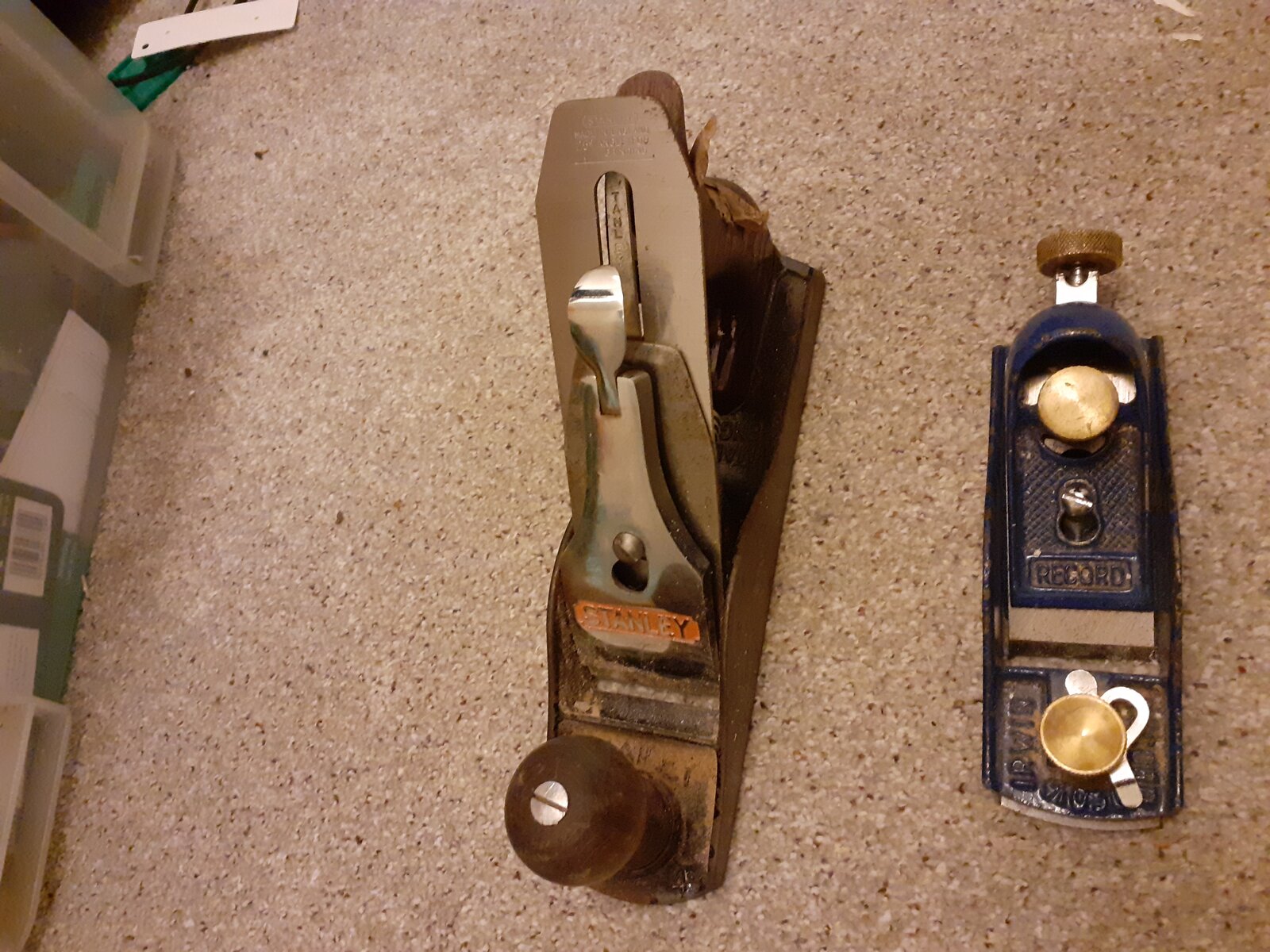

I have a blockplane and either a smoothing or Jack plane (see in picture) as I'm not sure which.
What brand/manufacturer of the ones listed by the joiner above would you recommend buying? Stanley etc I've also found my two planes a bit jolty on door edges. Should I put wax on them?
