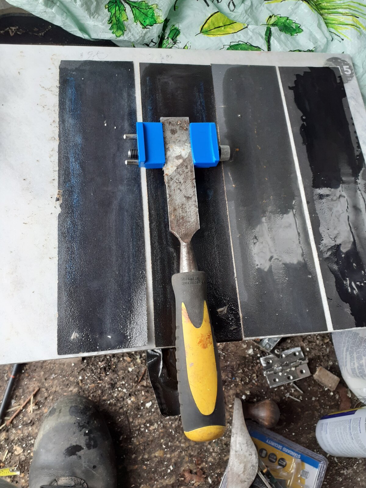

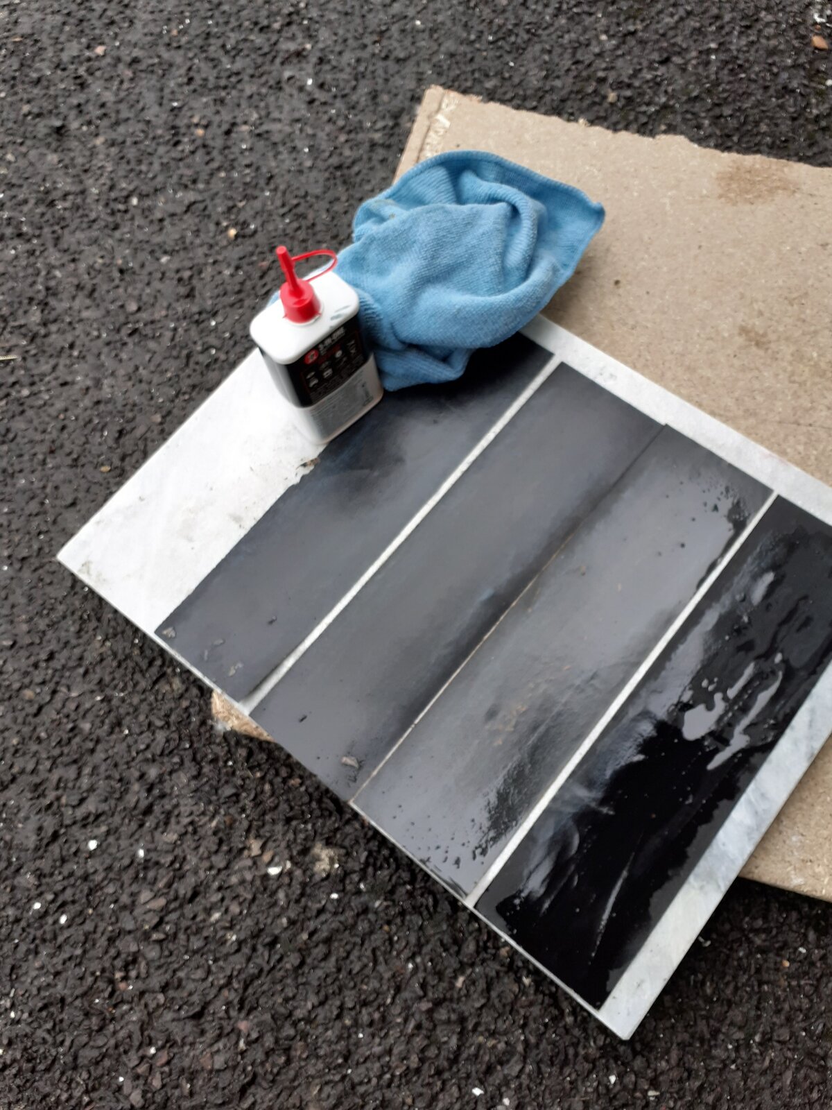

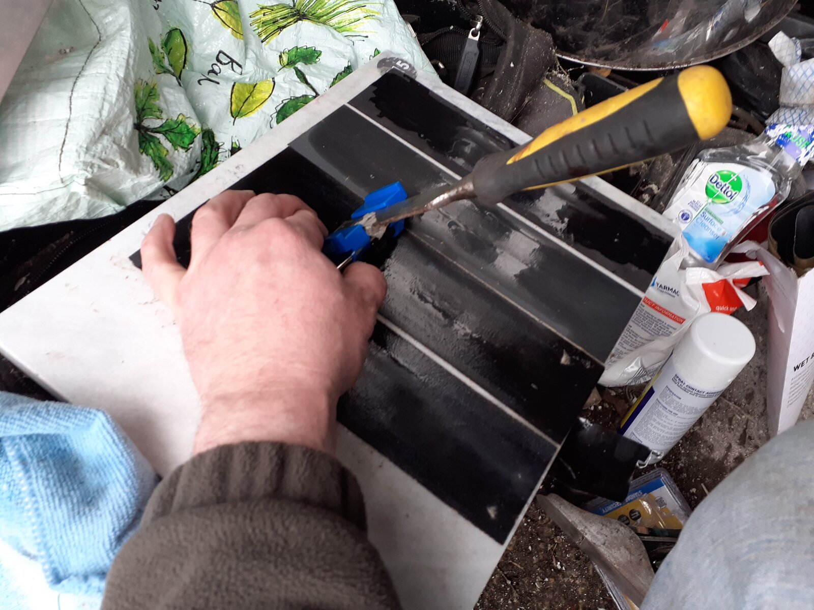

Glued on the 180, 240, 320 and 600 grits. Didn't have 120 so I guess that's needed too or could start on 180

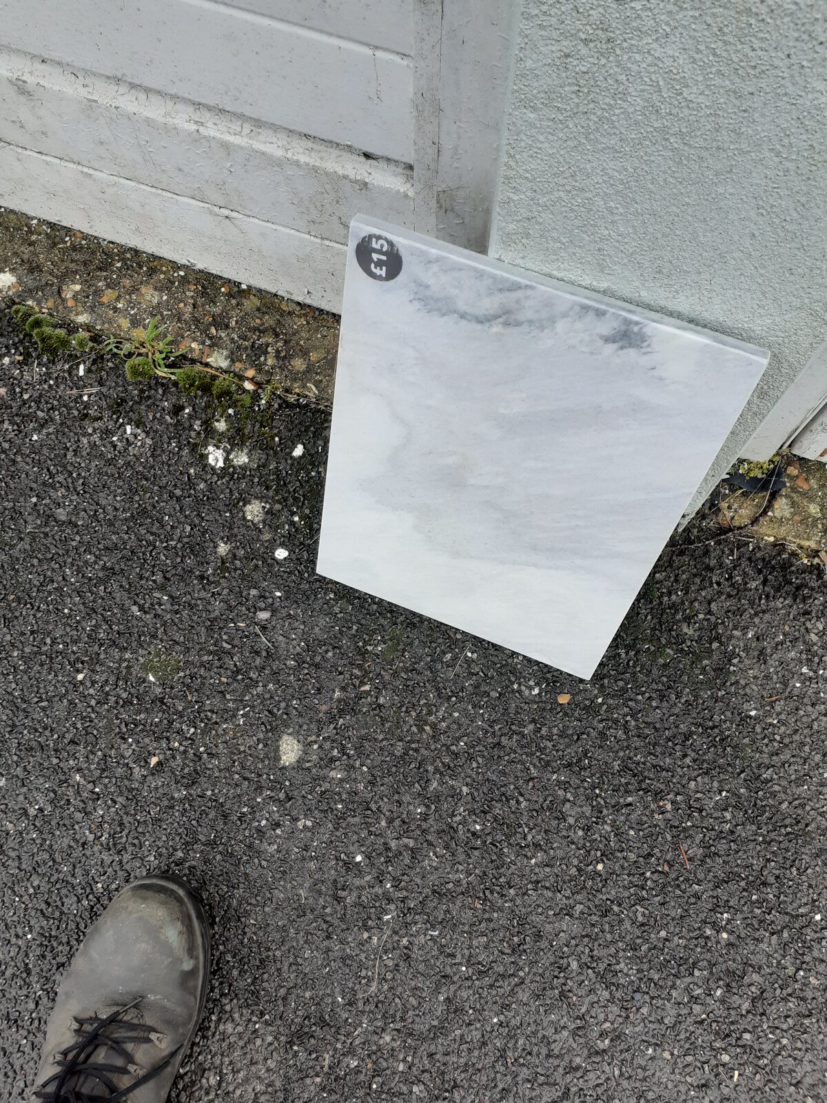

Grey granite worktop saver from dunelm- £15. The 600 grit had a few creases but mostly ironed out. I guess if needs replacing metal scraper to take off adhesive.

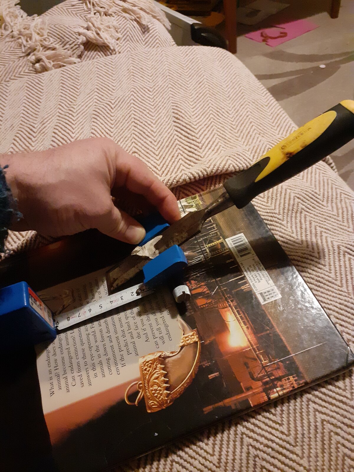

With the setting device it wasnt apparent which way round anyway I let it drop so it was touching the ground but not too much to take wheels off but so when u pulled it towards yourself the wheels rotated dragging the backend. How else can u use it? I then slid an old chisel into the groove at this angle until it was touching the wet and dry and pulled it towards myself not pushing away. Put planer blade in too, but read it was supposed to be honed at 38 degrees or 30 for chisels so didn't hone it until I've checked I'm doing it right. What do u think Eddie?

You should 2 measurements for each blade cos you've got 2 angles on each.
Chisel in the lower. plane in the upper part.
2 angles? Honed part of blade is just one angle i think. Dont u decide if u want either 25 degrees or 30 then set to that. I'm not sure TBH
If you sharpen at one angle, every time you do further sharpening you'd be grinding the whole surface area down.
By initially grinding at 25° ,then sharpening at 30° your only removing a small amount of metal so its faster.
After numerous sharpening you have to regrind back to 25° again and sharpen to 30..and so it goes on.
120 grit would be the starting point if your chisels are completely fubarred. 180 grit will be OK as a starting point, but if your edges ar bad or badly chipped it will take a lot longer to sharpen to an edge. Low grit number = large grit size = coarse surface = faster removal of metal.
Yes, bit of white spirits (or better still lighter fluid or Evostik solvent) to soften the glue bond then peel off. Use a scraper if required. BTW, it is a "when" not an "if" it will wear out

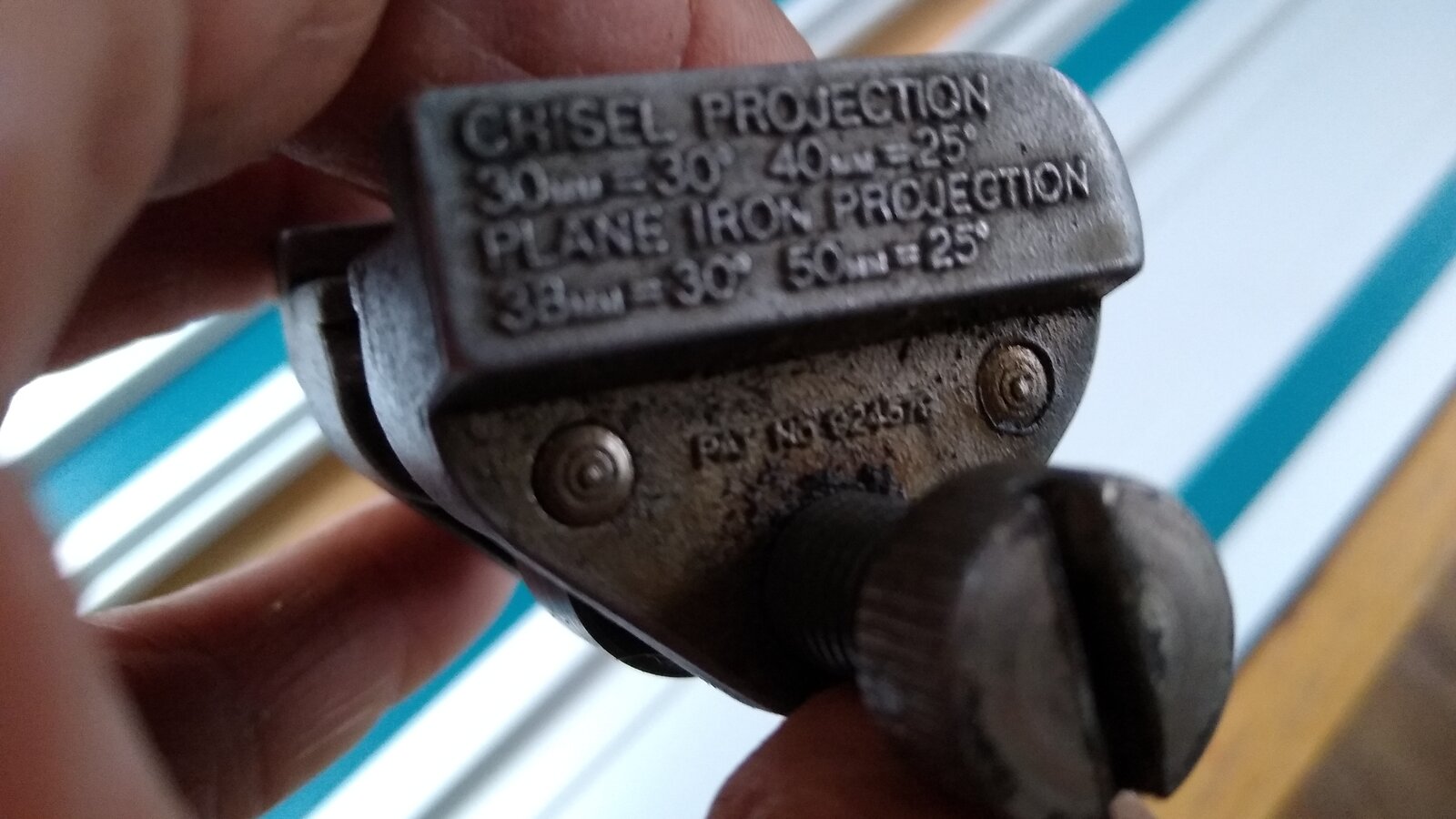

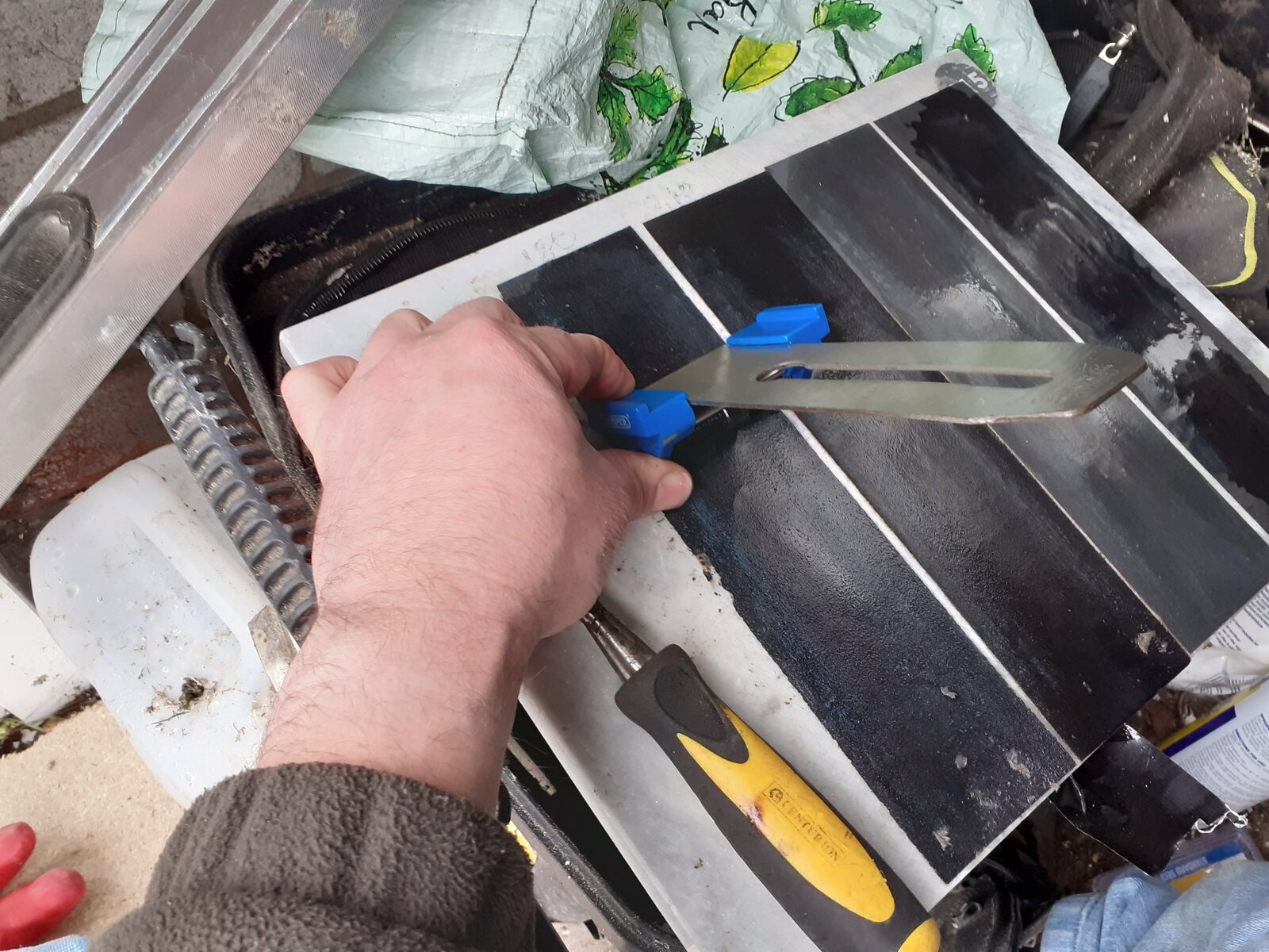

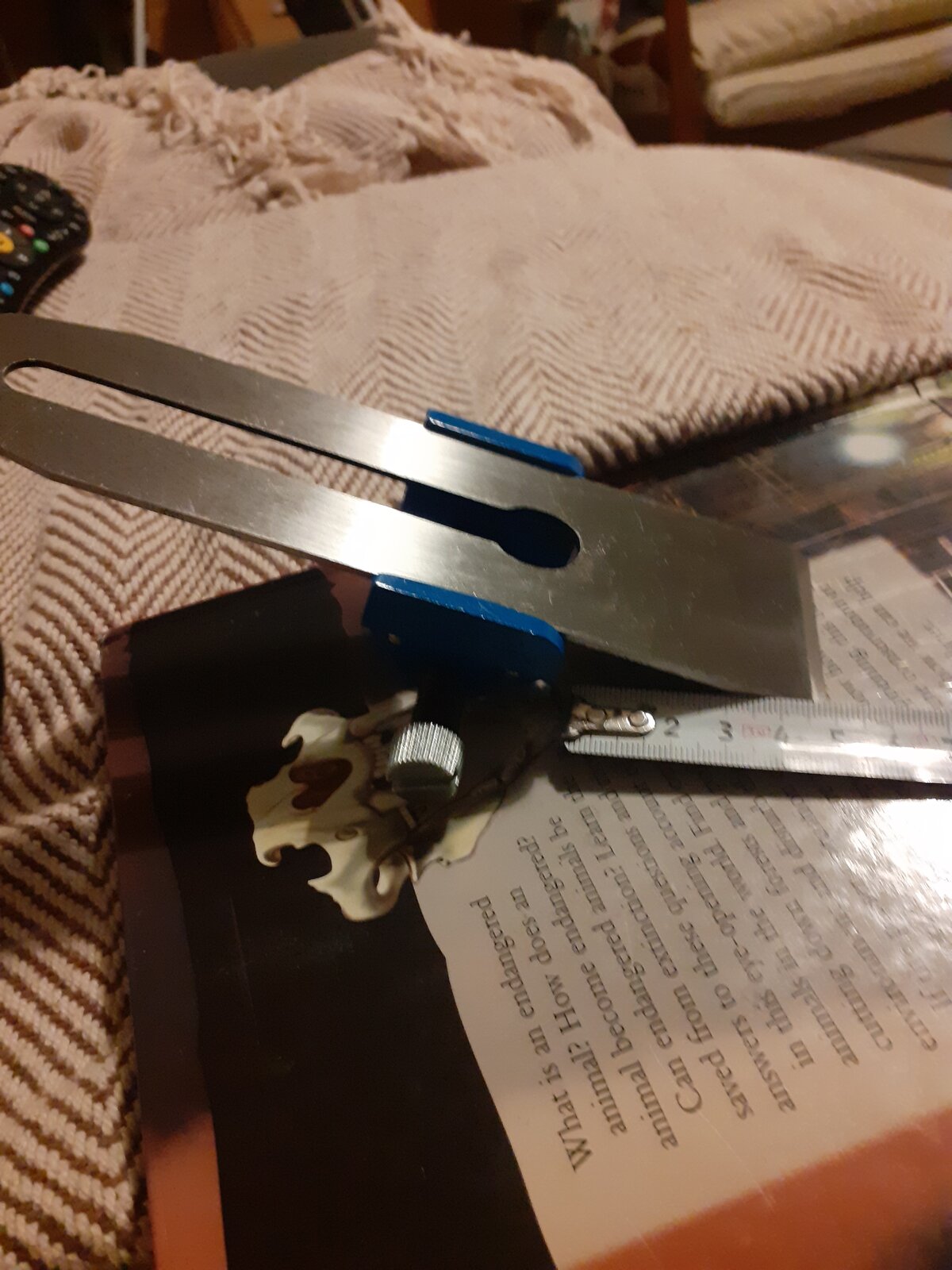

Didn't have 120 so planer blade in too but read it was supposed to be honed at 38 degrees or 30 for chisels so didn't hone it until I've checked I'm doing it right.
The general use sharpening angle for plane (NOT planer , that is a power tool!) iron is 25° (extension 50mm), secondary bevel or honing angle is 30° (extension 38mm). Plane irons are clamped in the upper pair of jaws and the extension is measured from the body on the end of the jig with the squared top.
The general use sharpening angle for chisels is 25° (extension 40mm), secondary bevel or honing angle is 30° (extension 30mm). Chisels are clamped in the lower pair of jaws facing the opposite direction to plane irons and the extension is measured from the body on the end of the jig with the rounded top.
I think you have confused extension with angle.
The main task is to grind the edges by working up through the grits. The honing bit, or secondary bevel production, should only produce a tiny 1 to 2mm secondary bevel the first time it is produced. Start this one with the 320 grit, then the 600 grit but only after working up through all the grits at the grinding angle. The iron or chisel can often be honed 3 or 4 times, sometimes more (probably only 5 or 6 passes on the abrasive each time), to "touch up" the edge between major sharpenings if you use this primary grinding angle/secondary honing angle approach

You need to produce the grinding angle first by working through the grits with the blade clamped in the jig. The secondary bevel produced at the honing angle is only a couple of millimetres wide and is added after grinding of the primary bevel is complete. If you have ground at the appropriate angle primary bevel working through the grits up to 600 grit, a 1 or 2mm secondary bevel can be produced very quickly with 320 then 600 grits only. NO NEED TO WORK UP THROUGH THE GRITS On THE SECONDARY BEVEL. Swapping angles back and forth between grinding and honing through all the grits is completely bloody pointless! (Not to mention a frustration waste of time and effort and very prone to inducing error)

Plane irons are clamped in the lower pair of jaws and the extension is measured from the body on the end of the jig with the rounded top.
The general use sharpening angle for chisels is 25° (extension 40mm), secondary bevel or honing angle is 30° (extension 30mm). Chisels are clamped in the upper pair of jaws facing the opposite direction to plane irons and the extension is measured from the body on the end .[/QUOTE]
You wrote above to clamp plane iron in lower jaws and chisel in top jaws. Have I done it wrong in photos? It seemed more natural to clamp plane in wider jaws. I put them facing in opposite direction too (as you stated).
