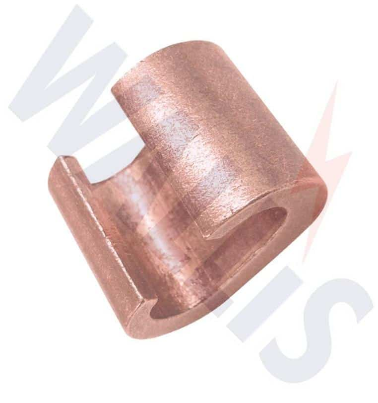

Be it tray or trunking it can be used, but the problem is the number of link wires required, in the main other way around, a large earth wire with C crimps, and all the sections of tray or trunking have a wire to main earth. The problem is these 1654899673548.pngneed hydraulic crimping tools, so rather time consuming.
So you're saying all joins need to be securely crimped and linked for this to be permissible?
