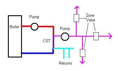

Let us say that the op decides to go for hydraulic separation between the boiler and the system and installs a LLH
He finds that by pure chance the spacing between the flow and return is such that all he has to do is cut out 2 sections of pipe and slot the LLH straight in, happy days!
so he gets himself a suitable pump to fit on the Primary and fits It
He then learns that because of the fact it now doesn't have to pump through the boiler its now suitable as the secondary Pump even more happy days
Now
That's all he has to do mate!
he has got a perfectly working S-Plan system (think of the LLH as a heat because, thats what it is)
no need in his case for two secondary pumps,nor check valves etc
He may need to tweek the auto bypass but thats already installed and it would need tweaking anyway but the boiler or boiler pump dont need it
OP pleased and the Boiler as happy as larry :D
all a Low loss header is,is a packaged set of "closely spaced tees" with some nice extras thrown in the working principle is the same

What hasn't been mentioned is the temperature drop between one pair of tees and the next. That's fine if you have a rad circuit and an U/F circuit. You put the pair of Tees for the rads first and the pair for the U/F next.
But what if all circuits need the same flow temp, as in the OP's case?
The solution would be Matt's suggestion of one pair of secondary tees, one secondary pump and an S plus arrangement.
The OP already has the three zone valves and the existing 15/60 will do fine for the secondary pump. The only query is whether you will need NRVs on the zone returns to prevent reverse circulation. You don't have them on a normal S plus, so why would you need them here?
That just leaves the question of the primary pump. The existing 26/55 appears to be adequate if the boiler is set to 26kW but would struggle of it is upped to 38kW. You would need a Magna 25/80, which wouldn't be a bad idea as it is a variable speed pump.
You won't , NRV's are not required if Mv's are fitted neither is the CST arrangement (don't confuse a LLH with a CST) , the CST arrangement which is used over the pond use a pair of CST's for EACH zone which is the reason they use the circulators with the 'inbuilt' NRV at suction side of circulator , the whole point of the CST arrangement is to eliminate any flow through 'off' circuits when using multiple circulators.
What would be the point of using a zone valve to each distribution circuit when boiler pump/distribution pumps only assist in moving water through their 'own' respective circuits?
A Vaillant LLH uses 4 tappings , two for primary (boiler) and 2 for distribution (secondary) , due to the spacing of the distribution tappings (wide) circulation from primary pumps would be apparent in distribution circuit , if the distribution tappings were placed within 4 pipe diameters appart then primary circulation through header would have no influence on flow through distribution side , another factor being velocity which is another subject.
It wasn't me who suggested the use of CST's , i'm just saying it would be pointless in the OP's case as it would require an extensive re-pipe.
Lets not forget , a LLH is a de-coupler and NOT a closely spaced tee , a slight difference.
A CST and a LLH both serve the same purpose: to separate the boiler (primary) from the radiators (secondary).
But that's just one way of doing it.
No point at all, but that only works if the required flow temperature for each zone reduces as you go from the first CST to the second.
What's wrong with this?
I'm not disputing that although the LLH does have an advantage over the CST (think about it).
Not at all , using the 'parallel' P/S circuit (crossover) ensures ALL 'secondary' loads recieve the same water temperature (not to be confused with the series P/S circuit)
look at DH's diagram, the point is to stop flow in circuits you don't want on
:mrgreen:
I think the boiler/llh/buffer manufactures would take a dim view of this type set-up. ;)
Rubbish,
discounting the LLH/and buffer manufacturers for obvious reasons the boiler manufacturers would prefer that over a standard primary flow and return system every time
(well the pump manu would want a bypass fitted and the expansion connection isn't shown but D_H has just simplified the drawing that's all)
