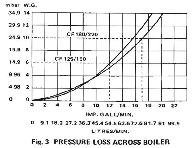

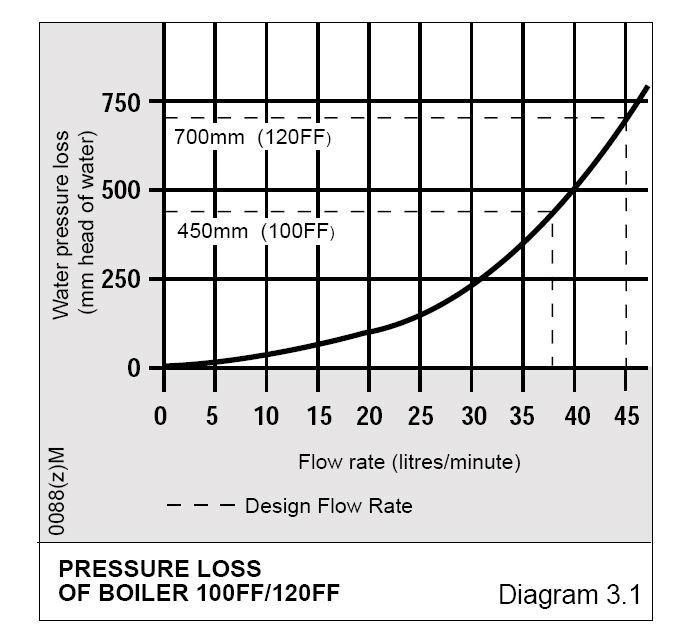

Just as an example here's the headloss graph for an old Glowworm Ultimate heat exchanger. The 120,000 Btu is around 35 Kw (so similar to your Vaillant). The dotted line from the 120FF shows the flowrate (45 litres/min) at the traditional 11 degree drop and a corresponding head loss of just under 0.75 m. However if we recalculate at 20 degrees drop the flowrate will be 25 litres/min and a head loss of 0.25 m.
Now plug a 20 drop across the ancient Potterton CF125/150 heat exchanger and at a similar Kw output we get a head loss of under 0.05 m!

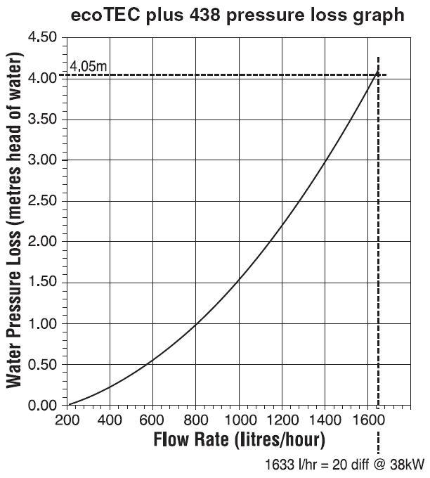

Now compare these old heat exchangers to your modern Vaillant....
At the 20 degree drop and the boiler output of 38 Kw we get a flowrate of 1628 litres/hour (approx). Look at the heat loss...it's massive at 4 m.
If we recalculate at 15 degrees we are off the scale and the head loss is vast, at 11 degrees...forget it. This is just another part of the great condensing boiler cover up, the public and installers have been conned into thinking modern boilers are reliable and easy to install compared with the older generation boilers.
