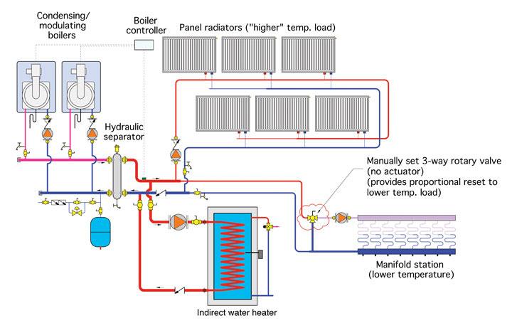

Sounds like like your system needs a LLH, as already suggested.
You could have a header with a 15/60 as the shunt pump (between the boiler and header)
Then a single Magna 25/80 powering the whole system on the other side of the header (no other pumps)
Or you could have smaller pumps, one for each circuit.
Depends how much money you want to spend!

You have the initial solution...either a single large pump (not just picked at random but the correct head capacity at the required flowrate), either a couple of pumps in series or a low loss header with multiple pumps (the most expensive option and a custom wiring job).
