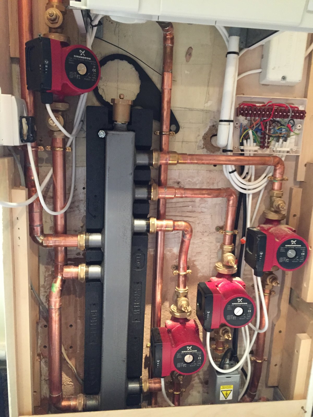

Worcester LLH fitted to a 438 28 rads on two zones and 210 unvented purrs like a kitten. Just fit it and forget the maths guys.
A picture paints a thousand words :)
Thanks. I wanted assurance the Worcester LLH could work with my Vaillant boiler. I saw no obvious reason why not, but good to know someone has done it. Hopefully my installer will be familiar with the combo too.
Ask him to note the use of the two port valves. They act as a high temperature non return valves. The call from the zone powers the secondary pump and activates the valve. The orange is switch live as normal and the boiler controls the primary pump. Piece of cake, but there's a lot of materials and work there, so sit down when he gives you the price.
