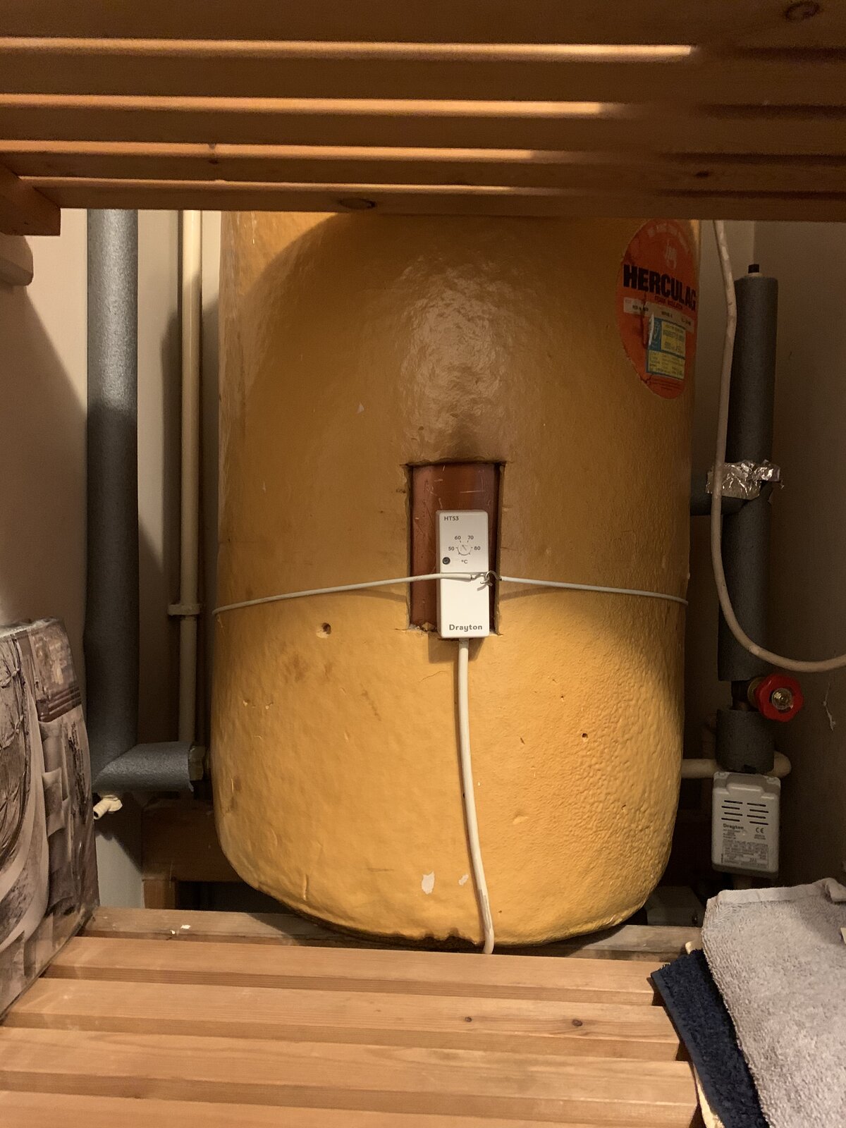

Nope, no filling loop there. So as per @Gasguru, we could now do with a photo of airing cupboard. We can advise further then.

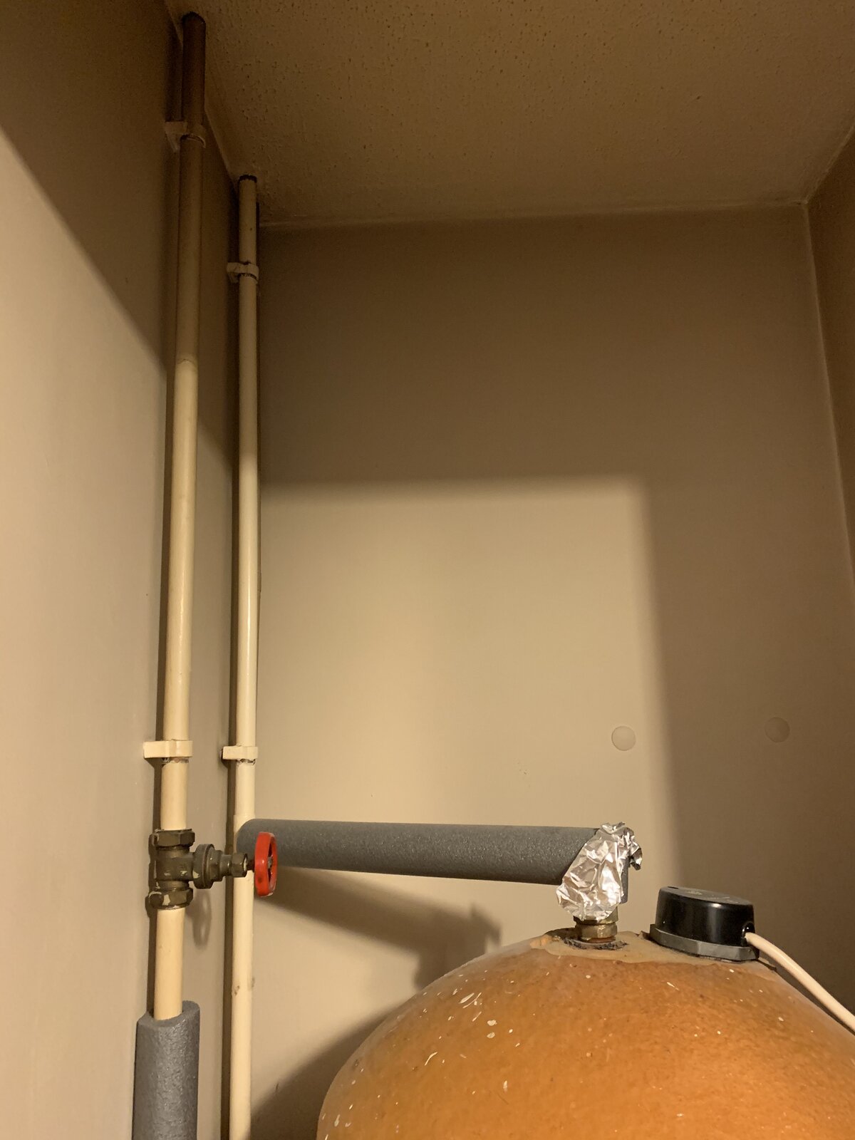

Looking at the photos so far, tells me it’s an open vented system,not sealed. So I refer you back to post 5 by checking the feed and expansion tank (smallest of the 2) for water, but firing up for heating with no demand suggests a failed zone valve. Has this issue always been there?

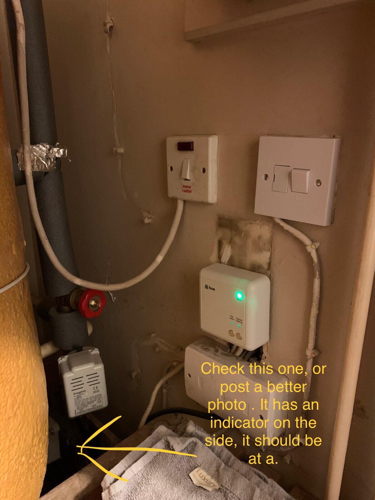

Need more pictures to determine the system.
Have a look below the Luxury flannels...there should be a pump...
And you might find it's a sealed system (I can't see enough pipes going up into the loft).
Ah, we have a pump where you mentioned. Could this be what’s clicking/rattling and all the above?!
You need top find out whether it's a sealed system (with a red vessel, pressure gauge etc) or a traditional open vented system...have a look in the loft for a small cistern around 500 x 300mm.
If there is sufficient pressure/water in the system then investigate the pump....those pumps are not great quality.
The front plastic hex "nut" unscrews. Then pull the nut gently out and it will engage with the impeller. Try spinning the impeller. You can then determine if it's seized.
With power applied you can feel the torque...perhaps the motors weak.
There will be a little water loss so have a cloth underneath.

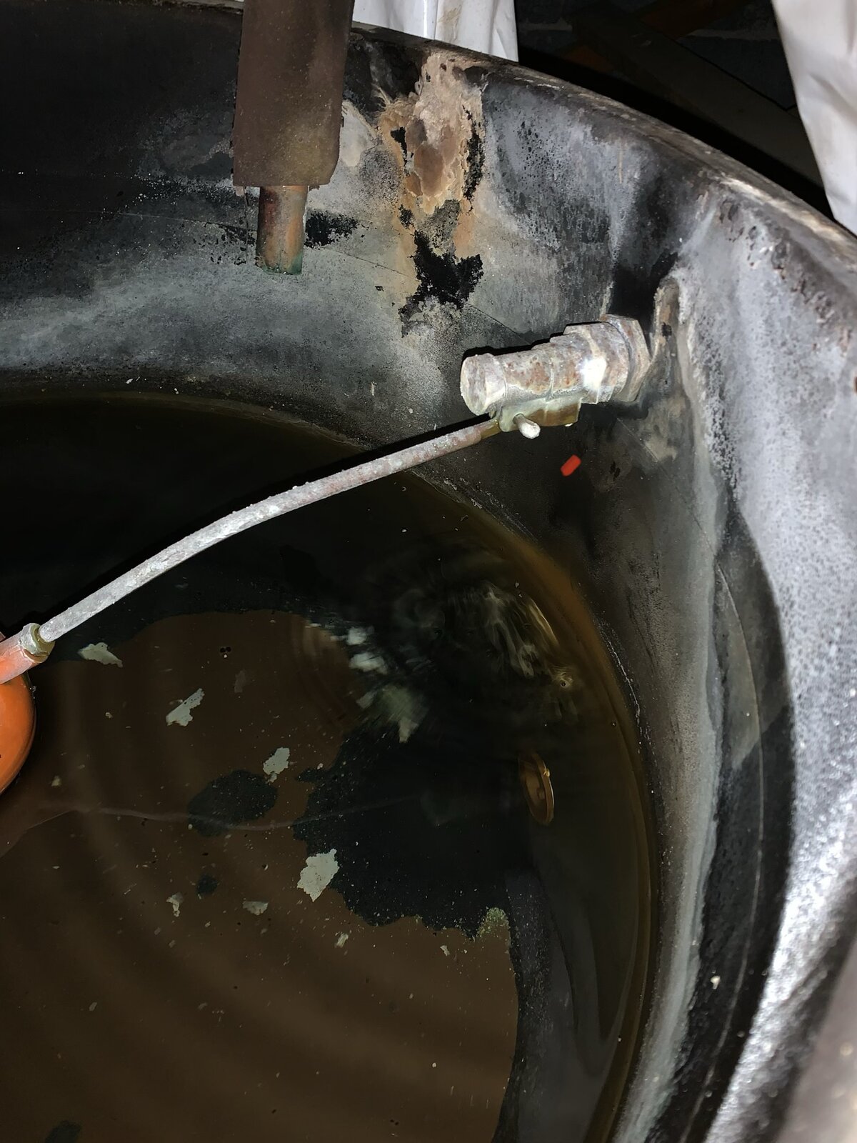

I’ve just been in the loft, the water tank is half full, I’ll send pictures over now. There are water droplets coming from the area just above the red dot on the picture
Do these picture help at all?
