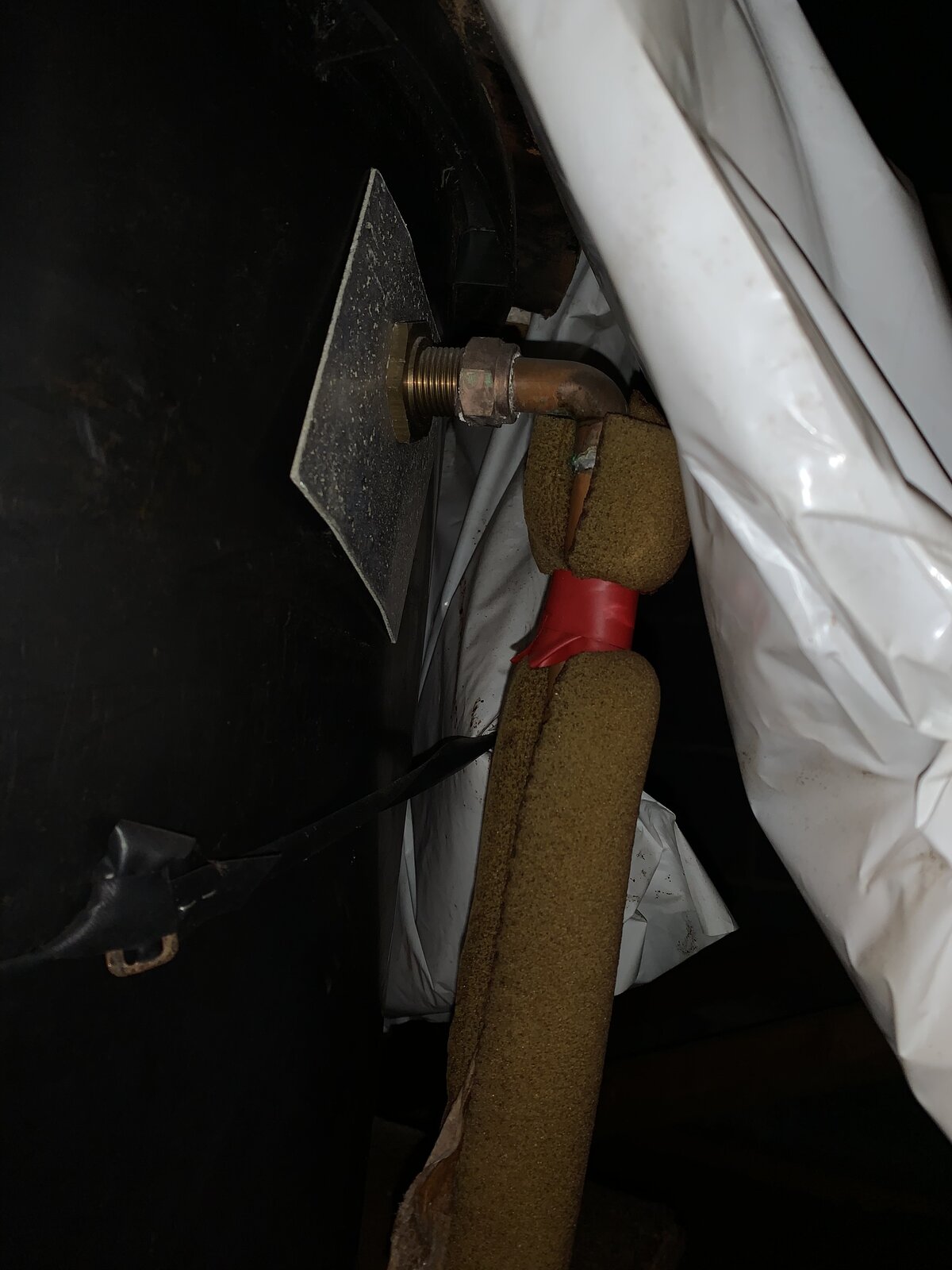

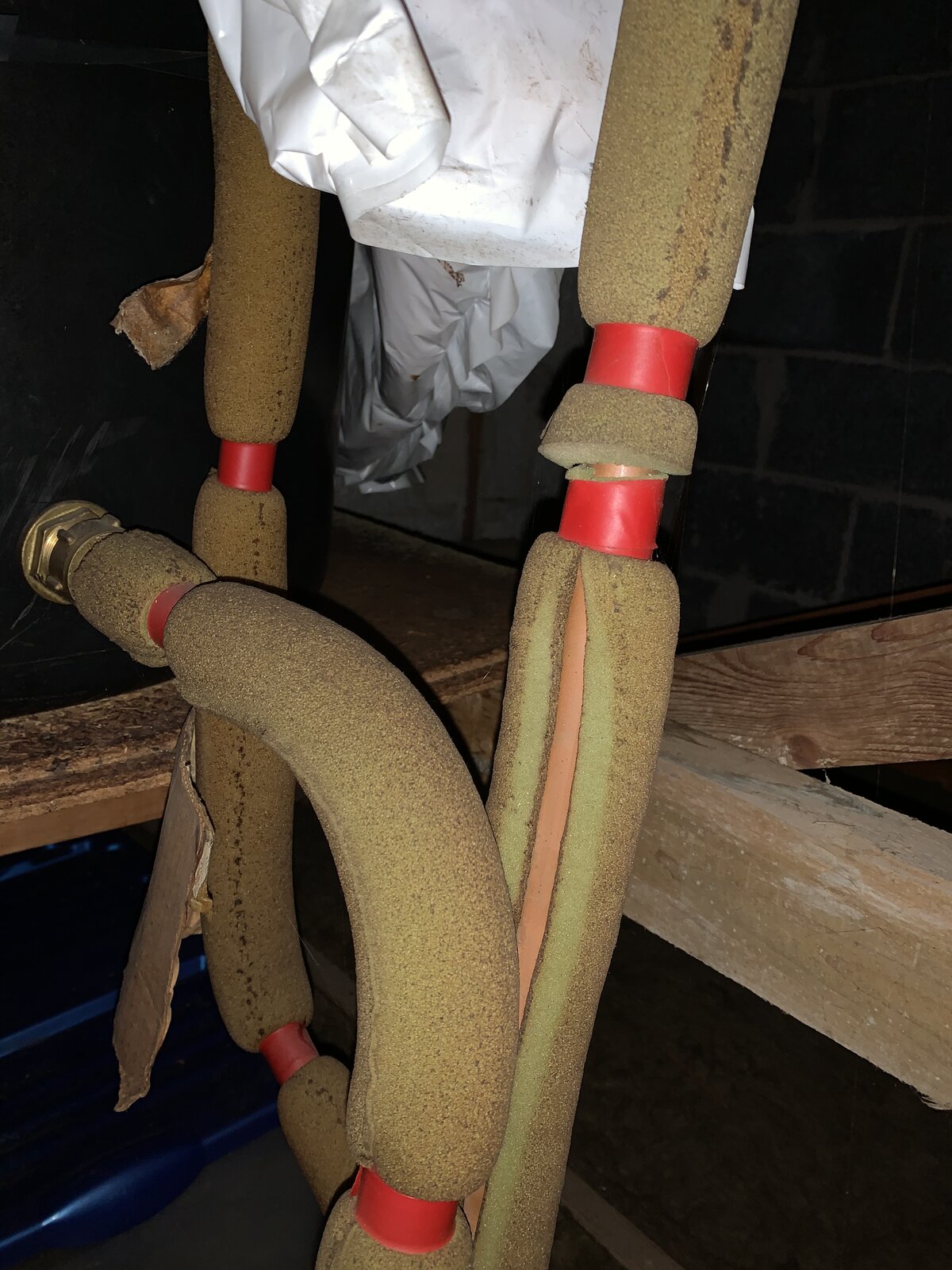

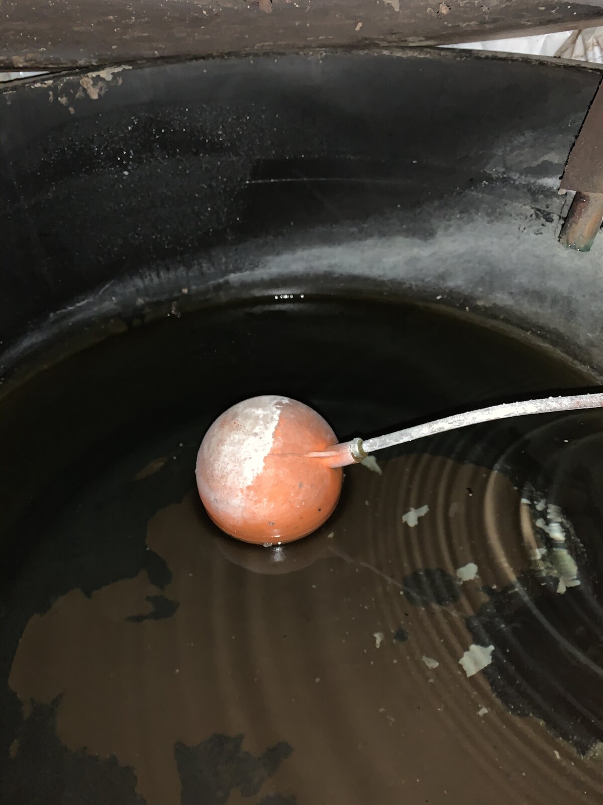

That looks like a combination tank for a combination cylinder. What about that black tank? If that’s inside the black tank, then that would suggest water is present. I’d be looking at a faulty zone valve or a link in pcb.
Yep the tank is inside the tank. I’ll phone Vaillant tomorrow as the boiler is under warranty so hopefully they can come and sort it

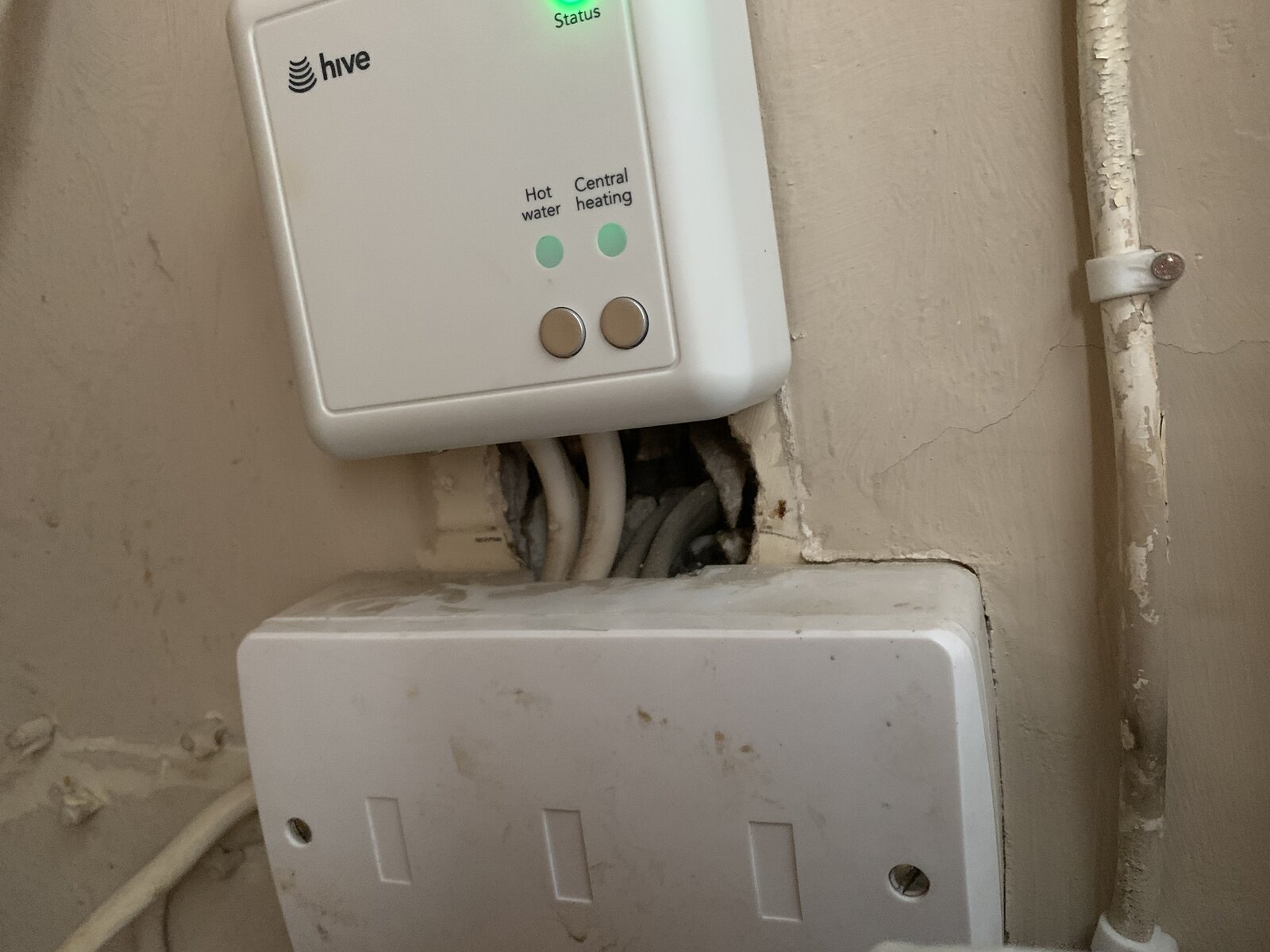

So the engineer has been, the problem is with the wiring when installer. There is a permanent live on the boiler when it should be set up to a switch live, so at the moment when there is no demand, the display still shows up when it shouldn’t do.

Depending on your choice of external controls for your boiler, there is a coice to switch theboiler on /off using 230V AC, which as you have zone valves is the best set up for your system, but if the boiler was installed with different controls there is also an option to use 24Vdc switching, the boiler comes with a link fitted to the 24V terminals and this has to be removed when using the 230V controls, but the Vaillant lad would have checked this, if you can get the front unit off the hive receiver and post a pic of the wiring so we can see what has been done, my money is on a zone valve end switch sticking though
Thank you for clarifying! Ah interesting, it must be that then! I can’t access the screws at the bottom, as you’ll see here, no space at all!
