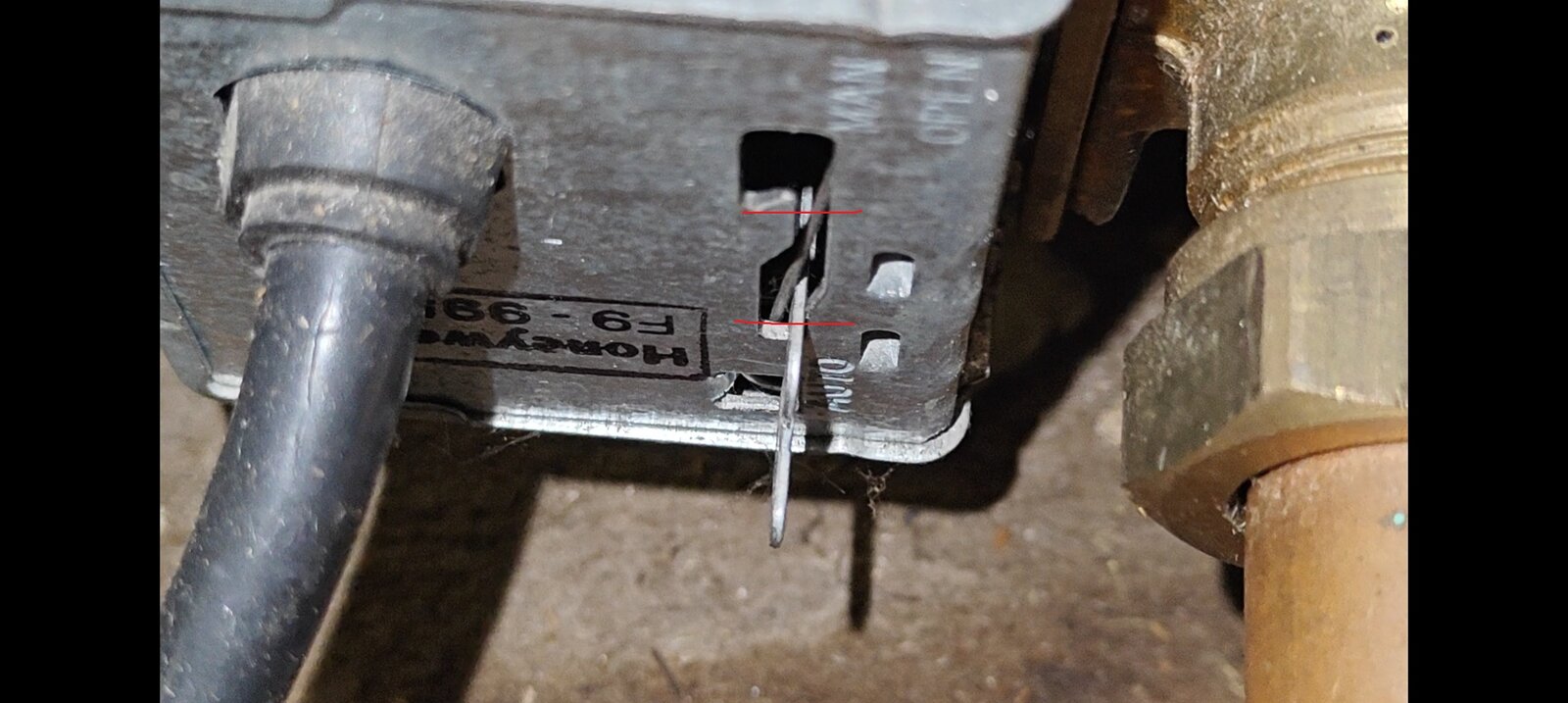

Attached is the picture of 3port valve and irrespective there's a hot water is on or off, the small lever on the valve can freely move between the two red lines marked on the picture. Could this be the contributing factor for short cycling?

I don't see how. The most likely scenario to give short cycling is when all the flow is going to the cylinder, any other position of the 3-port is better. By its design, the valve can only give HW, CH or both.

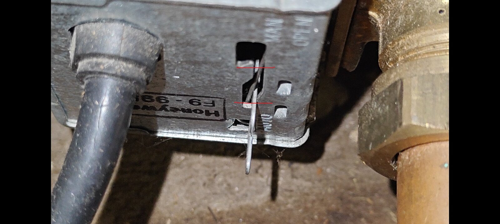

The lever shouldn't be loose like that but the valve just may still be operating OK, have you felt the cylinder coil flow & return piping?,

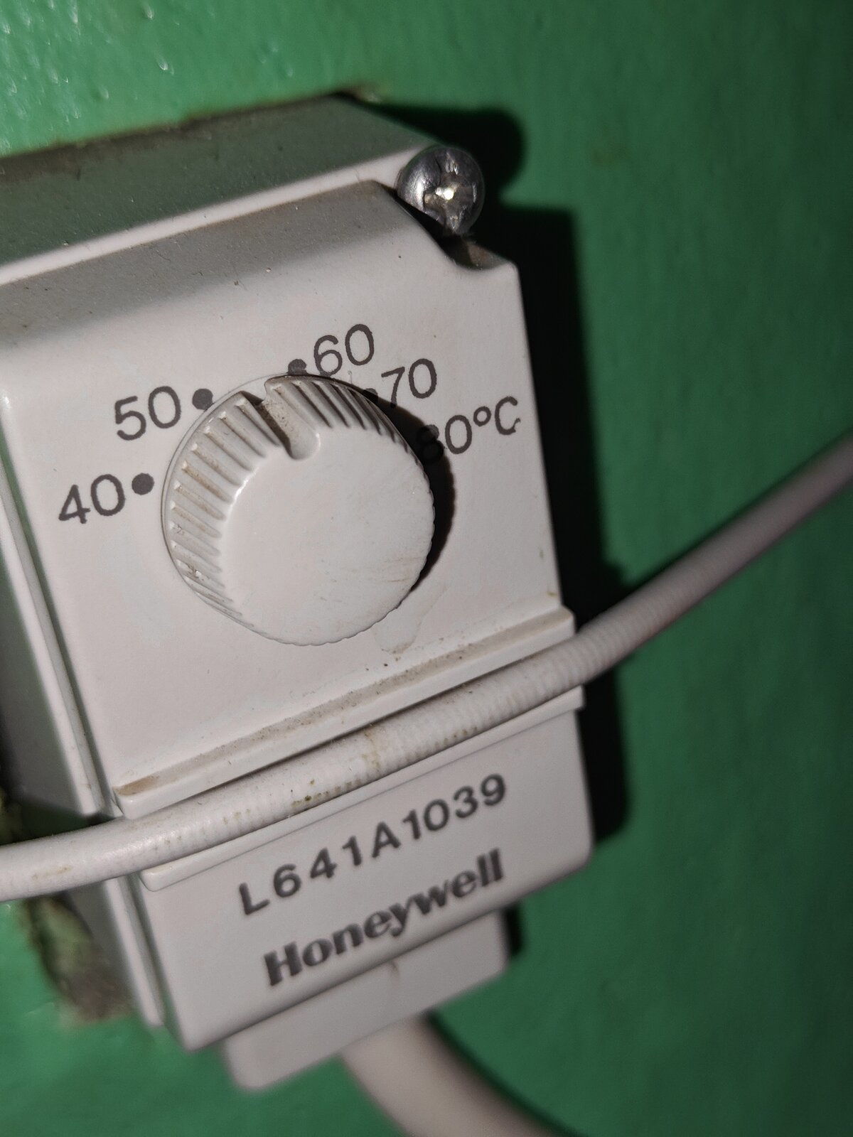

Cylinder is set to 55c at the moment but I have tried 50-60c as well. The flow temperature on the boiler is set to 65c.
The thermostat on the cylinder is quite old style so not sure how can I confirm if water temperature is reached to the desired level in the cylinder. But water in tap is definitely hot.

While the boiler is actually firing can you keep turning the stat down, you should hear a click from the stat and the boiler should shut down.
