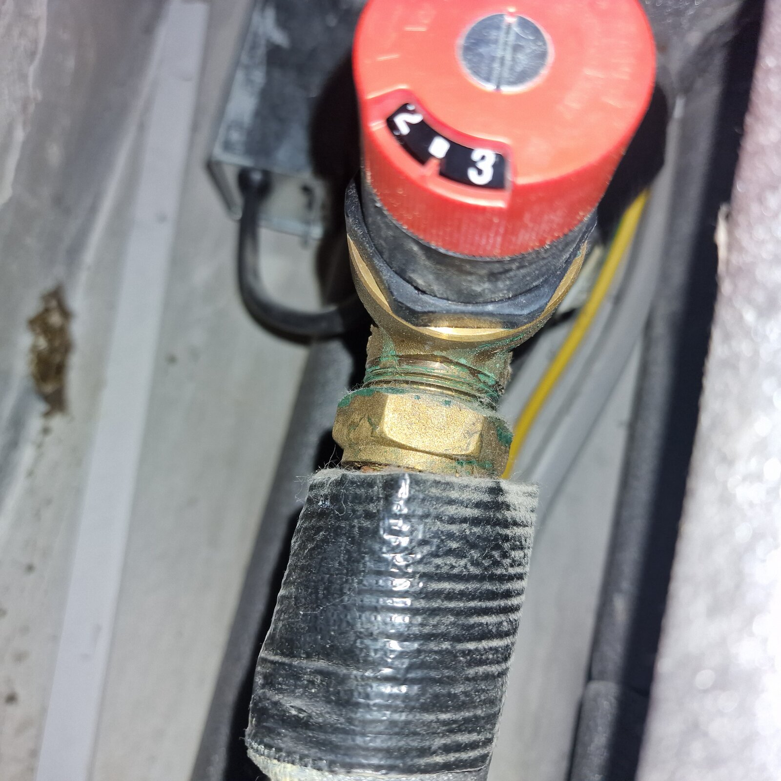

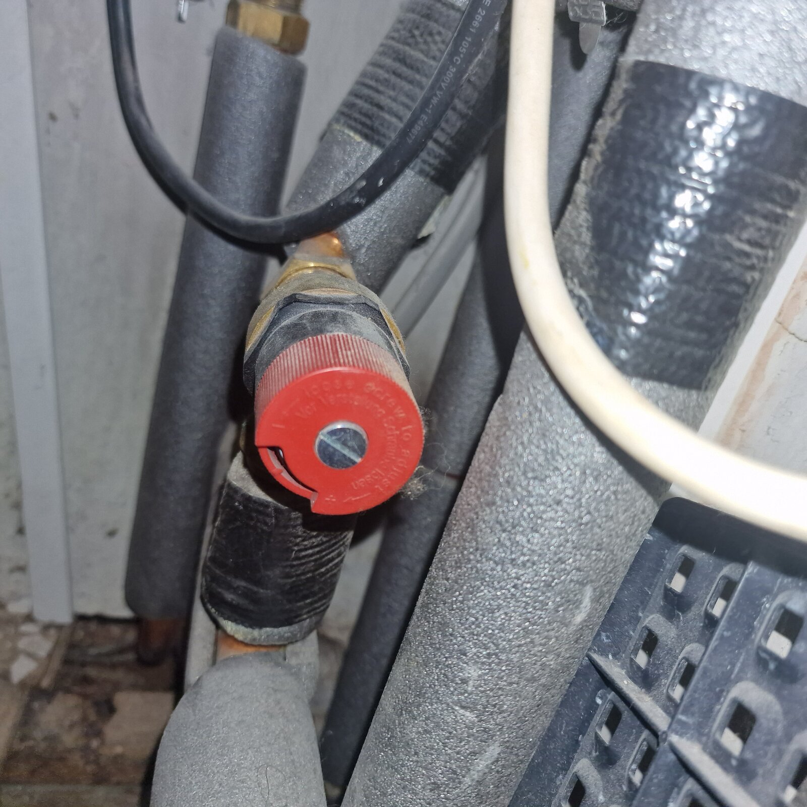

I think you have a external ABV (automatic bypass valve) as well, ( or else its pressure relief valve), can you see what its set to, thers a index on the side/end.
Hi the boiler won't fire with just ch on, it states s30 on display, only fires when HW is on. Do you want me to put on both ch and hw? The red valve in pic is I think is a pressure release valve, It has a + and - and says screw to adjust? Or do u mean the dial on the cylinder?

Whats written on the end of that red valve?.
It just says screw to adjust and an arrow to right with a plus sign. I'll put ch and hw on continuous and take another d40/41 reading in 15 mins
That is a ABV, if you look at the side of the cut away portion on the end you will see a number.
Ok I've checked valve.cant really tell

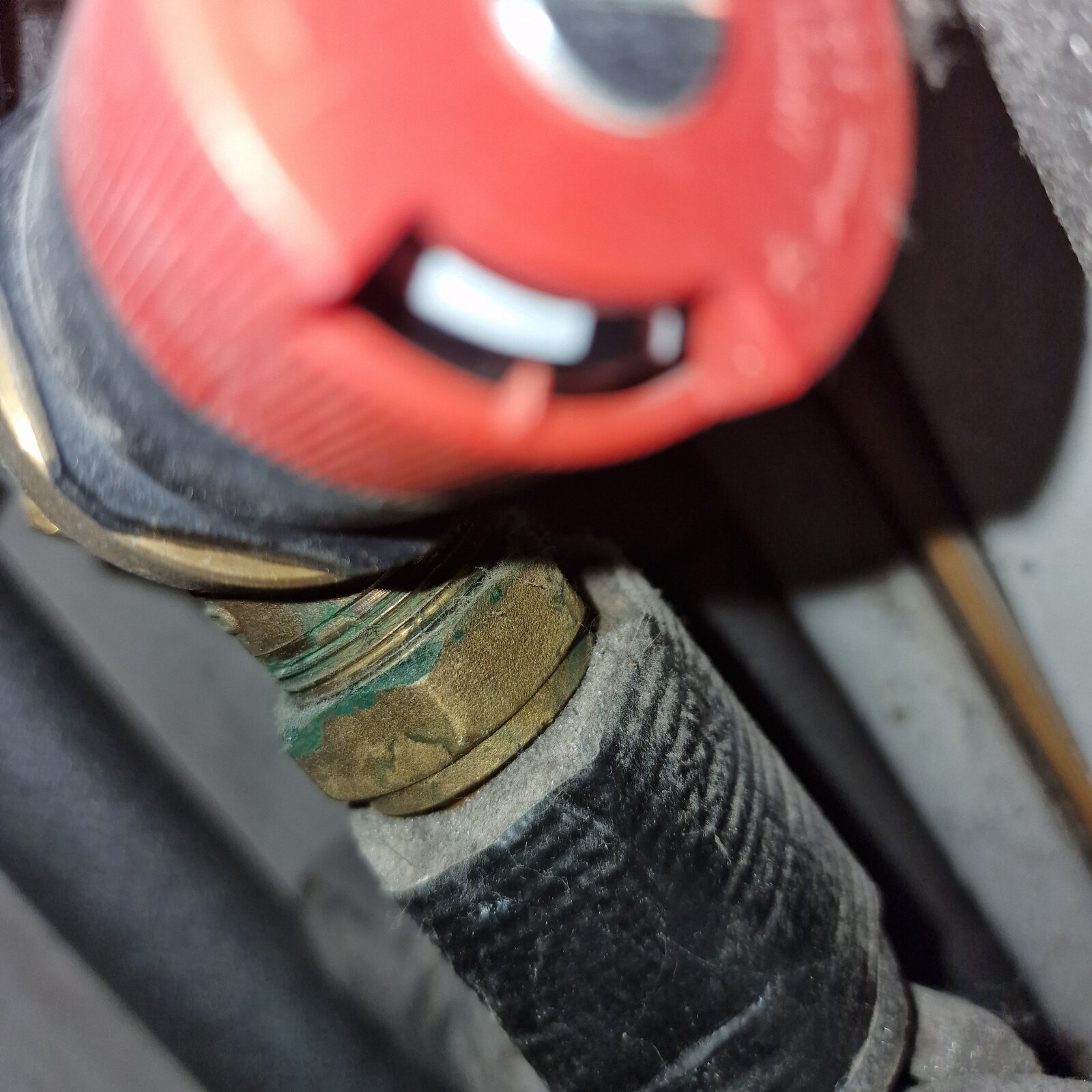

To the right of the red needle bit it says 1

6 full turns takes it to this

OK, keep turning and count the number of turns to set it from 2.5 to 3.5.
