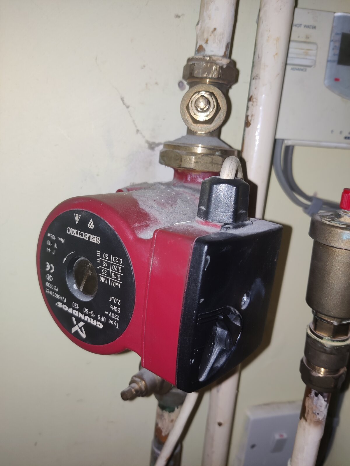

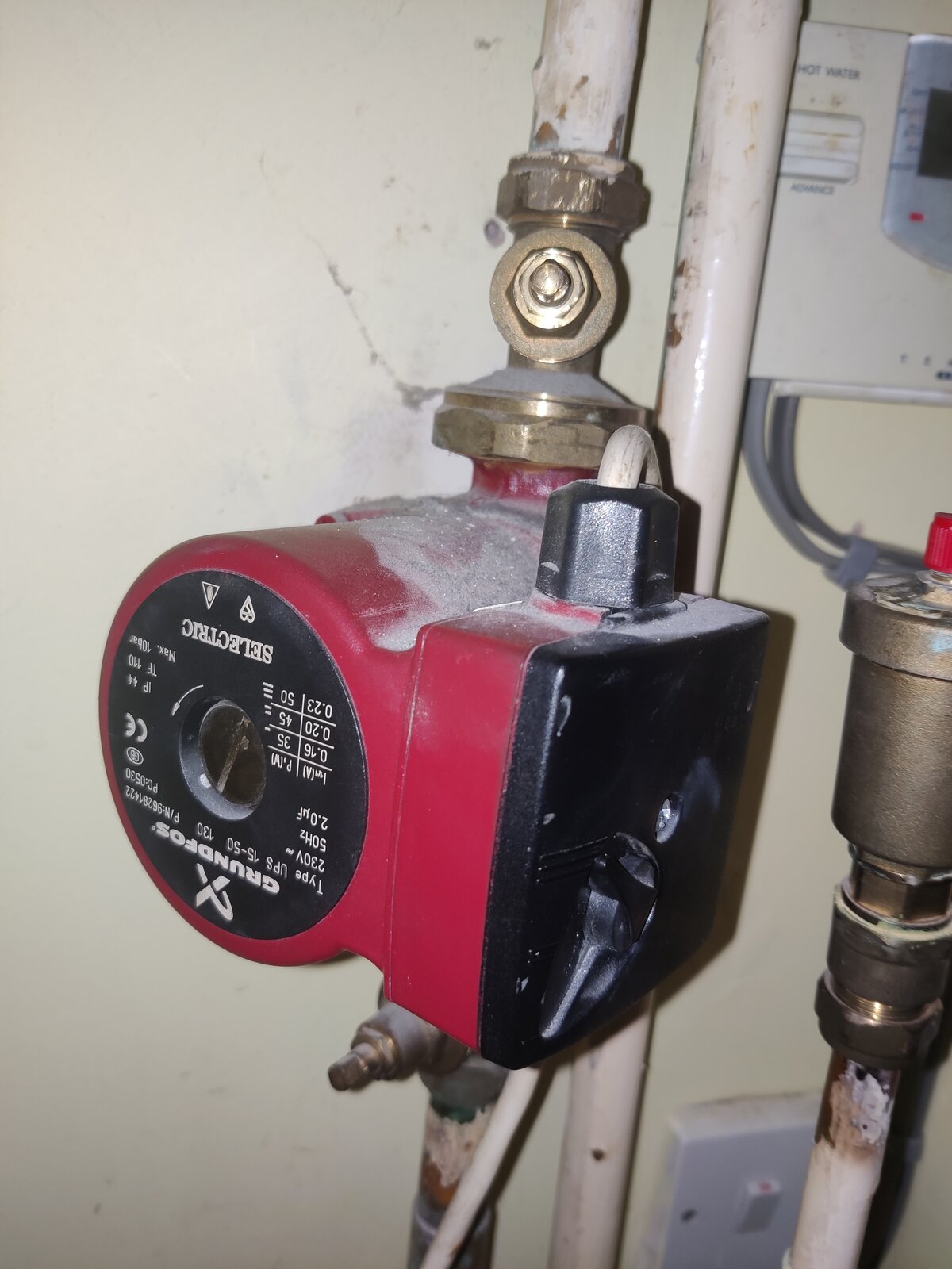

Can you hear the pump running? You can check it by unscrewing a (usually chromed) plug at the end of the shaft with a large-ish flat screwdriver. The same screwdriver can then be inserted, to try to turn the pump shaft. Pumps left unused for a while sometimes seize, that should free it. Expect a small amount of water to escape, as the plug is removed.

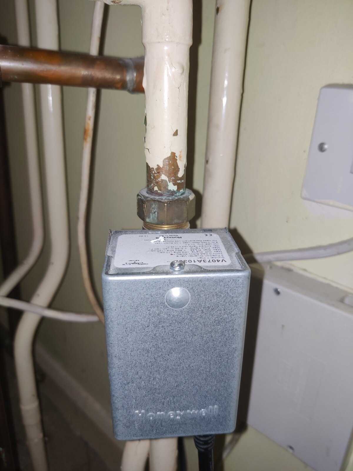

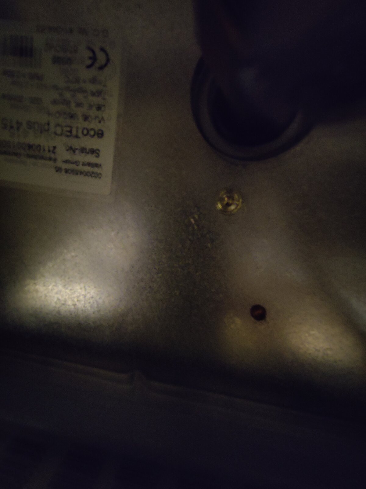

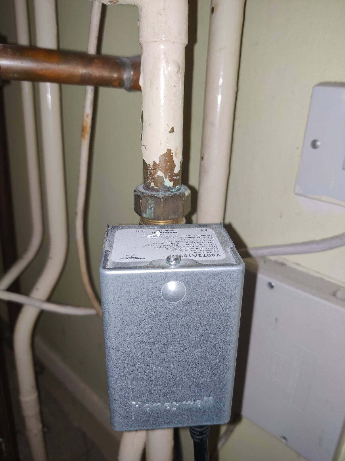

I have this 2 in the cupboard upstairs where is also the tank, on the boiler i don.t see anything under, is just a chrome.plate covering everything as in first picture. I don.t here anything it is just a small whoosh.

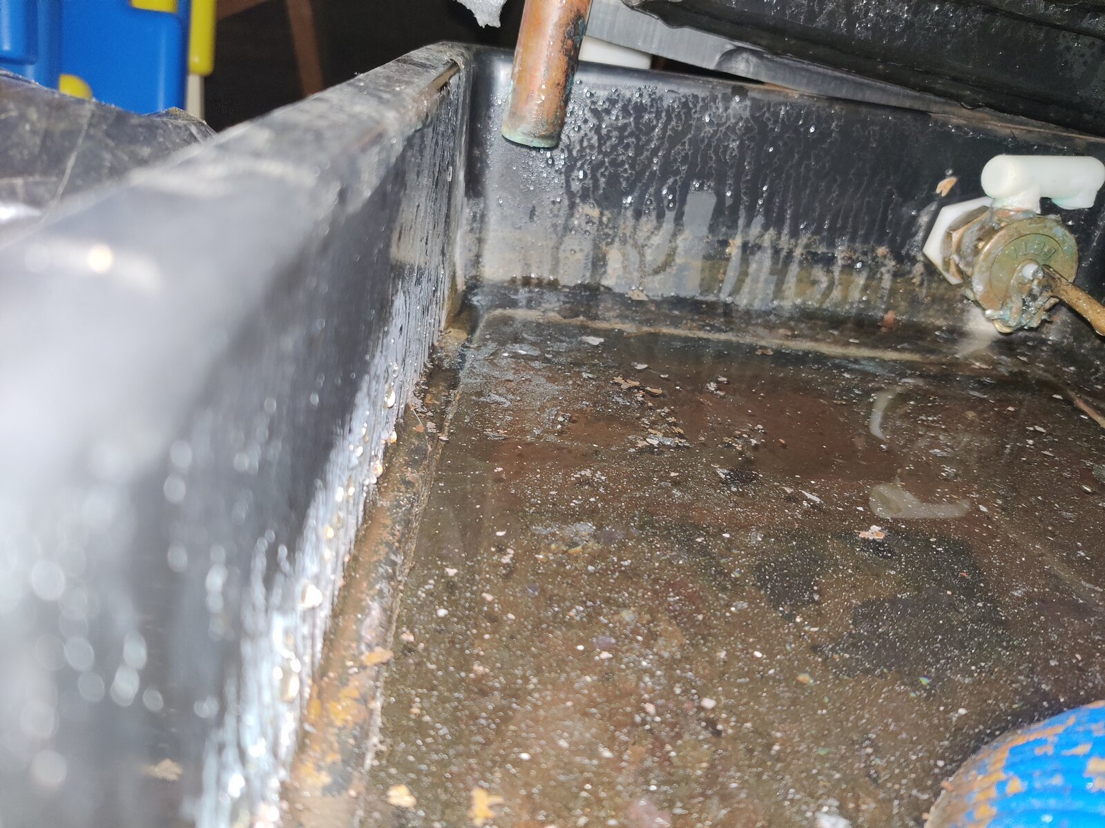

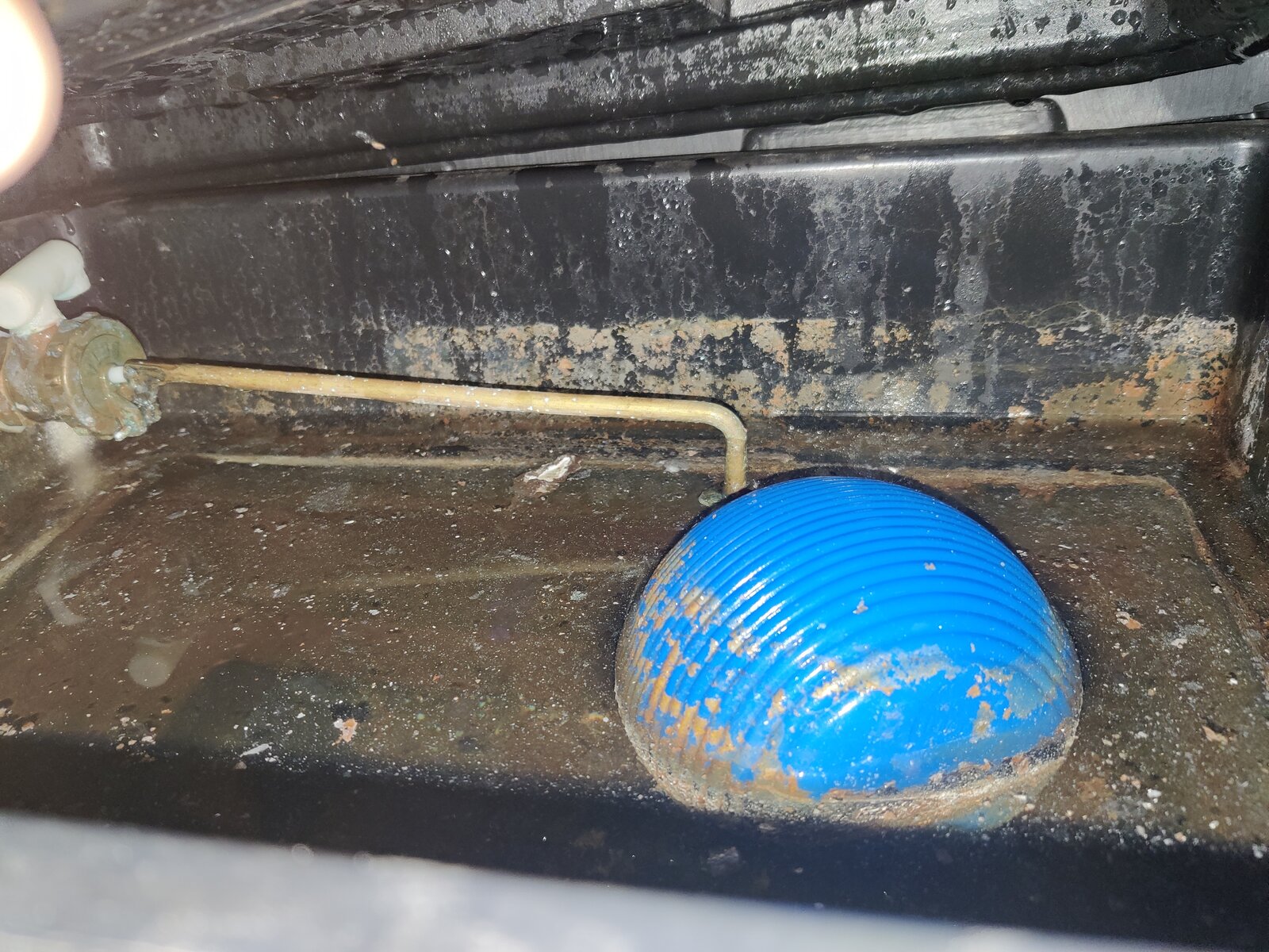

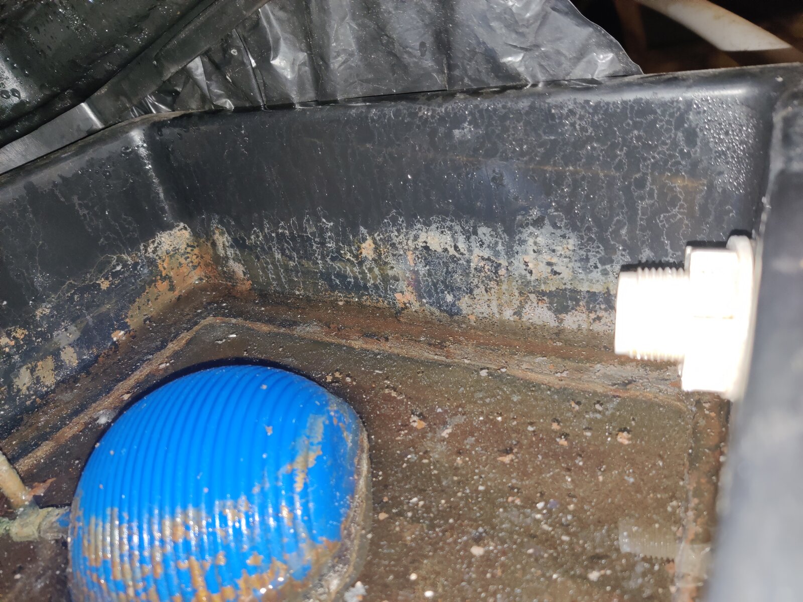

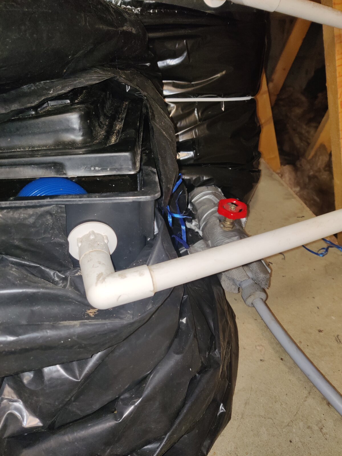

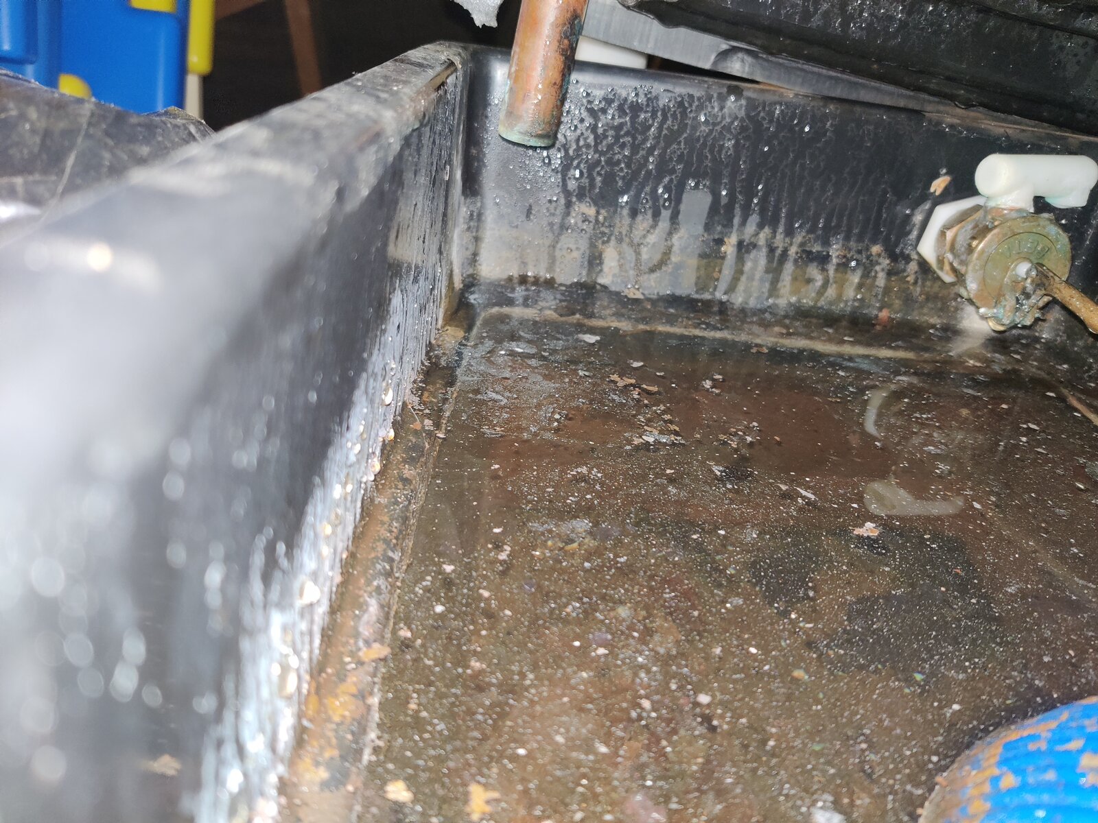

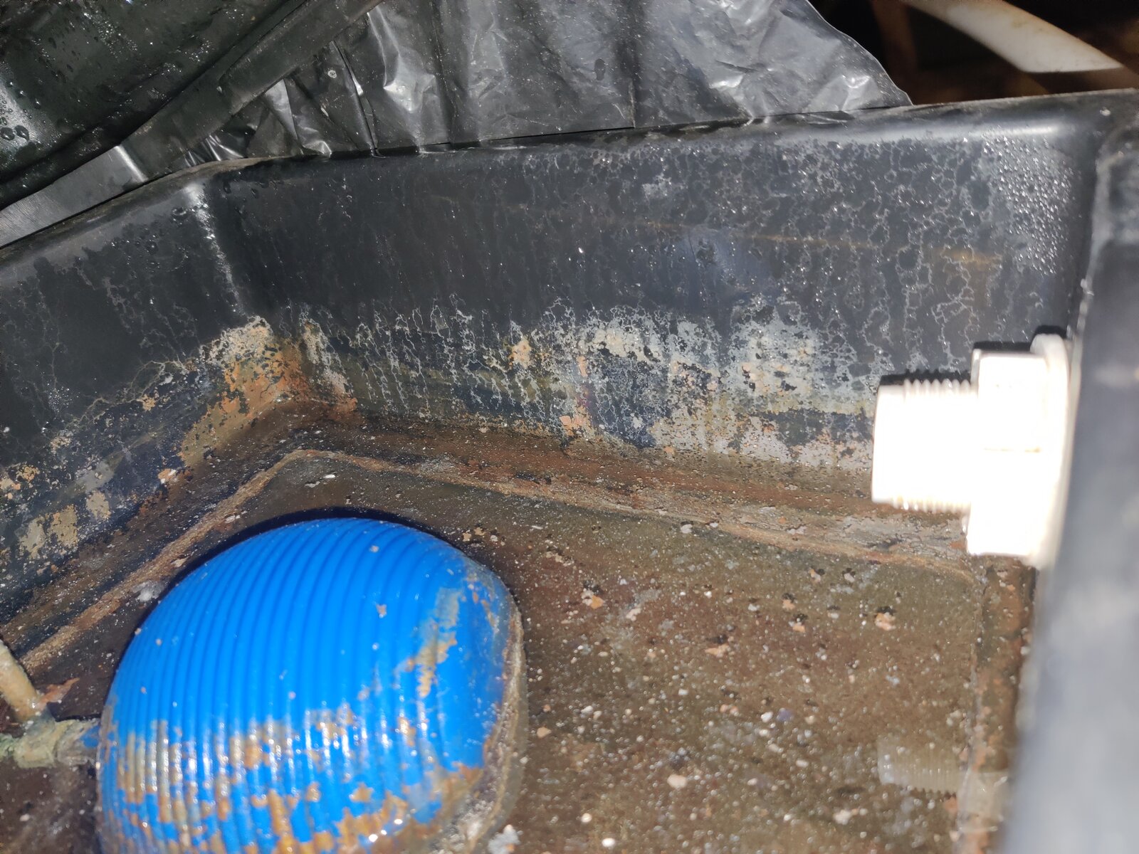

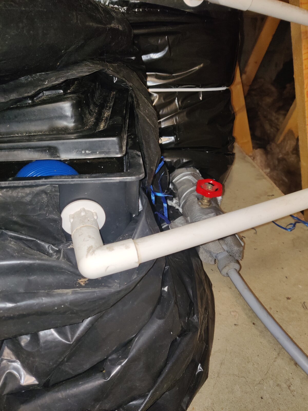

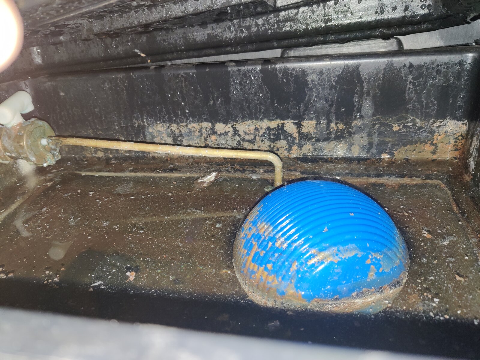

It's an open vented system, so you should not need to top up the pressure. It has an F&E tank somewhere high up, probably in the loft, which maintains the water fill in the system. Likely you will have two tanks, a quite large one, then the much smaller F&E tank. Check the F&E tank has several inches of water in it. It should be filled by a float valve, press the float down, water should flow in to top the tank up.
Your second photo shows a valve actuator, your third one shows the pump, with the chromed plug covering the motors shaft - which I mentioned earlier and suggested you ensure that is rotating.
Yes that is correct, just tested the heating tank and is full of water, pressed the ball and let.s more water in.
