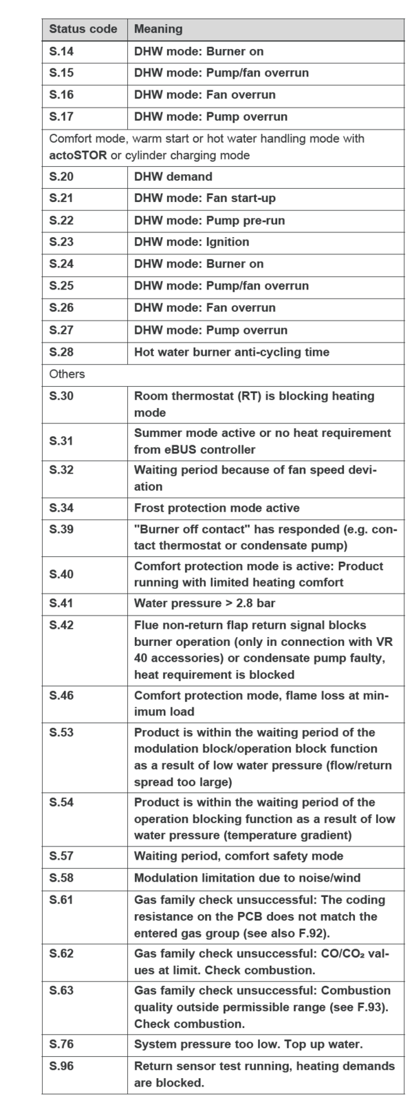

Page 44 onwards in the MIs.
You should find your boiler here.

I've checked for any s codes but only code I see saying burner on.
