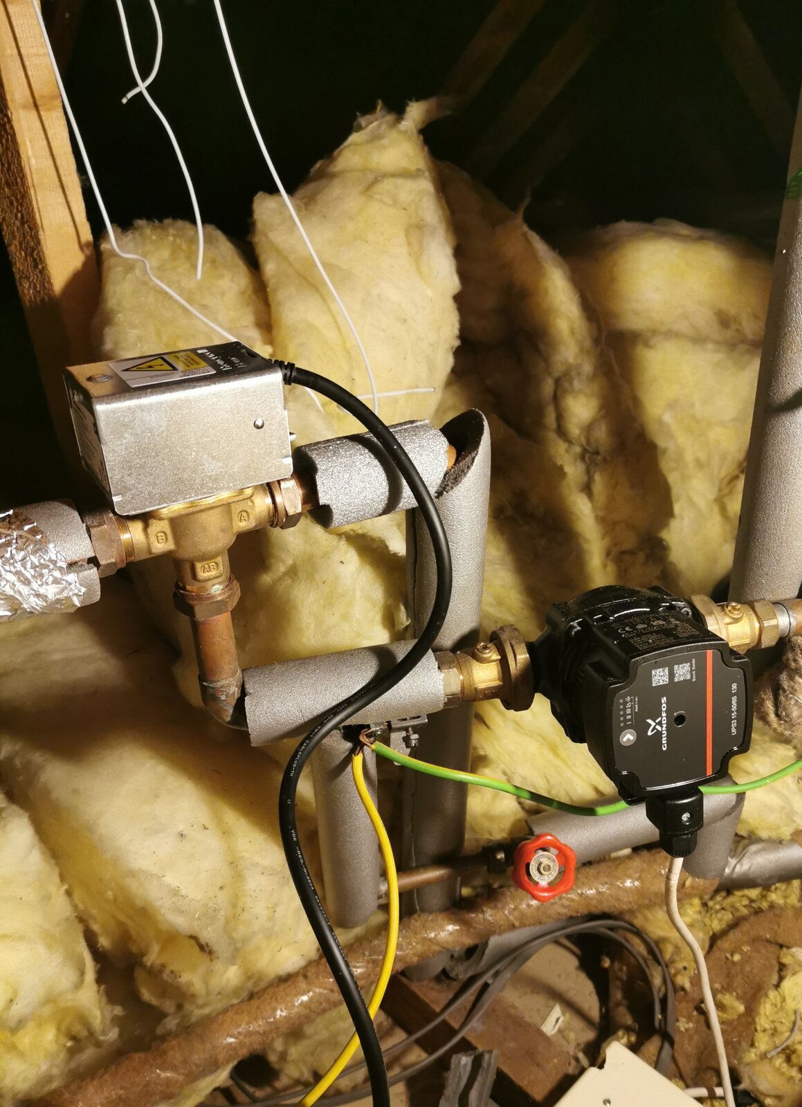

It does this
And at other times when heating has been off, it will do this to get up to temp

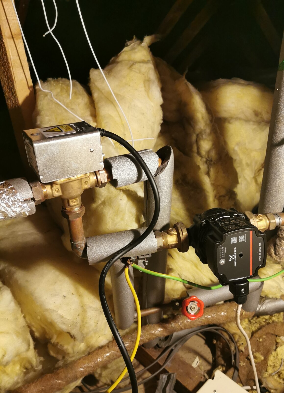

Is it doing that (first video) with the CH only programmed on and the roomstat calling for heat?, have the rads got TRVs?, can you post a picture of the 3 port valve and pump if close to it.
Watching that again, looks like no circulation through the boiler as the temperature rose from 36C to 70C in ~ 19 secs.
Yes rads have TRV
If all the rads have TRVs then reopen that bypass. Is this only occurring since you shut the bypass?
