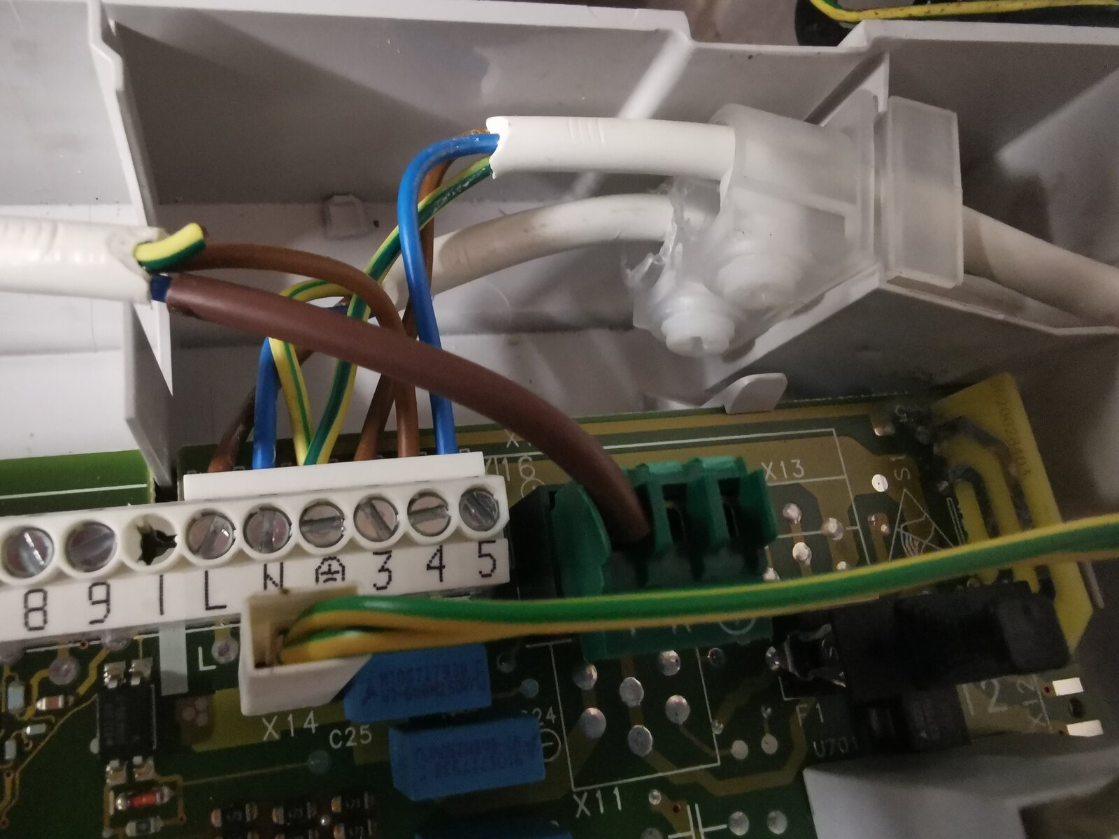

Which terminal are you probing for the switched live?, your schematic is showing a brown wire in both terminal 3 & terminal 4.
On some boilers, the boiler circ pump is started first, then when a slight rise in head is detected the burner fires up so not sure what the implications, if any, on your system.

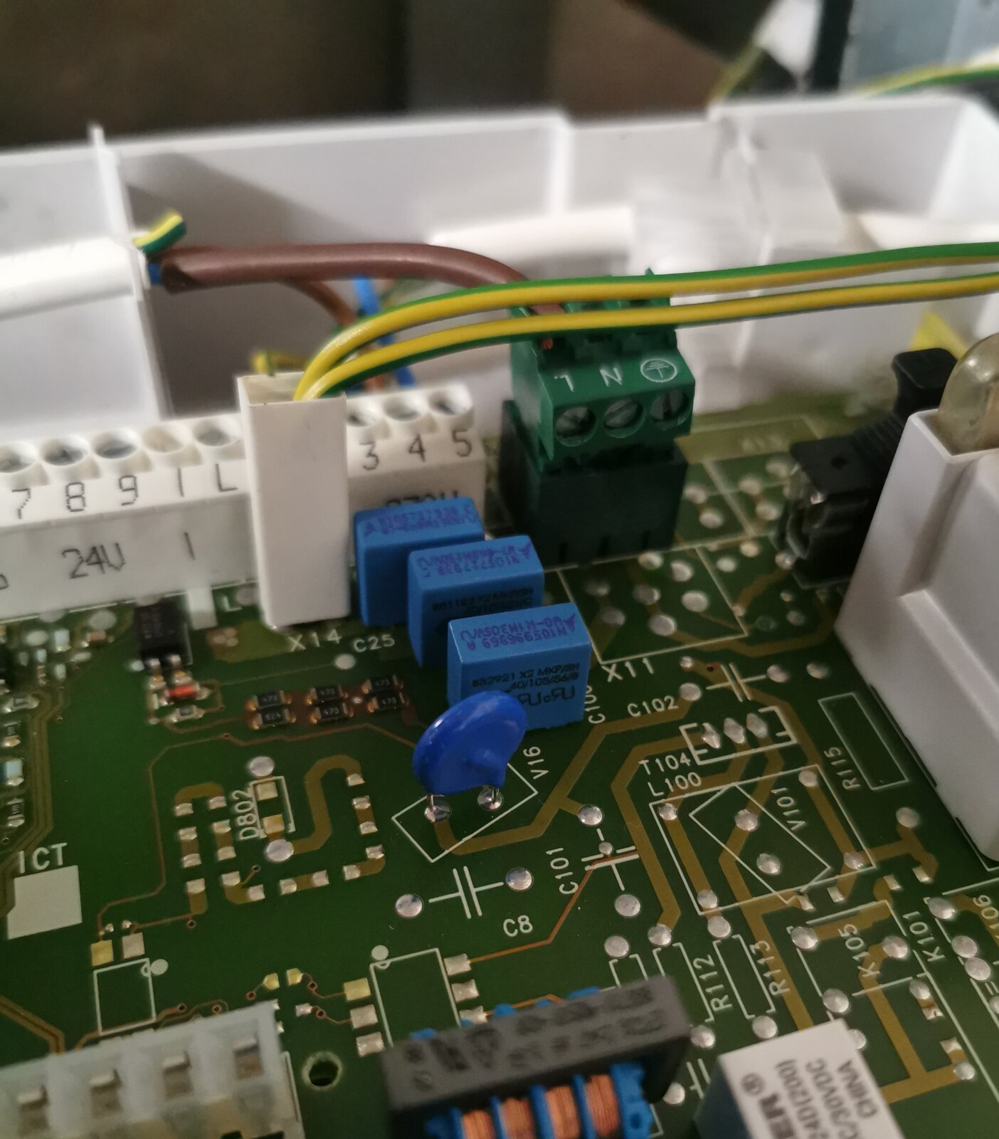

I'm probing the sleeved brown going into the green block. It's hard to see in the pic but it does have a brown sleeve on the blue indicating it's a switched live.
3 and 4 brown wires - ones going into the 3 port valve and the other into the programmer.
One might think that the "programmer one" would be from the programmer and thus the switched live?.

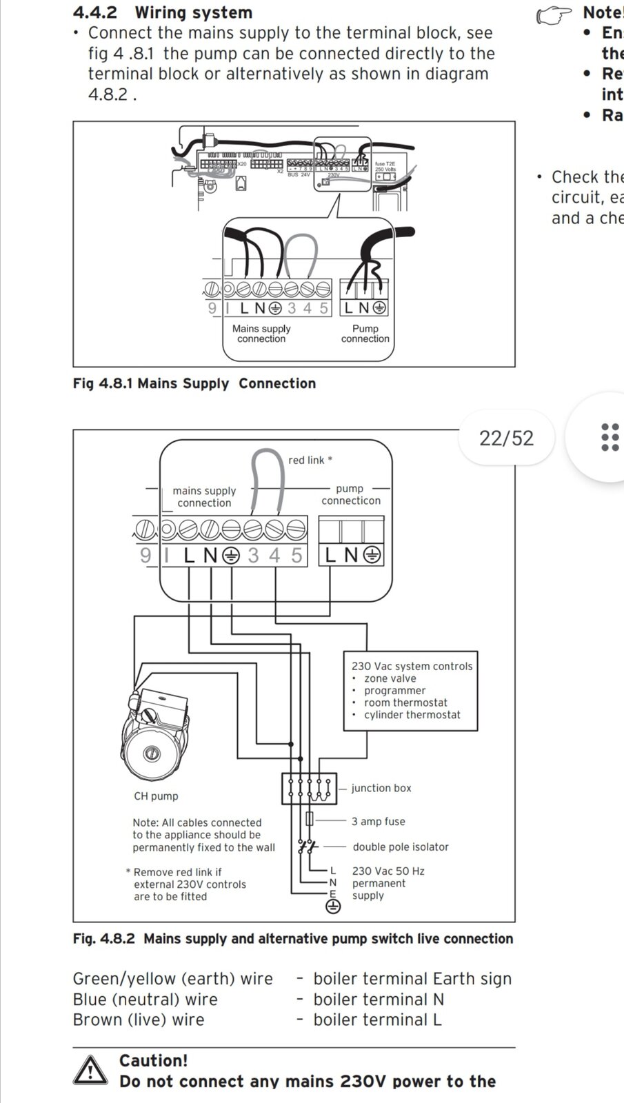

Is that the same as what the manual suggests here between 3 and 4? Or would you mean from L to 3?
