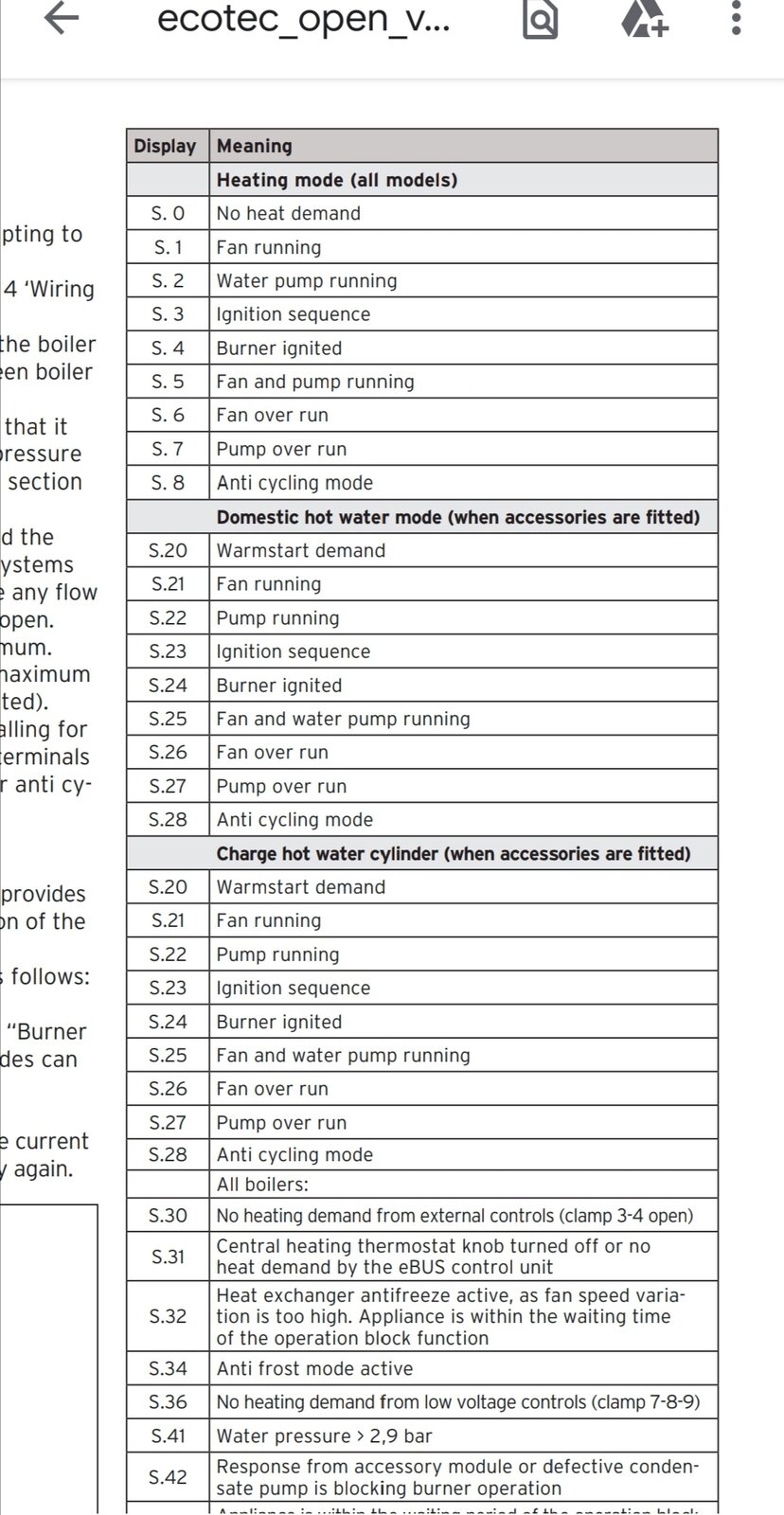

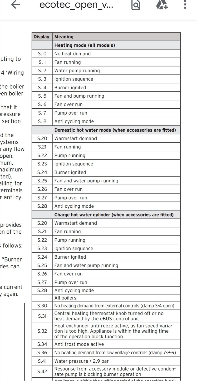

But that should disappear when the boiler is actually firing and a load of other status parameters appear if you scroll up/down, these are not fault codes.
So what's actually happened here?
Has anything been done or what?
#confused
I meant from before. As the problem is intermittent and with that being the only code...
