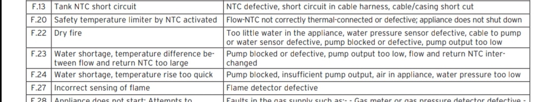

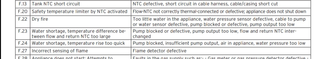

This morning had the f23 code.
It is a new pump, am assuming the code may be due to it being on the lowest setting?

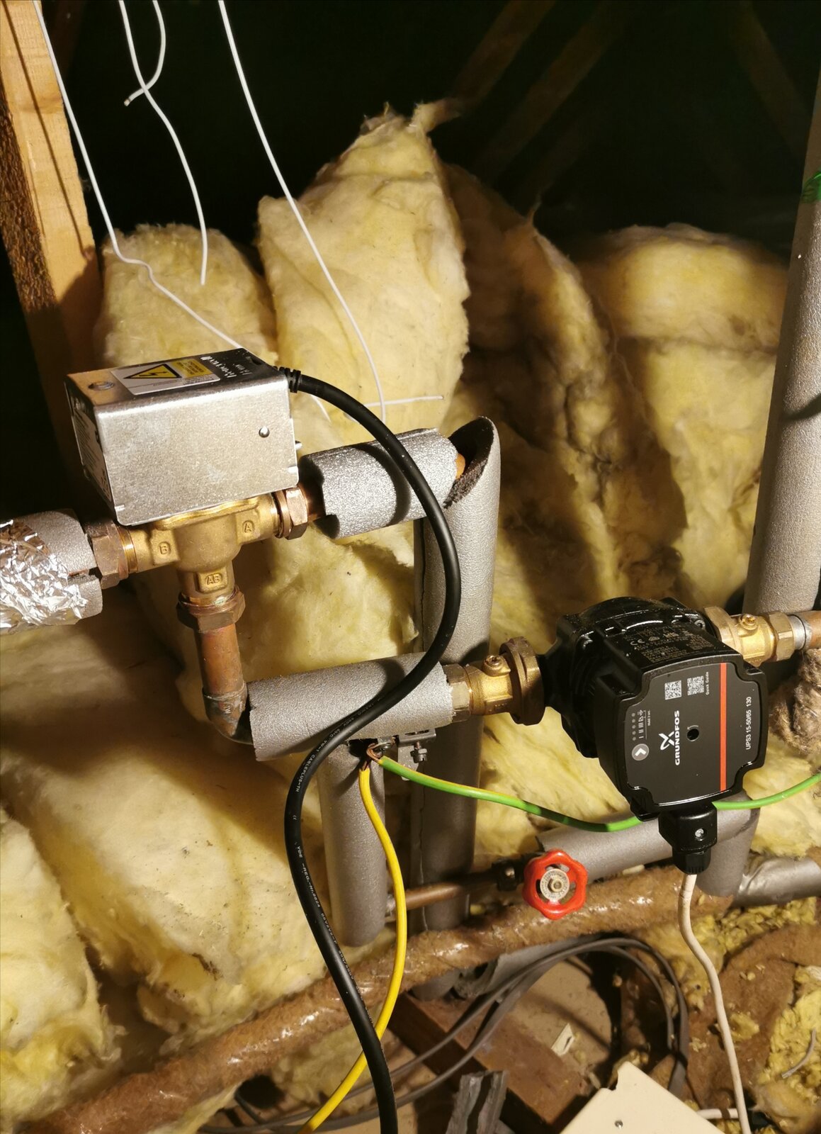

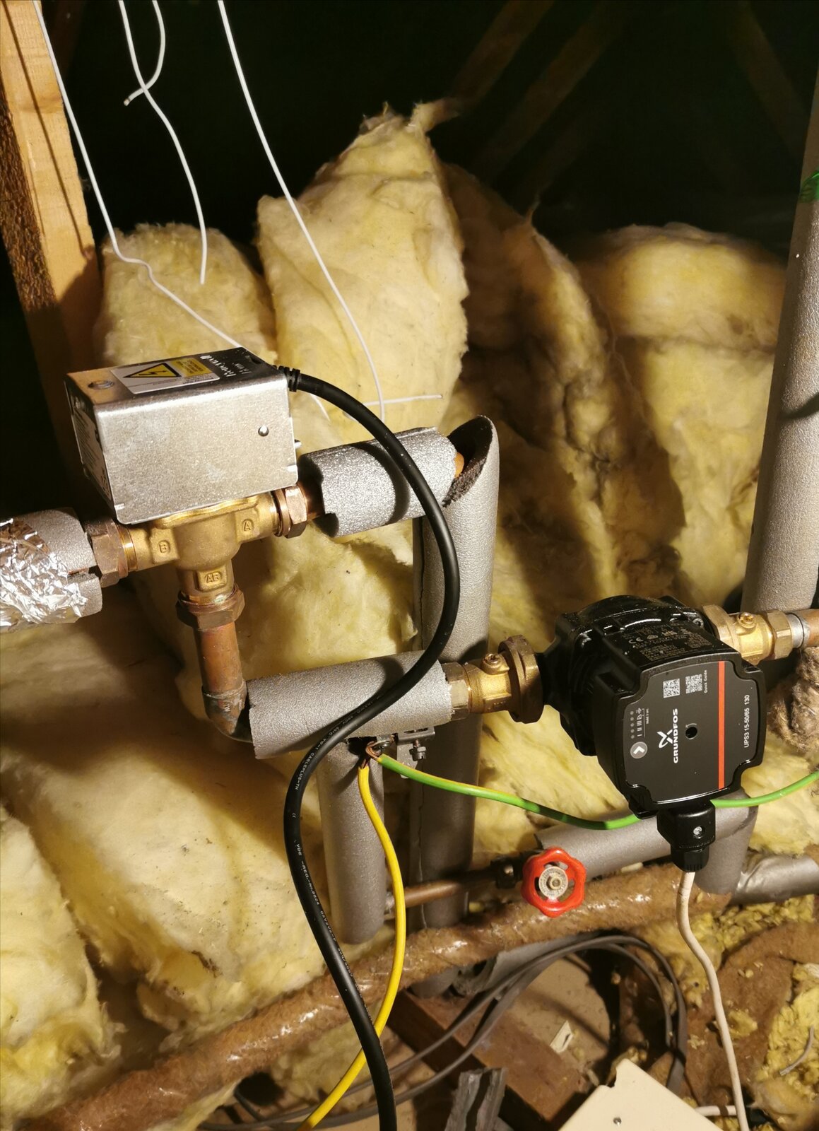

Why is a manual bypass needed or installed? it's a Y plan.
You renewed the pump very recently what make/model? UPS3?
The UPS3 even set to speed1 (4.2M) still circulates up to 12.5LPM at this head, 16.67LPM at a 3.6M head and 21.7LPM at a 3.0M head which should be quite adequate, you can allways change it to constant pressure CP 2 which will pump up to 32.5LPM at a constant 4.5m head but this may cause noise or pump over into the feed and expansion cistern if you have a open vented system.
Where is this manual bypass installed?.
After the pump but before the 3 port valve.
Do these only have a quarter turn to open and shut?
If you mean the brass/bronze valve immediately after (and another before) the pump, these are the pump (suction and discharge) isolating valves and are 1/4 turn ball valves, these should be fully open at all times except when changing out the pump.
The red wheel (gate) valve requires ~ 3 full turns to fully open and the same to shut, if this is currently shut and you try to open it (anticlockwise) then you will feel resistance initially then possibly no resistance for a 1/4 turn so and then moderate resistance while fully opening it. What is it bypassing?, it seems to be teed in just after the pump at one end..... whats at the other end?. Is it open or shut?.
It does look like a bypass between the boiler flow and return, might require say a turn open if you have TRVs installed.
Have you a open vented with a small feed&expansion cistern in the attic or a sealed system with a red expansion vessel somewhere?.
Open vented.
The red gate valve is open, I will have to check where it goes. If this is open I assume there will be less hot water being pushed for heating and hot water.
If its very hot then it is bypassing the water from the boiler flow (via the pump) back into the boiler return, can't really see any need for it with a 3 port valve.
