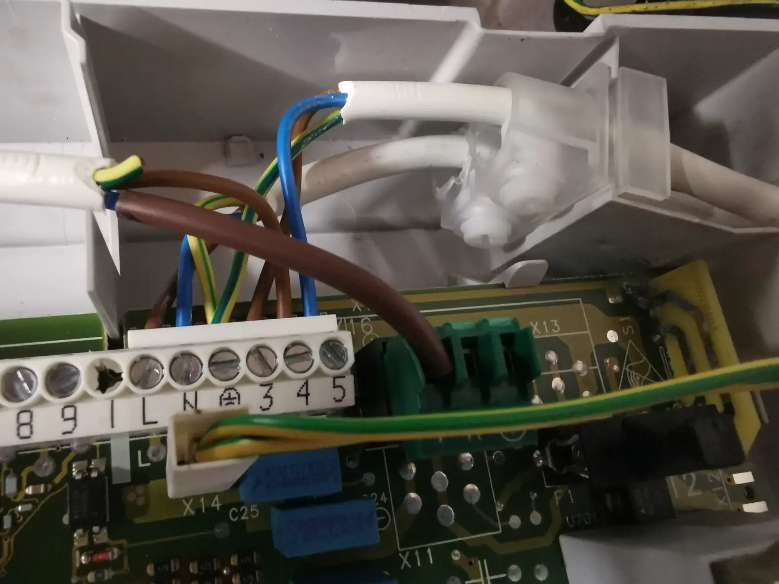

Vaillant ecotec plus 438 no heating or hot water
What is the brown wire in terminal 3 connected to??.

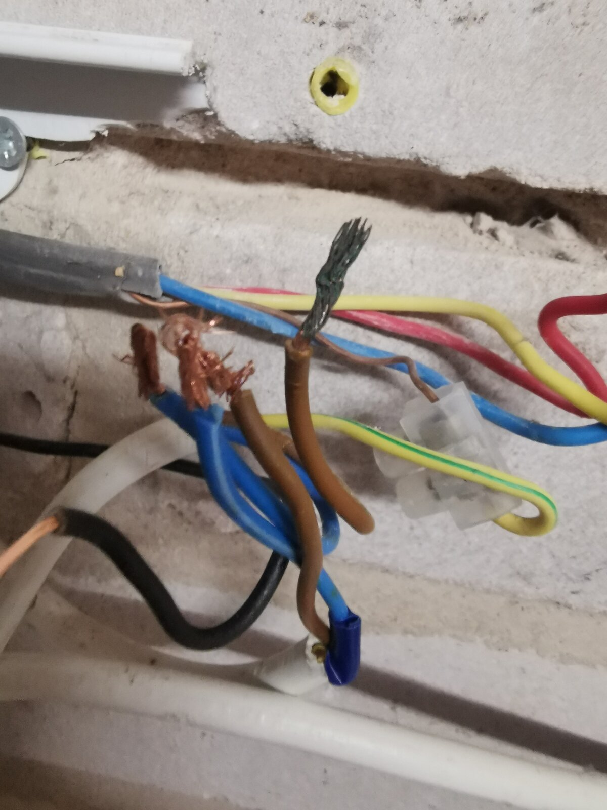

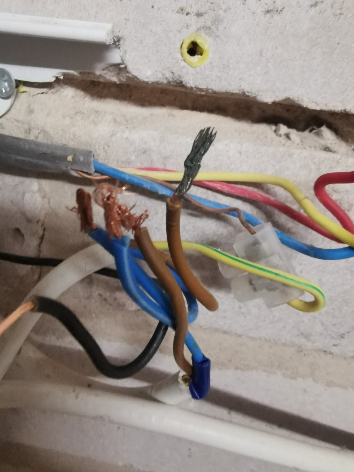

Live at the programmer.
Problem has started again. And the other end of the brown at terminal 3 at the programmer side looked like this... Subsequently I've stripped some fresh copper and the problem is still there. I've checked at terminal 3 and that side was clean copper

Not a very clear photo, but....
That brown would have me wondering why it was like that, what had caused it. Usually, copper becoming discoloured like that, is due to chemical attack, or overloaded. If overloaded, the plastic insulation will usually evidence that, but I'm not seeing that.
I refer you to my previous comment about reconnecting/wiring the system from scratch.
Oh, and look up some electrical terminology techniques.
Yours are awful as is the corrosion.
I see no point in fault chasing any further until you clean that mess up tbh.

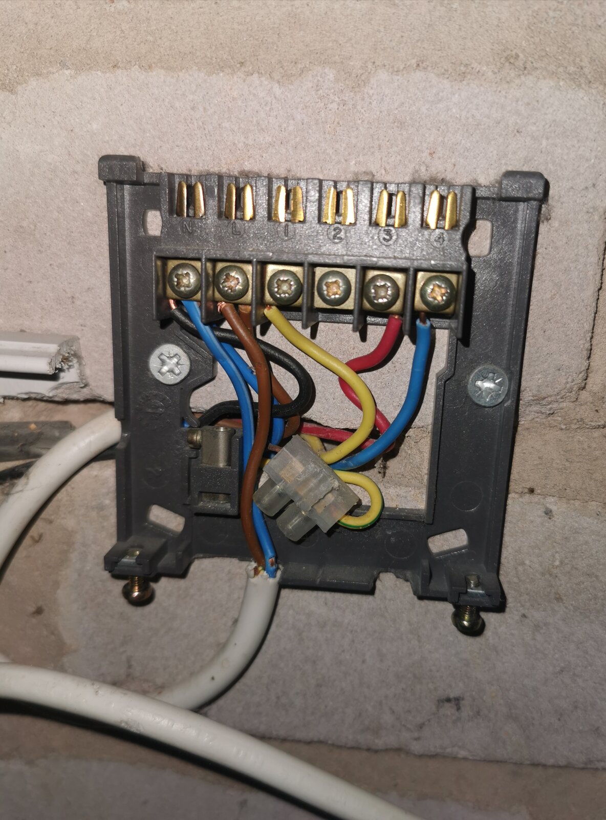

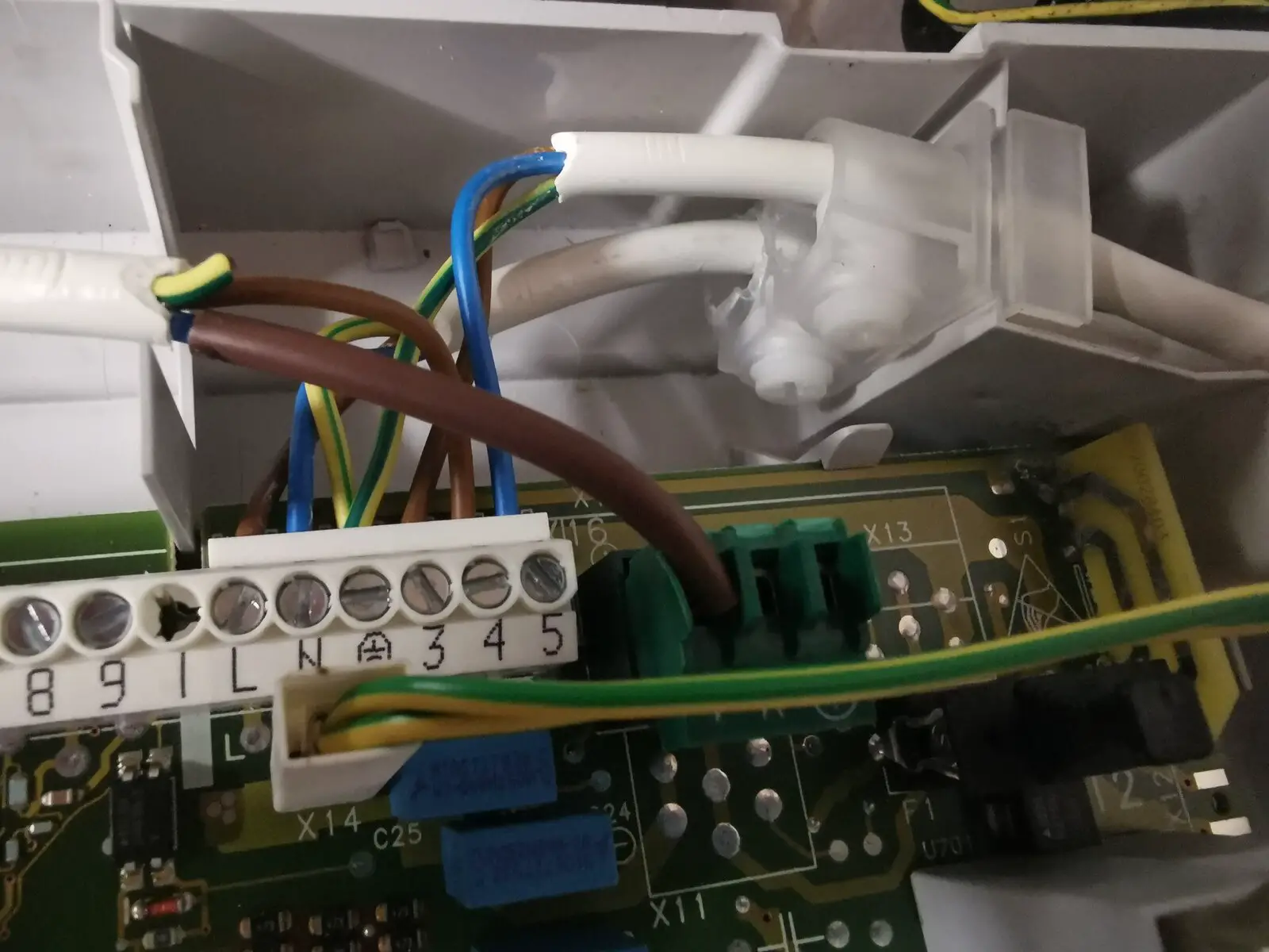

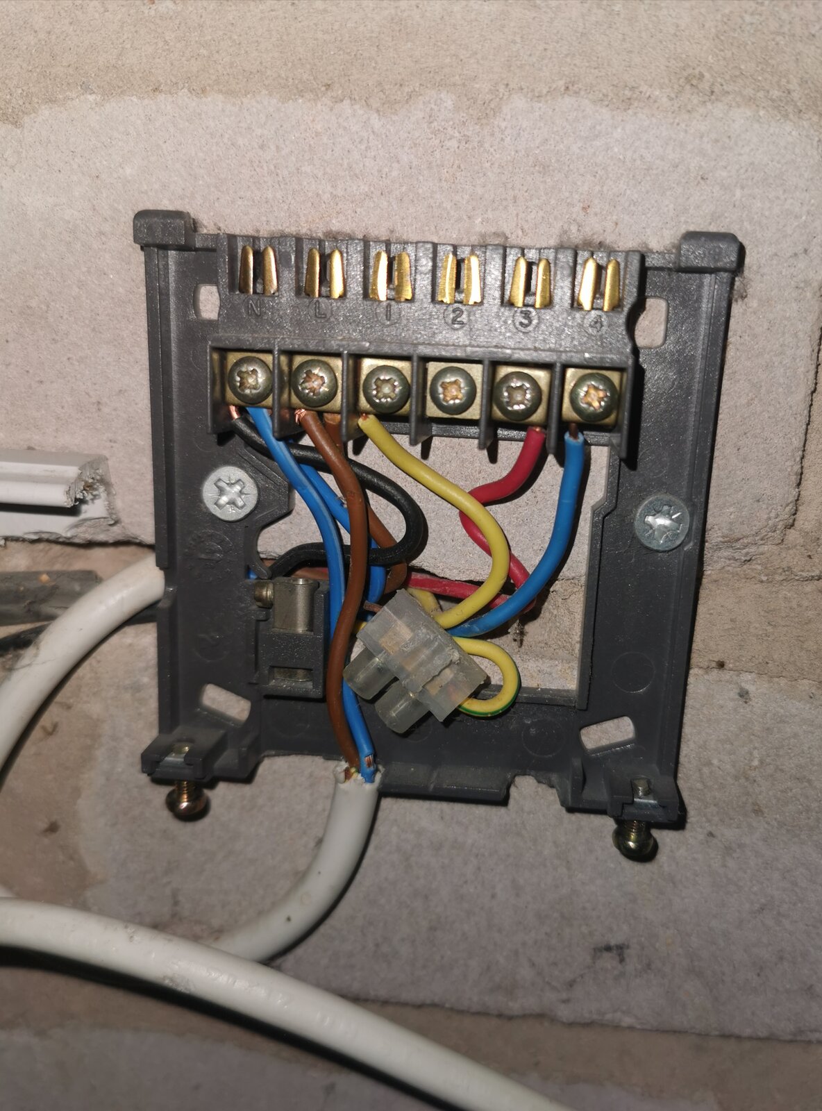

From Terminal 3 on the pcb to the L on the programmer backplate.
I thought the programmer L would be fed directly from the wiring centre so confusing (to me, anyway) why its fed from the PCB terminal 3.
To make it more confusing 2 on the backplate doesn't have a wire
There is bare copper / damaged insulation On the blue wire ,near the bottom cable entry. Needs attention.
Terminal 2 doesn't have or need anything connecting to it on Y plan.
What about terminal 3 on the boiler, is the brown wire not doing anything?
I don't understand?
