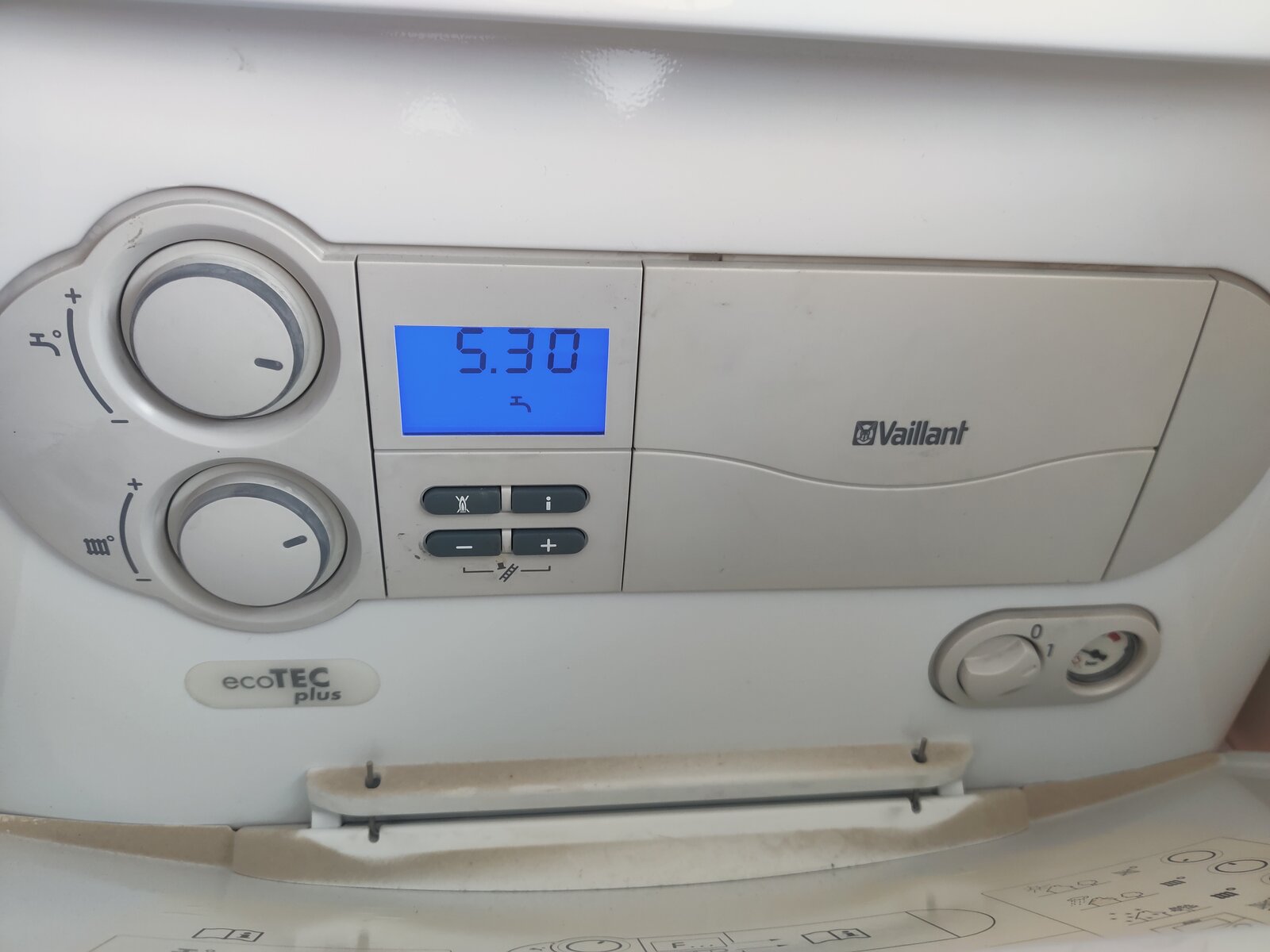

Hi all,
As mentioned in the title my Vaillant Ecotec have s30 status displayed resulting in no hot water . Heating works Ok .
S30 status - no call from external control's.
That problem started after few power cuts in short period of time.
I'm using immersion heater at the moment.
My setup is as follows:
Ecotec plus 612

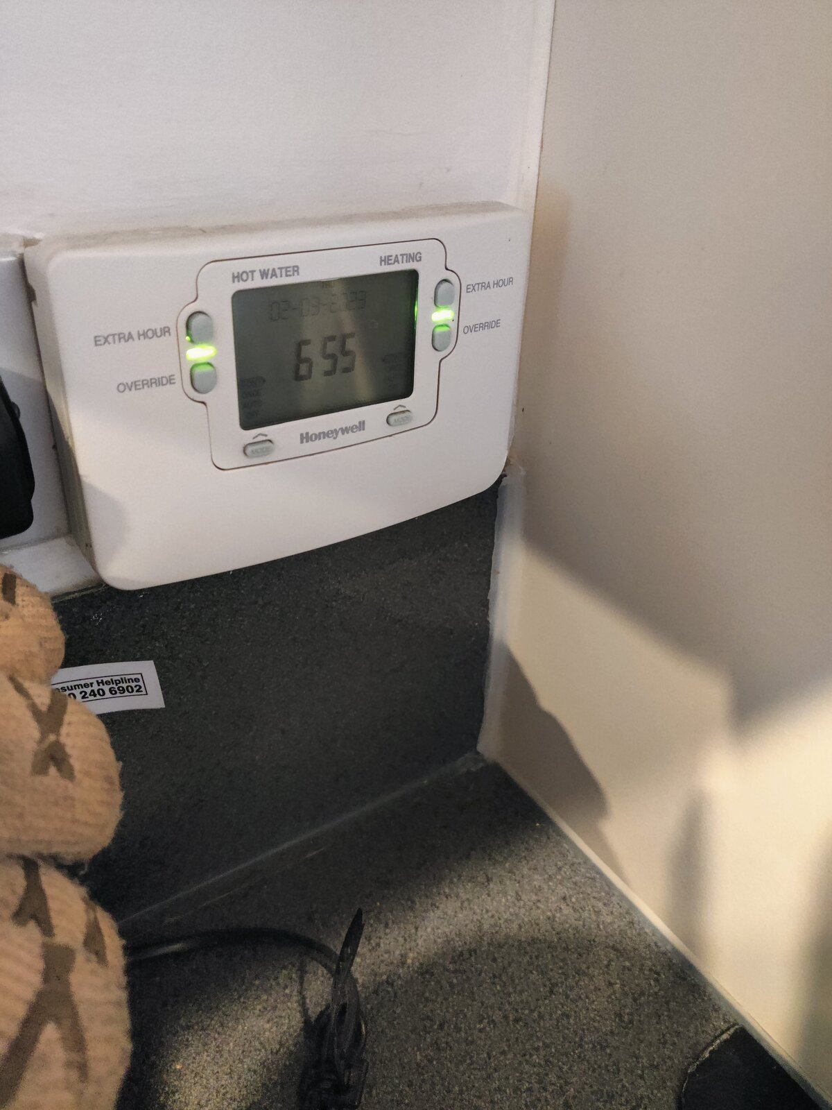

Honeywell sc9400c programmer
Honeywell wall dial thermostat
Unvented megaflow cylinder
Everything wired as 2x2 S plan heating
Checks I've done so far:
1. Put a bridge on 3 and 4 pin - s30 displayed
2.Replace programmer - s30 displayed

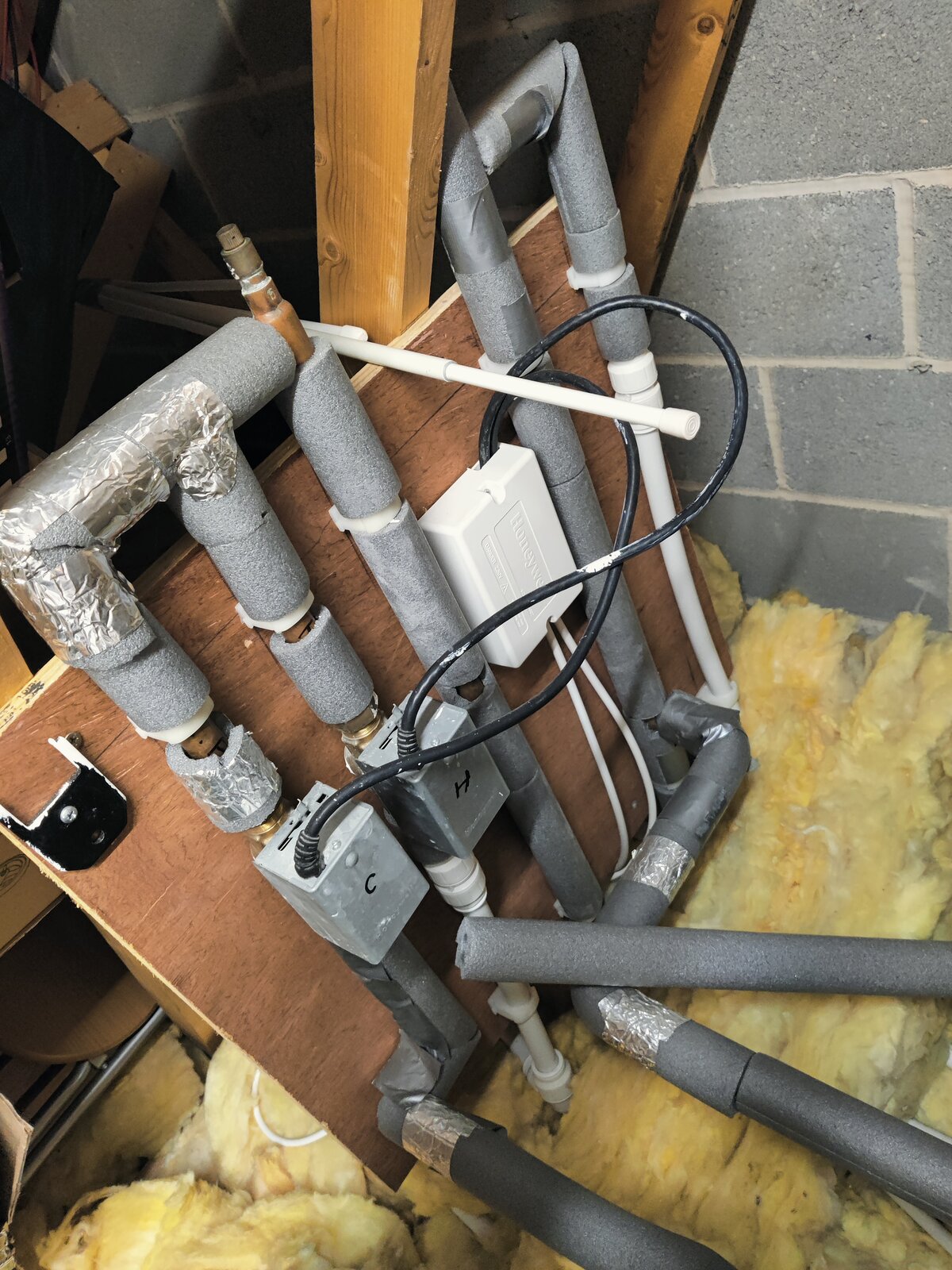

3. Check 2 port valve :
When I push lever I can feel resistance. When flipped to manual position pump still not engaged however when I pressed microswitch inside two port valve boiler (pump) started working but as soon as I stopped pressin microswitch pump stopped working and was s30 displayed.
It looks like two port valve is not energised when I checked all wires
Brown,grey,orange have 240v
3. Water cylinder thermostat is ok . Resistance 20 ohm.
I've tried reset button but no luck .
Any help would be appreciated.

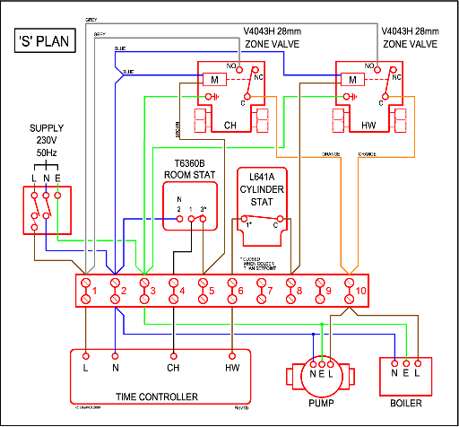

Even with a healthy end switch, opening the valve manually will not close the end switch.
With 2 port deenergised, you should only get 240v between grey& neutral, with 2 port energised (via programmer&cylinderstat) you should get 240V between brown&blue (which should open the valve) and you should then get 240V between orange&neutral, the manual lever will feel loose if the valve has actually opened.

If everything OK then 240V between brown&blue, grey&blue and orange&blue, (0 volts between grey&orange).
Thanks for that. When I come back home I will check again what readings I'm getting.
So if I'm reading 240v on all wires from two port valve is that valve kaput ?
Not exactly....
Assuming it has been wired exactly as per the S plan diagram above, set the HW to on, the cylinder stat to max (with the water inside cool). Then connect one probe of your meter to terminal 2 which is neutral, of the 10 way terminal block... That becomes your reference point, for all of your measurements.
Then in turn check terminals 6, then 8 both should show 240v - report back if they do not.
If they test out OK, that valve actuator motor, should be under power and attempting to open the valve.. If not, then the motor has failed..
Just come back home and this are the results of my test:
brown&blue, 240v
grey&blue 240v
orange&blue 13v
grey&orange is 210v
went ahead and replaced two port valve and we have Hot water back again !!!
So to summarize Vaillant Ecotec plus 612 displaying S30 status resulting in no hot water , heating working ok.
Replaced faulty two port valve sorted the problem.
