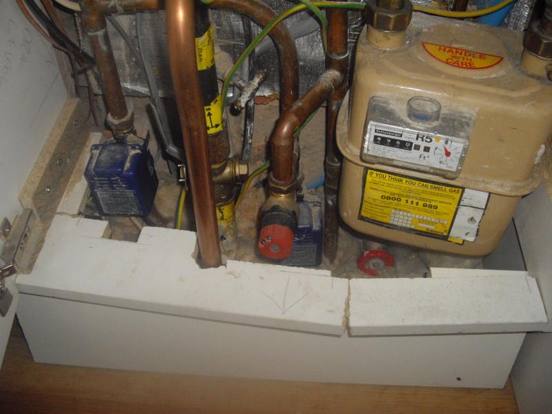

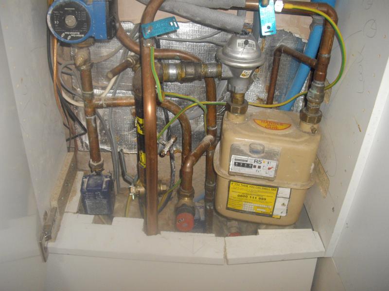

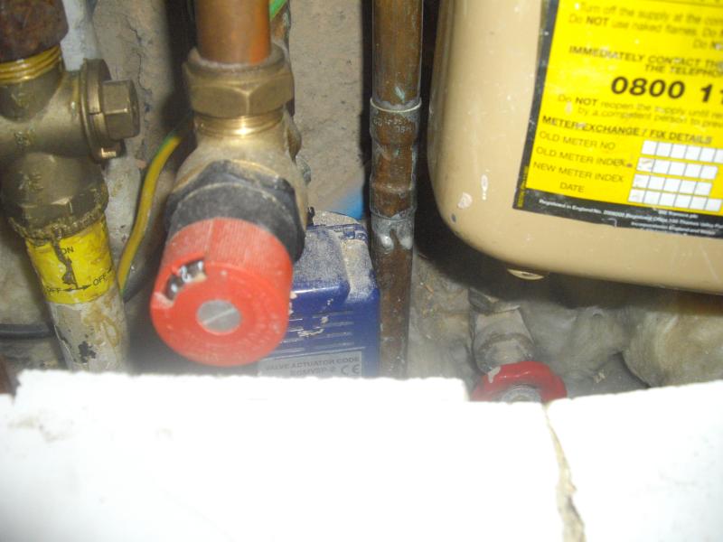

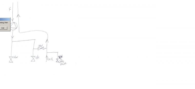

Did you take any other photo's of the pipework? The zoomed in one is okay if accompanied by some zoomed out photo's (of the valve area and megaflo). What pipe is the "gate valve" (under meter) on and is it open/closed? What were your conclusions of looking inside the tank? (it's difficult to see anything on the photo's your've posted.)

Did you take any other photo's of the pipework? The zoomed in one is okay if accompanied by some zoomed out photo's (of the valve area and megaflow). What pipe is the "gate valve" (under meter) on and is it open/closed? What were your conclusions of looking inside the tank? (it's difficult to see anything on the photo's your've posted.)[/quote]
Megaflo only got the flow and returns and obviously inlet and saftey valves. Gate valve is on the return from the HW and is open by around 10 turns. No serious scale on the coil (although not totally bright steel anymore) within the megaflo attached is a sketch of the layout of the pipework.

Got some more photos off the camera of the pipework
