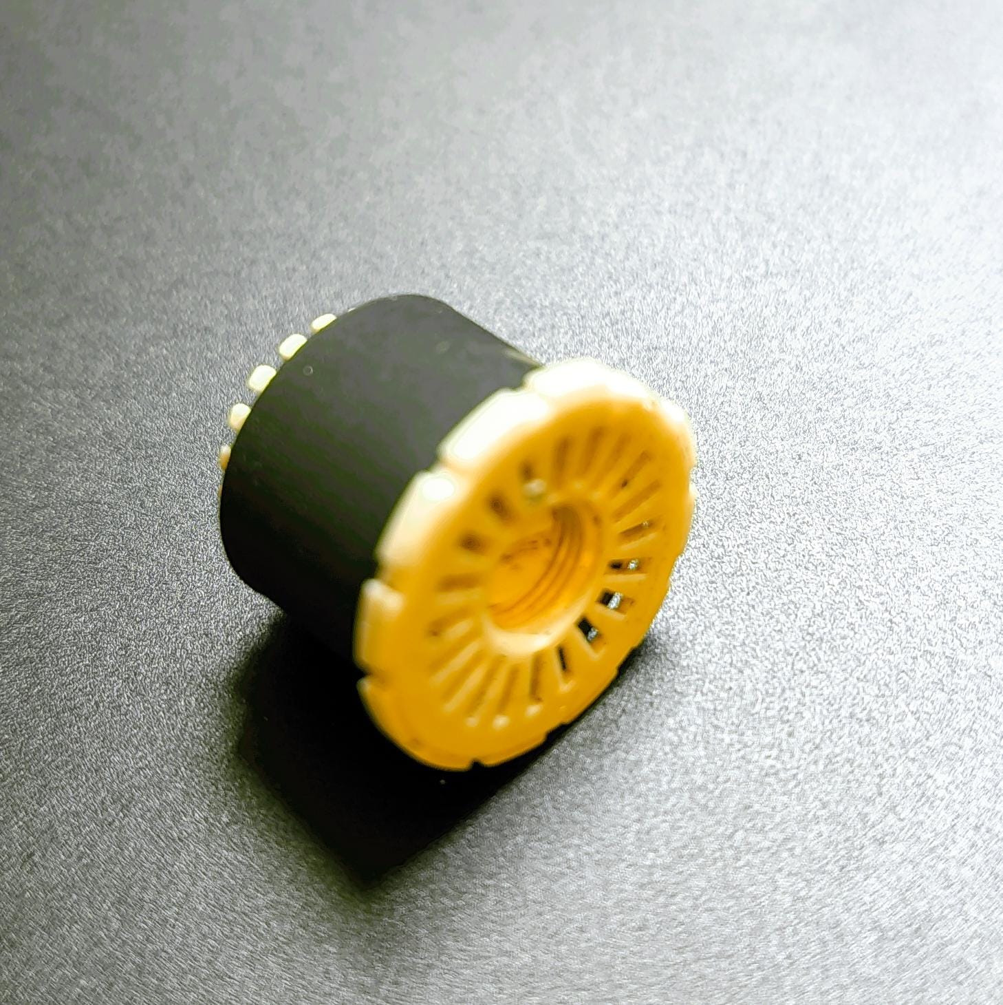

The restrictor was an original fit. Probably the type with a tiny rubber O ring. That will probably be well perished by now if it hasn't been replaced. It's supposed to restrict the max flow so you still get the specified temperature rise and flow rate as is in the spec.

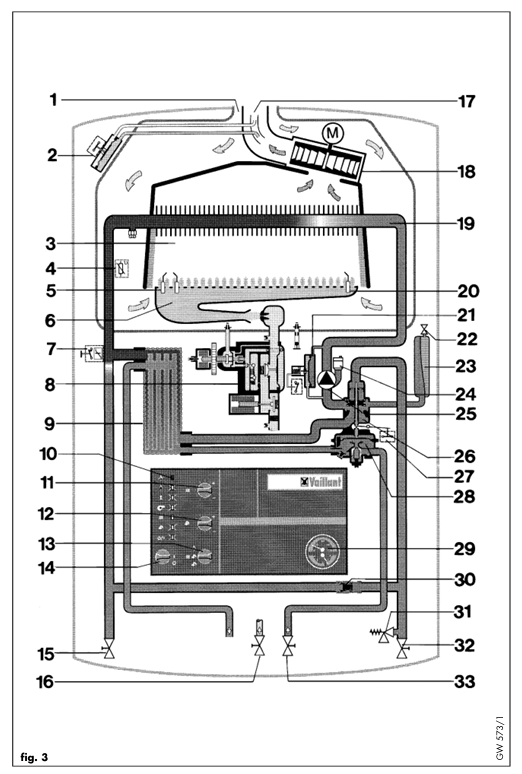

There is a bypass valve. I don't know how it's connected and hence whether it could cause a problem on HW if it's letting by. Easy to check.
This is a pic of the restrictor - there is a bit more plastic inside the fitting and it could easily go back (but note that this problem was happening prior to me removing it). The rubber part is actually fine.

The bypass valve (30 on diagram) doesn't look like it would cause this problem does it?
