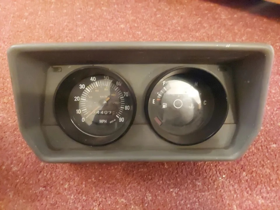

Strangely, you've just rekindled memories of being driven around by Dad, in one of his old Minis - it was always fun when the needle was pointing straight downwards! :) (there are some steep hills in Cornwall!).
