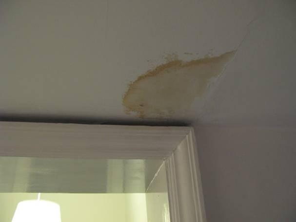

I have a leak at one upper corner of small dormer window (very easy access). Window is about 3 feet by 2 feet, if that big

thanks for the suggestion - you're quite right - an image would help. This is the best I can manage I'm afraid ..
sadly. sorry, not easy as I'm currently living in a different country.

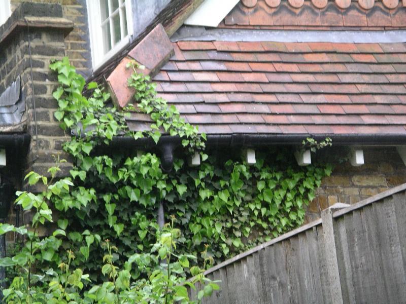

all I have is this piccie sent by tenant of the damage , which is prob completely useless... and one of our neighbours' matching dormer (taken for different reasons). The two dormers face each other over a roof valley with tiny gully and parapet wall. You can see the parapet wall in the picture. Fraid I'm an absentee landlord now, living in the Netherlands.
Hi. Is the roof to the dormer flat? As i cant understand what the quotes relate to.
Thanks for your patience!
yes, the roof of the dormer is flat - it is very small, about 6-to 8 sq feet I would guess
(I'm a girl. I'm pretty poor at guessing measurements :) These facts may or may not be related ).
As you can (almost) see, the dormer window is 3x2 "georgian" panes and the dormer is little larger than the window itself. It isn't part of a room, it just gives light to a little landing above a linen cupboard.
