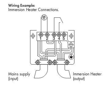

There you go
or it could need a separate L.
Am I missing your meaning?
Something - if not my meaning.
Here is the diagram which comes with an immersion timer which is described as having volt free contacts - which it does.
However it comes with the link pre-installed and shows the live to be connected to the volt free.

There you go ... or it could need a separate L.
... or (as above) not necessarily even an 'L' (in the sense of one side of a supply) at all.
Something - if not my meaning. ... Here is the diagram which comes with an immersion timer which is described as having volt free contacts - which it does. However it comes with the link pre-installed and shows the live to be connected to the volt free.
Oh dear - just when I thought we were agreeing, I think this may be getting worse! All contacts, in anything, are obviously 'volt free' until something is connected to them. However, if the piece of equipment comes with a link from L to one of them pre-installed, then I again think that one has to be very careful bringing the 'volt free' phrase anywhere near it. Yes, it can be converted to 'volt free' by removing the link - but, as supplied, I would have said that it is no different from a non-volt free (what's the word for that - "volted"? :) ) unit. I fear we may be heading for a semantic discussion as to whether its the contacts or the terminsla that are 'volt free'!
