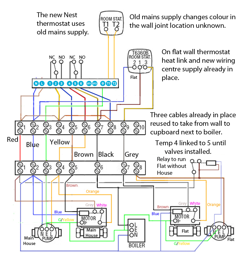

And yes I agree labelling is important as is a as built wiring diagram, I drew mine C_Plan_My_HouseD-relay.jpg showing all the wiring centres etc, but there was nothing I found left when mothers house had a boiler change, or when house re-wired, yes a schedule of test results which said which MCB/RCBO feed what, but in spite of agreeing all sockets to come from a ring final so they could be added to later, that was not the case, I found two unfused spurs and one dead socket.
However the fact that tradesmen don't label or make as built plans does not mean the central heating should not use a different supply for boiler, heat link, router, hub, thermostat and mobile phone all which in some way control the heating. It is very common for the thermostat to have a different supply to heat link. Yes you can take a 12 volt supply from heat link to thermostat with Nest, however it can also be completely independent using a USB power supply or 12 volt power supply both which are in turn supplied from some handy socket, which is unlikely to be supplied from the same RCBO/MCB as the boiler.
