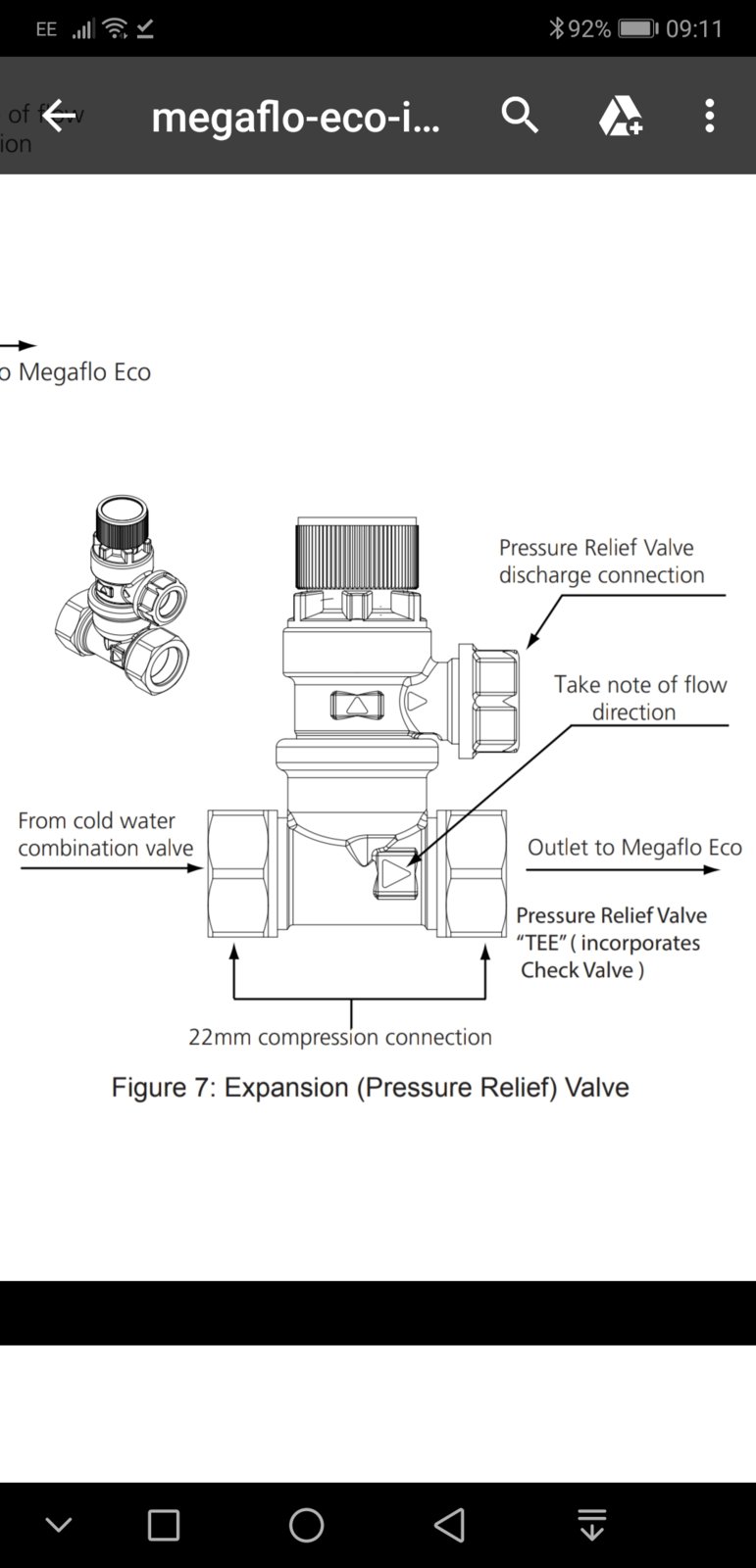

There should be a pressure relief valve (with built in check valve) as per the diagram after the balanced cold supply. This ensures no hot water expands back into the cold pipe supplying the house.
As above. Check that the > is correctly oriented. See this page of the manual...

Just spoke to Heatrae Sadia tech support. They said that when the stopcock was turned off and hot water drained down it probably re-charged the air gap in the Megaflo and so the tank pressure has now increased a bit. They way my system was installed 15 years ago with the Combination Valve before the tee to the tank inlet and balanced cold would mean that I will get the backflow of expanded water to the bathroom cold taps when the water in the tank is hot and a cold tap is opened. This is not a problem as long as the backflowing water doesn't come out of the cold tap too hot. This inconvenience may subside over time, or even come and go.
He confirmed that the cure, should we want to, is to use the current installation procedure and split the combination valve so that it is as per the diagram in the link I put on the thread a few posts previously. That is, have the 3 bar reducing valve and check valve before the tee to the tank inlet and balanced cold and the 8 bar PRV and another check valve between the tank inlet and the tee piece with the PRV nearest to the tank of course. Same conclusion as we arrived at yesterday but not absolutely necessary unless the backflow is more than an inconvenience.
Just opened my stopcock to the two turns that gives me the correct flow from the utility taps as it didn't seem to make a difference to the backflow wherever it's set and I'll just leave things alone now I think.
There was never a fault in the first place it seems and things were just working as they're meant to. A questionable original installation design (I think) that's now been superseded by a new way of installing things. A great learning curve for me though and as usual you've all been most helpful.
