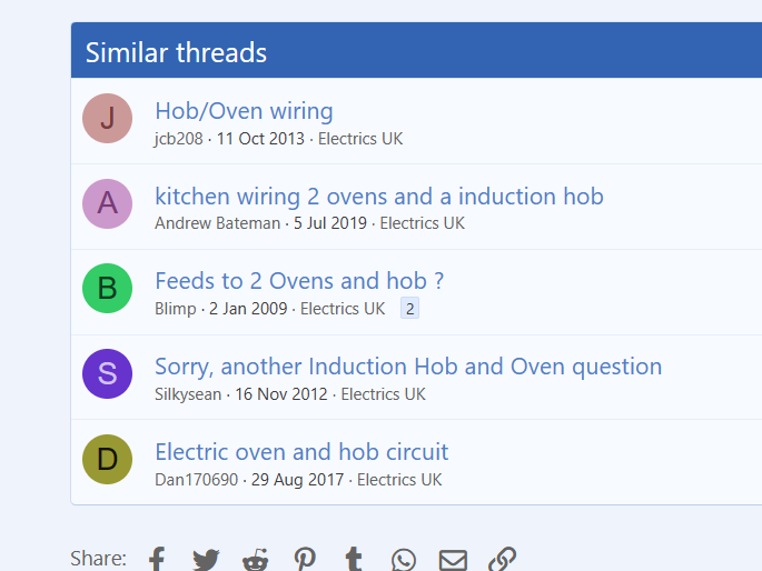

I happened to click on the centre title thinking it was the current thread
This from 2009 was right in the middle of the screen:
