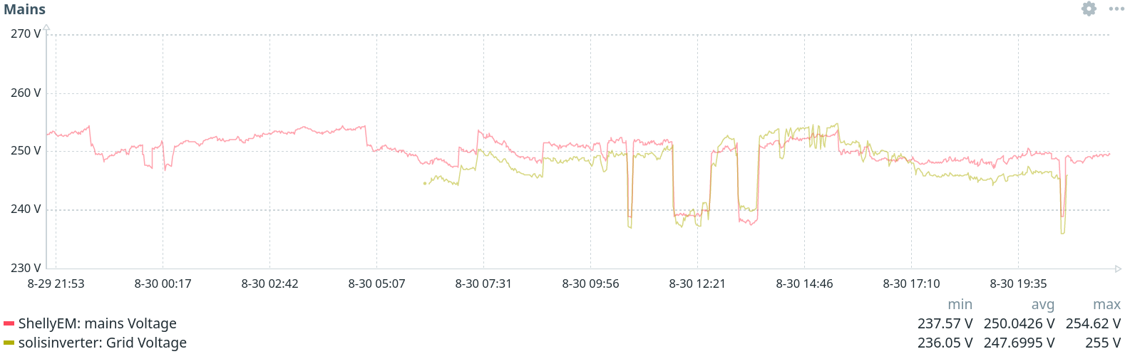

I often see 253 late at night. We’re about 350m from the transformer, and looped from next door. Often see dips to 230, it’s noticeable in the summer with a fan on as you hear the pitch change.
I’ll get some pics of my cheapo plug in meter.
Varies throughout the day. I reckon the Solis inverter is more likely to be accurate than my Shelly EM, but the inverter is only on when the sun is shining.
Interesting. The dips to 230V are not surprising if you're that far from the transformer, but if you often get 253V athat far from the transformer, one would expect those close to the transformer to be getting well over 253V (the theoretical 'maximum')

Yes, agreed. I suspect that the highs are due to being relatively densely populated area and the lows are when next door run something high power at a peak time (i.e. large drop across our shared cable when the voltage is already low).
I will get pictures to demonstrate.
