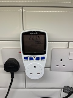

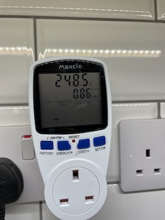

Didn't stay up too late last night so could only get the following at 21:30:
Here is an example of a "sag" at 19:45, with a low load of 150w from my installation:

All agreed @JohnW2. I did say in my original post that I was looped from next door and I was suggesting that the “lows” that I see might be due to next door using heavy loads.
Out of interest, do people agree that the 20+ volt difference I see throughout the day is somewhat unusual?

That will obviously be a factor. Do you know roughly how long the shared cable between you (and your neighbour) and the DNO's main is? One might expect that it would be fairly short, in which case your voltage drop due to the neighbour's loads might well fade into insignificance in comparison with VDs due to loads in the (possibly many) installations connected to the transformer through one main cable. Do you know roughly how many installations w're talking about?
I personally can';t recall having seen swings that large, but I'm not sure that I've seen (m)any installations 350m from a transformer. I'm probably less than 100m from transformer, and, as I've said, have been known to see swings around 10 V (~240 - ~250), so it wouldn't surprise me if customers another 250m downstream (if any exists) saw much larger swings than I do.
I suppose it's in the DNO's interests to try to design their networks so as to maximise usage of the 'permitted range' (216.2 V - 253 V) - and that's 36.8 V wide.
