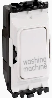

Also traditionally the washing machine would has a switch local to it, so it can be switched off without touching the washing machine. Grid switches like this 1712998090635.png often together with freezer etc, were common practice, in the main as washing machine weights have been known to come loose, and the machine could wreck a kitchen, where one can't get near it to turn it off, today washing machines tend to have a built in sensor so if the load is not even distributed it will auto switch off, so there is no longer the same NEED to fit one, however still common to fit them to supply any socket outlet hidden behind equipment so equipment can be isolated without pulling it out first.

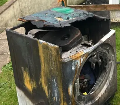

However I digress, the point is power used, and so with a drier we have three common power use, 600 watt heat pump, and 1000 or 2000 watt with resistive, at 1000 watt no problem really, but although my drier had the option 1000 watt or 2000 watt, my washer/drier has no such option, you get what you get, and to be frank the washer/drier seems to get very hot, not sure it does the clothes much good. (I have a washing machine and heat pump tumble drier in centre floor, and washer drier in the lower floor so have both) I will happily leave the heat pump drier running unattended, but not the washer/drier too many pictures like this 1713000718965.png which I assume is a washer/drier as it looks like a concrete weight on the top, and stand alone driers don't have weights.
