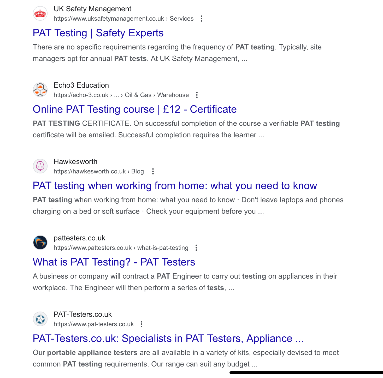

A Pat testing company will insist on Pat testing everything at four quid a pop. Many of those things do not require testing though as they either do not come under the heading of portable or they are double insulated.
PAT Testing ? Portable Appliance Testing Testing?
Yep. Pat testing.
Well just because lots of people refer to it as PAT Testing does not make it tge correct term to use, does it?
