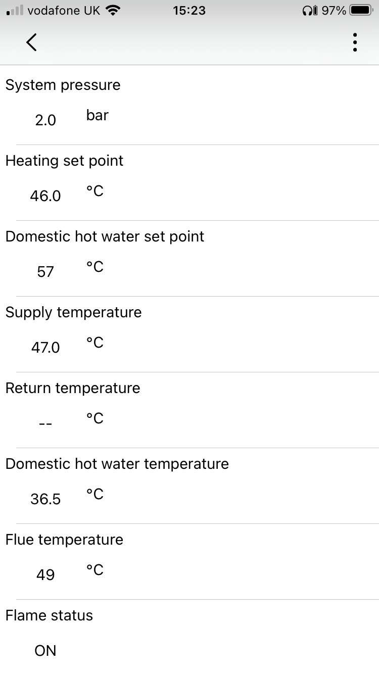

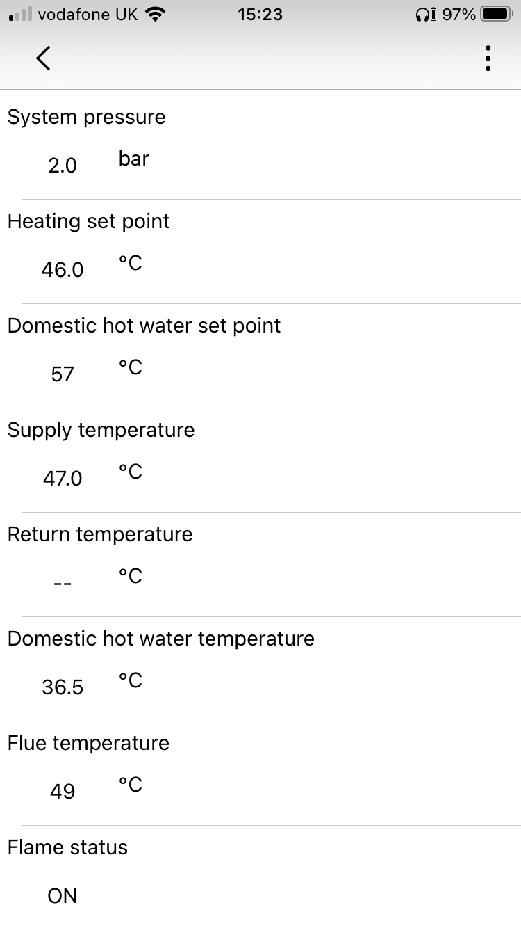

I find however most installed radiators are very often oversized and a curve of 1.4 re even 1.2 can be used. I'm currently experimenting with a curve of 1.0 (different brand of boiler graph) but it's only 9 degrees today so time will tell and I have one room particularly difficult to get heat to circulate so probably will need to adjust up again.

Your rads temp of 49C + 9c ambient = rad output of 35% would possibly suggest that your rads are oversized by a factor of ~ 1.26.
((20-9)/(20--5) / 35 X 100.
most are oversized by more than that but the main one in what we call the snug is in an exposed bay with a lot of single glazing and a ceiling lower than the rest of the room so the air doesn't circulate well. The room sensor is also therefore the whole property revolves around an imperfect room.

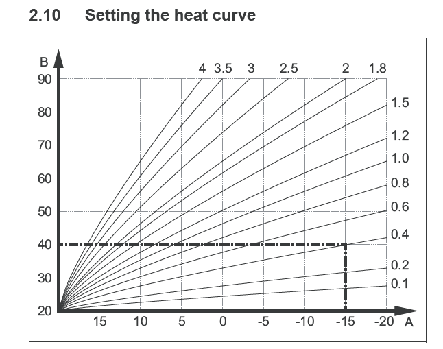

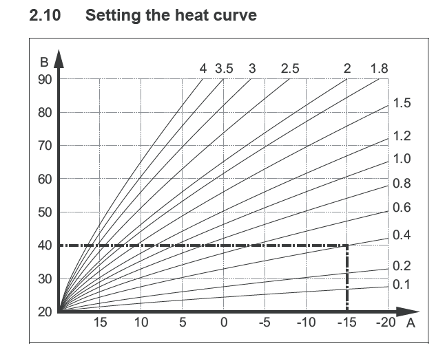

I’m actually using 0.8 in a 1960 home. At the moment it’s working ok. It’s always hitting tempreture. I find a low heating curv works better if your at home a lot, and hence you have a low set back set back tempreture. A low heating curb struggles heating quickly enough when you have been away and heating.
At my 0.8 At 10 degrees does 36-38 and 6 degrees is doing 40.

The curve above, 40C at 6C follows Curve 1 on the Vaillant? one above in post 22 which means that it looks for 53C at -5C ambient, this in turn means the rads are rated at 50% of their design output, so if you had say 20kw of installed radiators then you might range rate the boiler to 10kw, so if you need a quicker temperature boost by chaging to a higher curve then you also have to range rate the boiler to a higher output, no big deal I suppose as long as you remember it.
