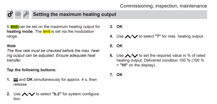

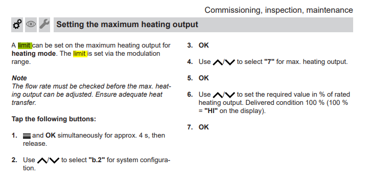

Hello,
Would range rating a modulating boiler serve to reduce start-up\operational noise?
I have a new 050-w 30KW Viessmann and one of the slight disappointments is that it makes more noise than the outgoing potterton 33 promax it replaced. To qualify, it's not making unusual noises, just seems to be a few db higher and of a different frequency than the old, and it's right under our bedroom. I think the ramp-up phase after a call for heat (Or a preheat cycle) is when it's loudest - then once it's in its stride and modulating down, it's all fine.
In a steady state it seems to like being about 40% modulation to give us 65 flow temps to retain 19C where we want it. So i'm wondering if that means i could experiment with range limiting which might reduce noise. Gotchas' i'm wondering about -
- Would Range limiting actually address the start-up phase noise ( could imagine that phase has it's own power preses)
- Would Range limiting affect DHW supply (call for DHW\shower usually requires 100% right?)
any tips\advice welcome. thanks

View attachment 329573All range rating is doing is lowering the gas flame hence limiting the amount of kWh that it using per hour. In most cases modulate down to as low as possible until the radiators are taking way too long to get up to temp. You may not be bothered about that if your heating is on most of day. The noise usually comes from pump pushing the water round your radiator. Some boilers may have a separate pump setting others the pump is set to auto where The pump speed is based on themodulate. In other cases you have to set the pump manually. Yet again the lower the better with pump. And you want to stop if you find the furthest radiators are not getting warm
Thanks - I had tried pump speed limiting option (75% max speed down from 100) which didn't seem to address noise i was hearing. I suppose i can just give range limiting a go and see if it causes any issues. My hunch is the noise that bugs me is the fan when at 100%. If this cycles down to match modulation then that would help.
I'm looking at giving weather comp a go - which would mean running boiler all night (i understand) so noise reducing given location would be helpful. I have a solid wall 3 bed semi with uninsulated suspended flooring - so it's pricey to heat currently
